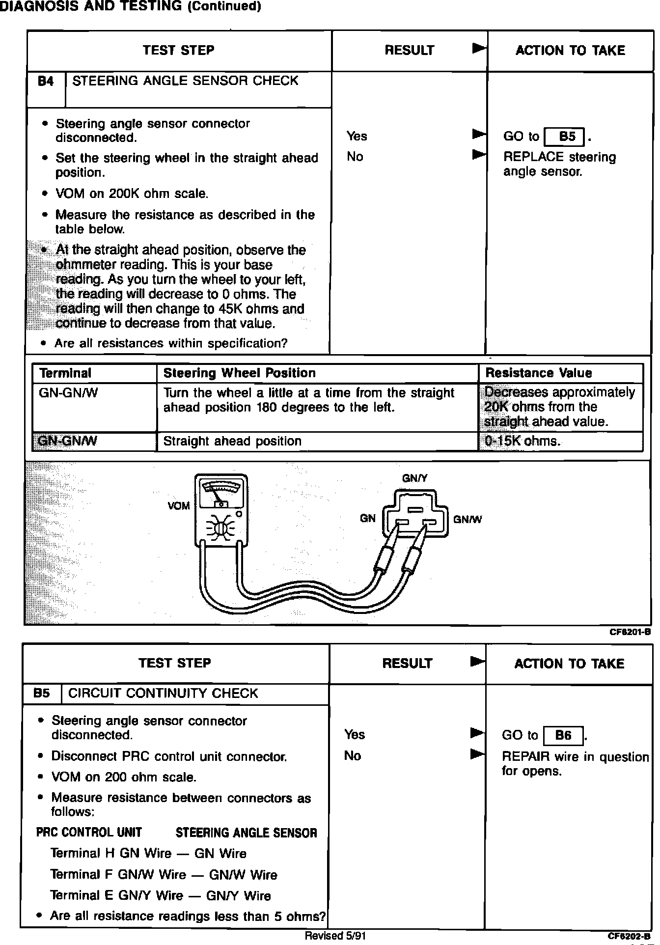

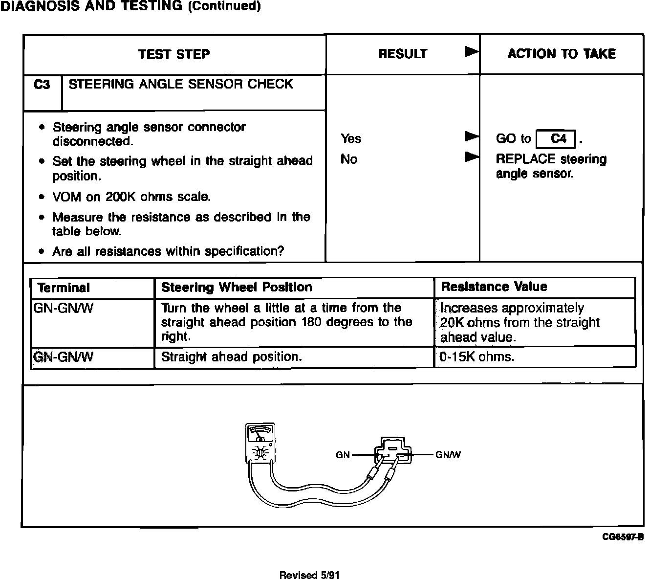

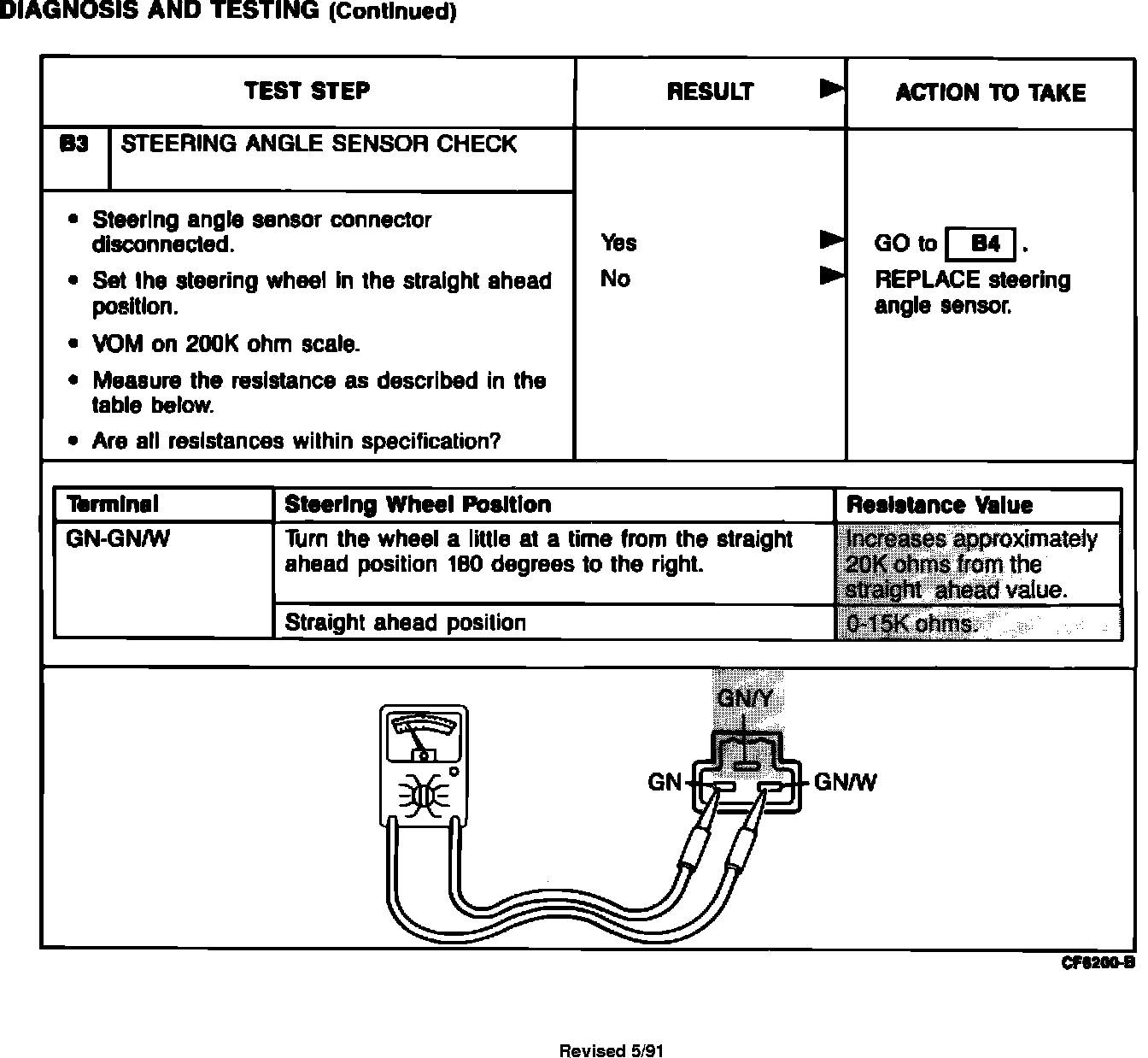

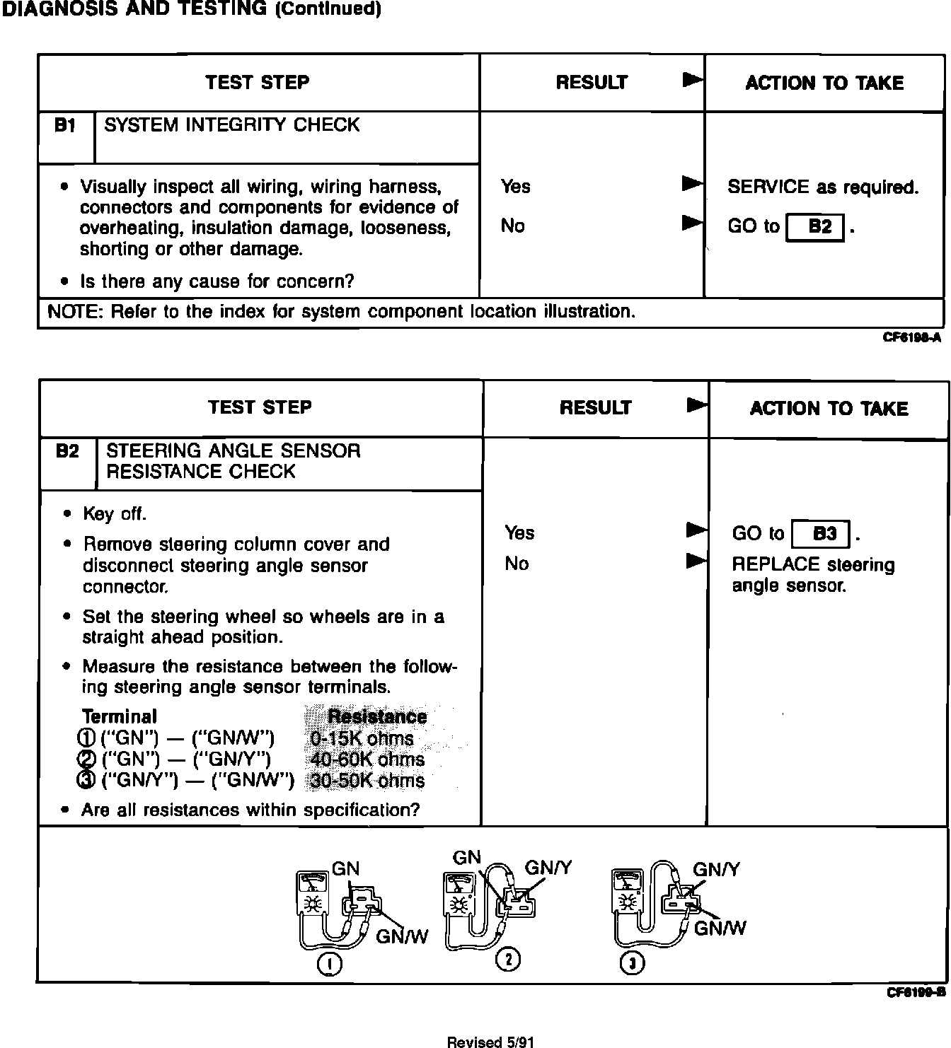

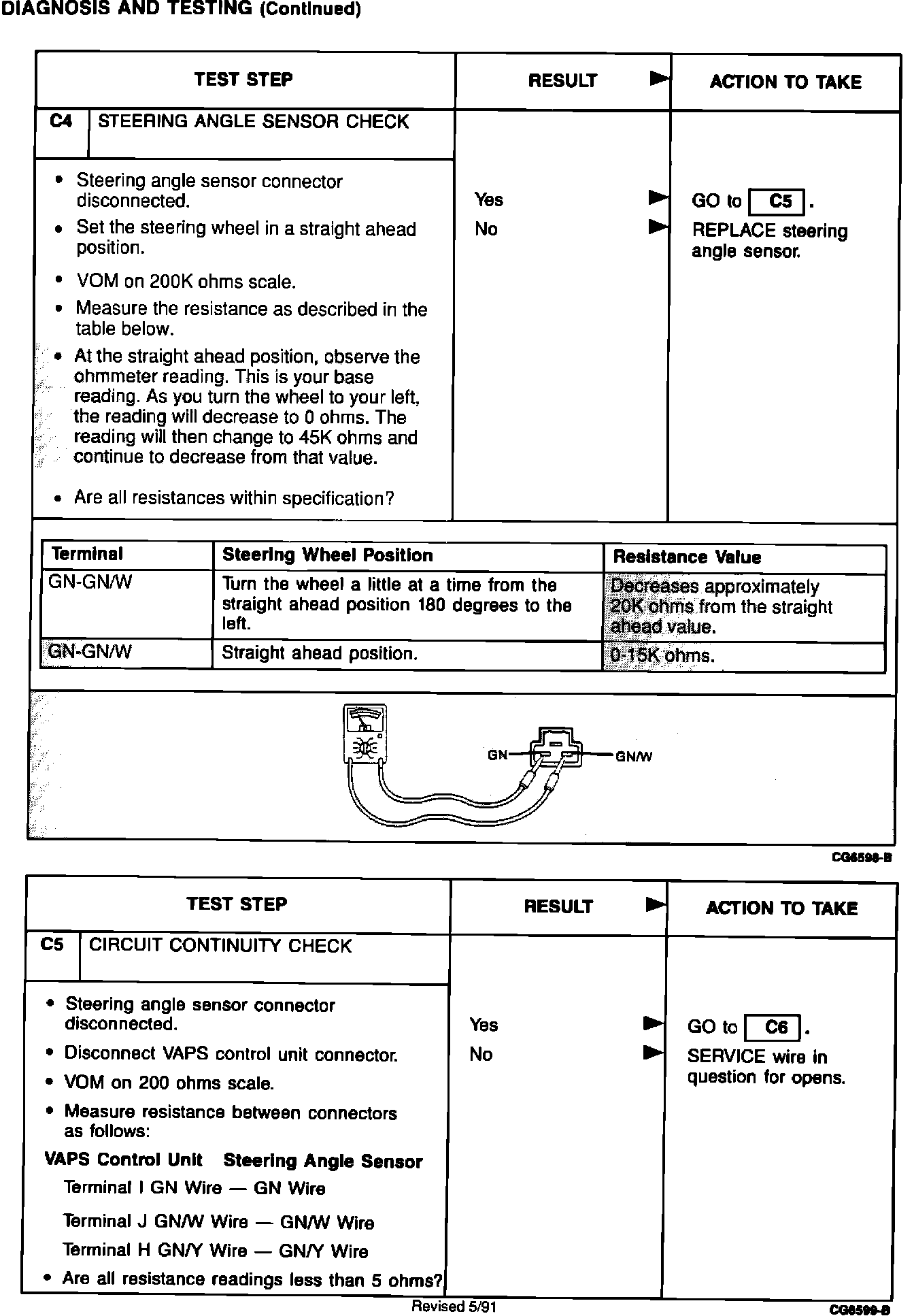

SHOP MANUAL - 1990 - PAGES 13-46-19 THROUGH 21 AND 14-39-16 THROUGH 18 - PINPOINT TEST PROCEDURES AND RESISTANCE VALUES REVISED
FORD:
1990 PROBE
ISSUE:
Electronic Steering and Programmed Ride Control Pinpoint Test procedures and resistance values have been revised on Pages 13-46-19 through 21 and 14-39-16 through 18 of the 1990 Probe Shop Manual.
ACTION:
Refer to the pages in this TSB article for the updated information.
