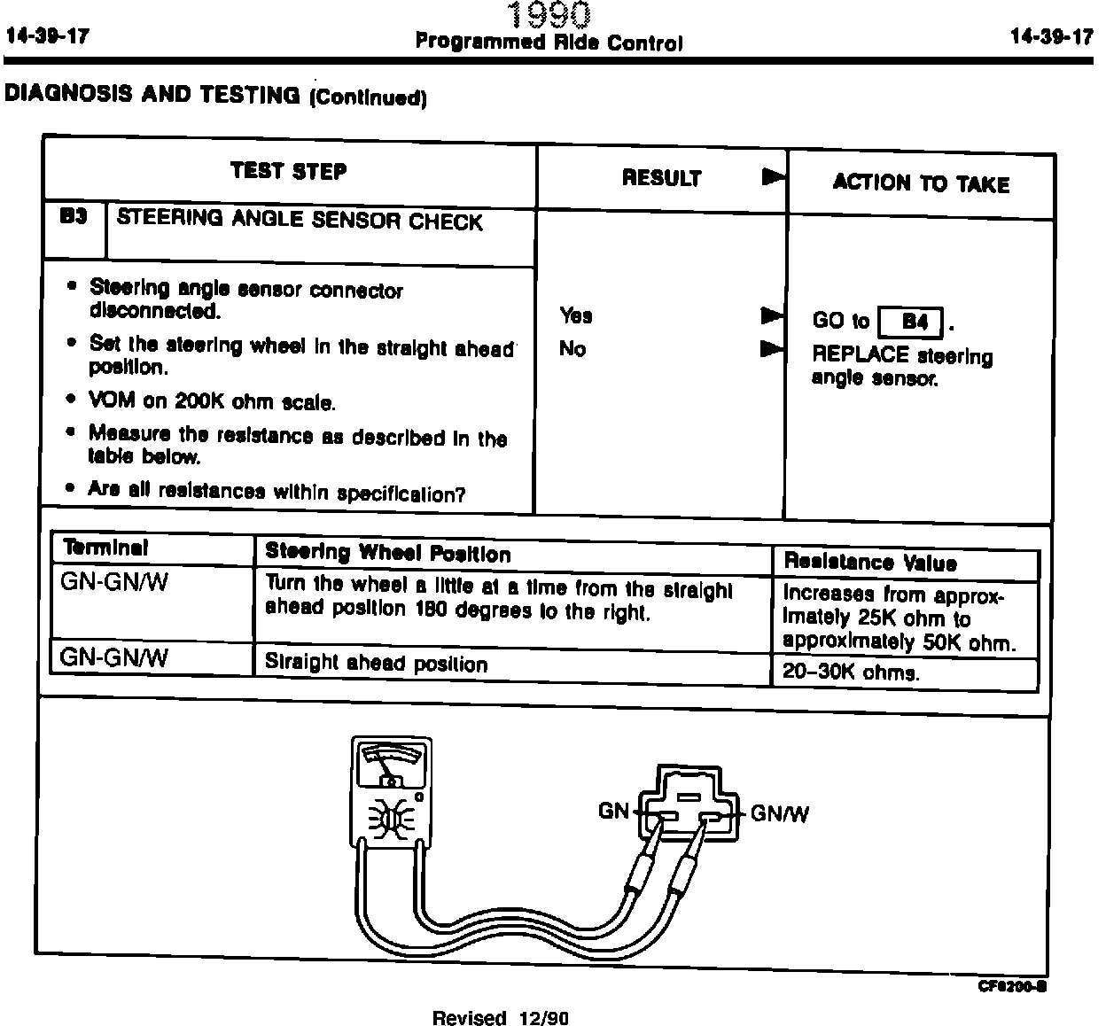

90ford44^ SHOP MANUAL - 1990 - PAGE 13-46-21 - POWER STEERING GEAR TEST STEP C4 REVISED
^ SHOP MANUAL - 1990 - PAGE 14-39-17 - PROGRAMMED RIDE CONTROL STEP B3 REVISED
Article No. 90-25B-18
FORD: 1990 PROBE
ISSUE: The resistance values in Test Step C4 Steering Angle Sensor Check on Page 13-46-21 of the 1990 Probe Shop Manual are incorrect for Terminal GN-GN/W. Test Step B3 Steering Angle Sensor Check on Page 14-39-17 of the 1990 Probe Shop Manual should indicate Terminal GN-GN/W for the Straight ahead position.
ACTION: Refer to the pages following this TSB article for the updated procedures.
