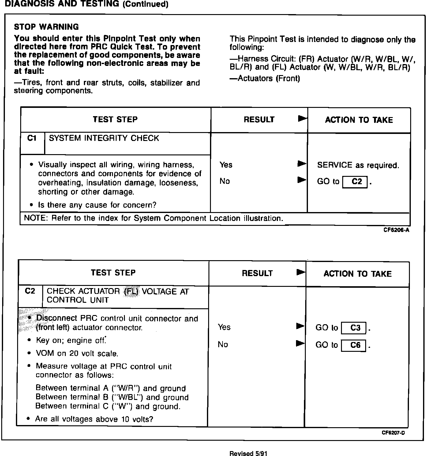

Programmed Ride Control Pinpoint Test Step C2 on Page 14-39-21 of the 1990 Probe Shop Manual requires rewording to clarify the procedural Test Steps which follow.
ACTION:
Refer to the page in this TSB article for the revised wording in Test Step C2.
