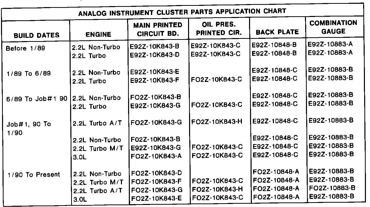

ISSUE: The oil pressure gauge and related parts required are not identified by production date changes in the current parts catalog and micro-fiche. Cars built from Job # 1, 1988 through the present have had changes to the following components:
^ Circuit board
^ Oil pressure circuit board
^ Back panel
^ Combination gauge
ACTION: If service is required, refer to the following Analog Instrument Cluster Parts Application Chart for correct parts usage.
