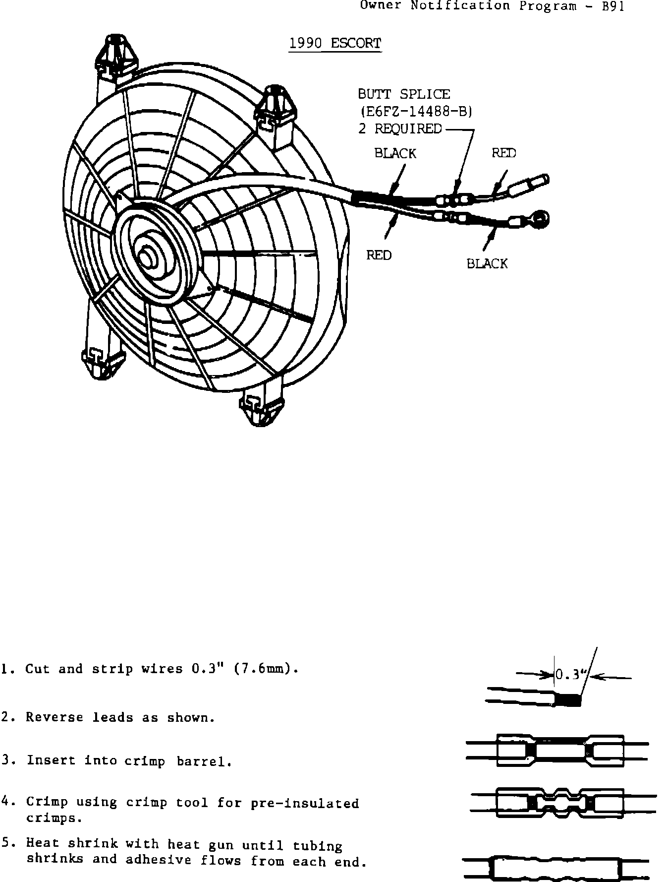

Exhibit 1.:
Escort
Refer to Exhibit 1. Modify the electrical wiring as shown.

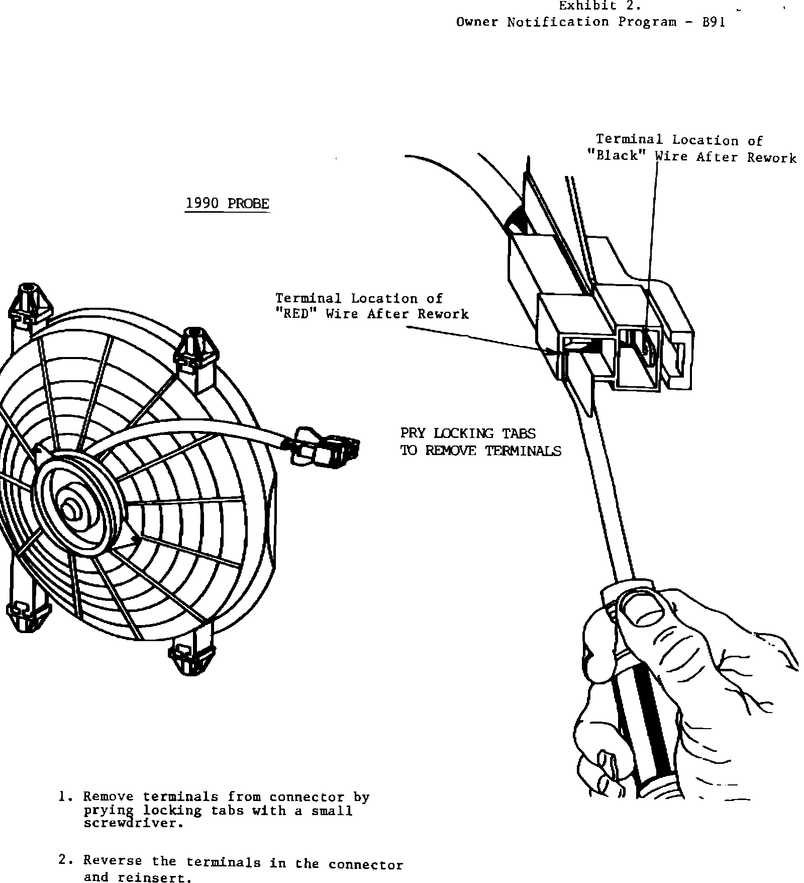

Exhibit 2.:
Probe
Refer to Exhibit 2. Reverse the electrical wiring terminals as shown.
