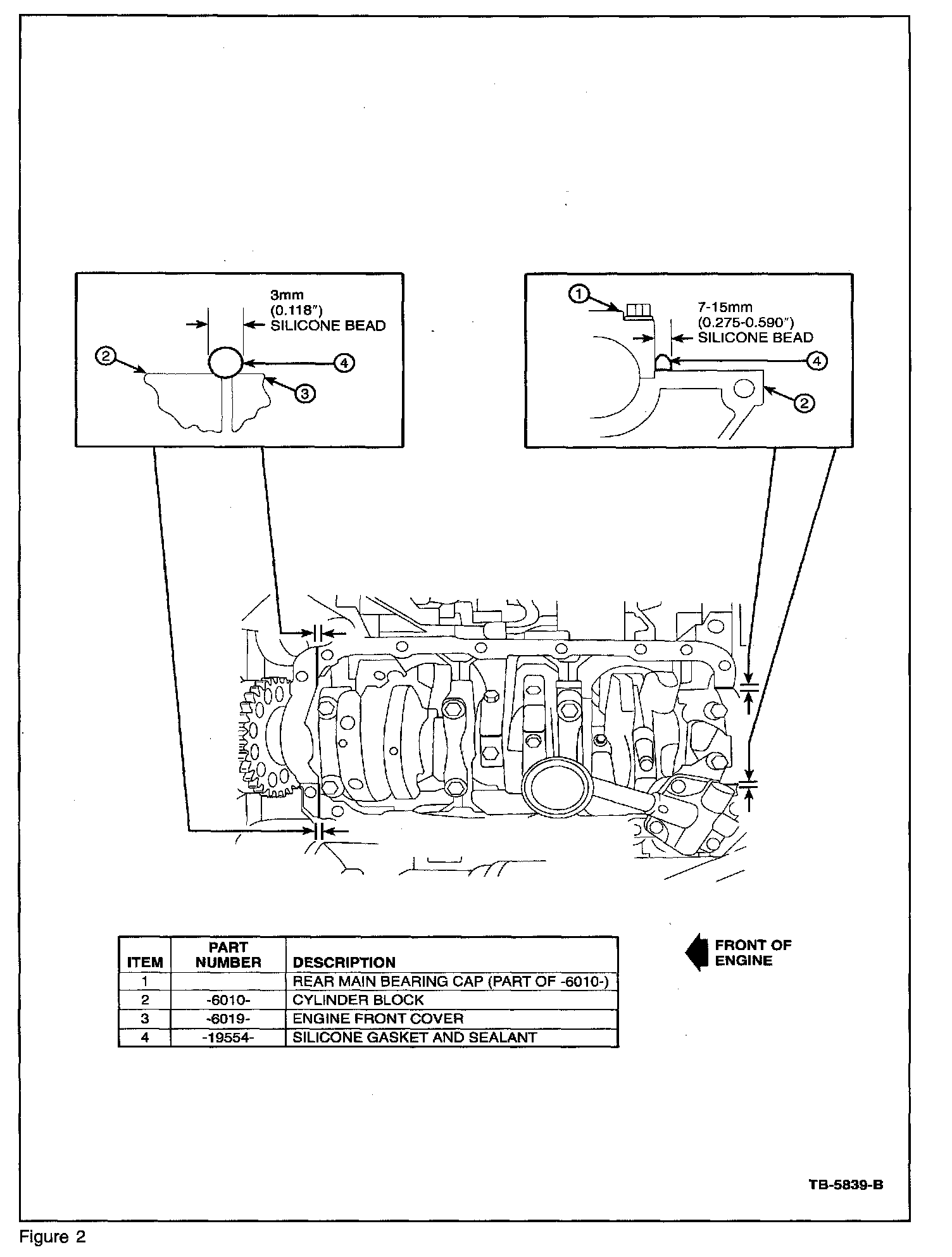

3. Apply beads of Silicone Gasket and Sealant (F7AZ-19554-EA), or equivalent meeting Ford specification (WSE-M4G323-A4) to the front cover and rear bearing cap-to-block parting lines (Figure 2).

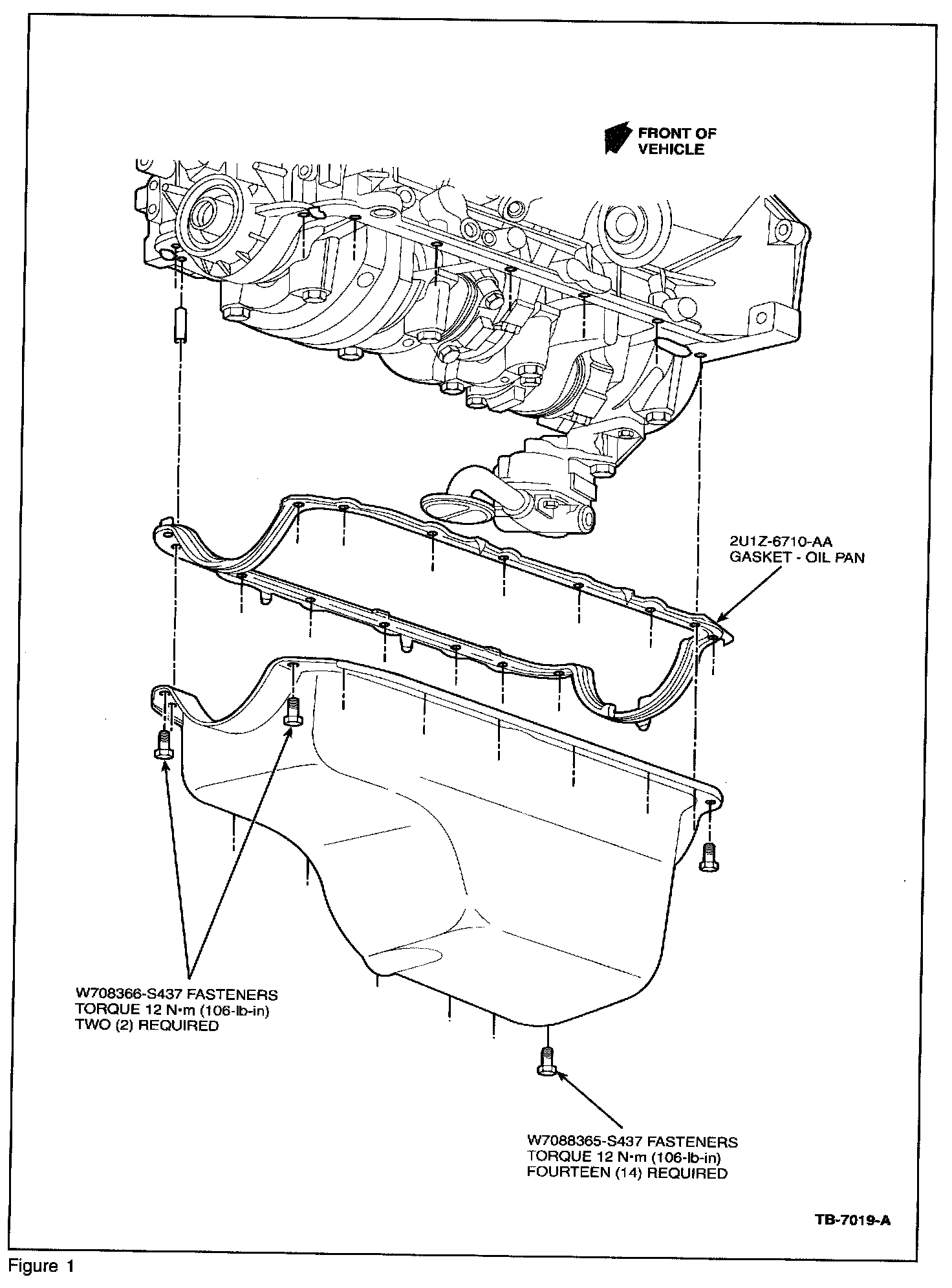

4. Install the gasket on the oil pan, being careful not to damage the plastic tabs.
5. Install the oil pan to the engine block with the new fastener (bolts) packaged in the service kit, run down all the bolts by hand (Figure 1).
NOTE
THE TWO CORNER BOLTS NEAR THE FRONT OF THE ENGINE ARE A DIFFERENT LENGTH.
6. Tighten the four (4) corner bolts first to 106 Lb-in (12 N.m).
7. Tighten the remaining fourteen (14) bolts from back to front (alternating from side to side) to 106 Lb-in (12 N.m). Figure 1.
