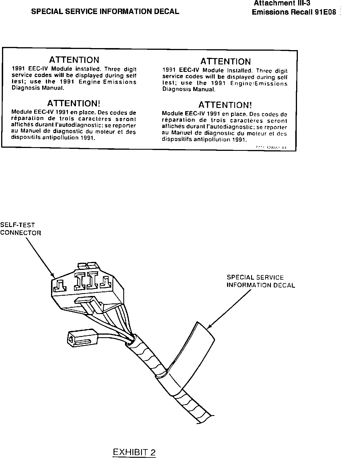

^ The preprinted Authorized Modifications and Special Service Information Decals shown are provided in the parts kit.
^ Refer to Exhibit 1. Clean the surface of the radiator support and attach the Authorized Modifications Decal to the support. Insert your P&A Code and date on the decal and apply the clear overlay over the decal.
^ Refer to Exhibit 2. Attach the Special Service Information Decal to the Self-Test Connector as shown.
