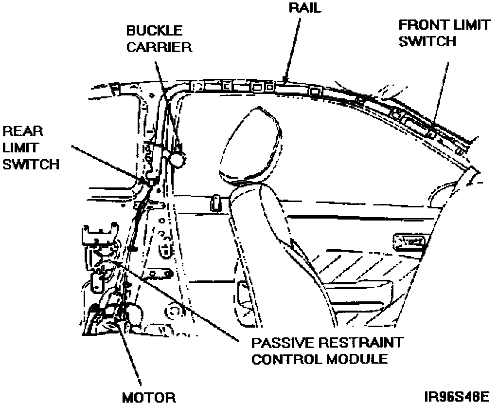

The following procedure is applicable for either left side (96S48), if necessary, rail replacement.This illustration shows a cutaway view of the left side rail and motor assembly. Right side rail and motor assembly symmetrically opposite.

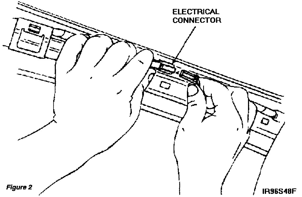

6. Disconnect the front limit electrical connector. See Figure 2.

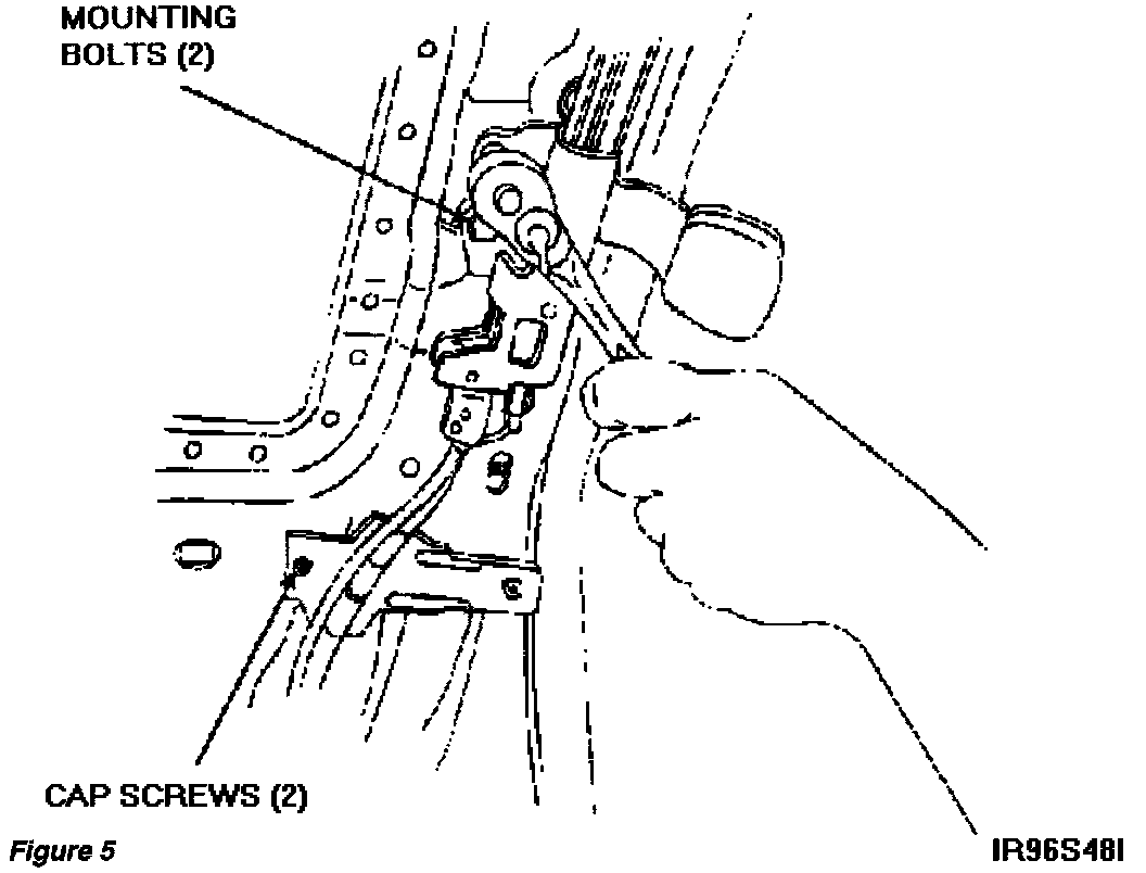

9. Remove the two (2) rail side mounting bolts. Refer to Figure 5.
10. Remove the two (2) cable retaining capscrews. See Figure 5.

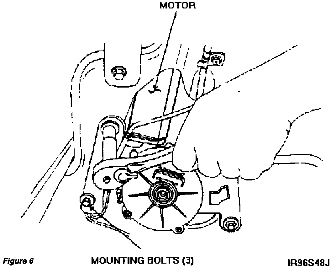

11. Remove the three (3) motor mounting bolts. See Figure 6.
