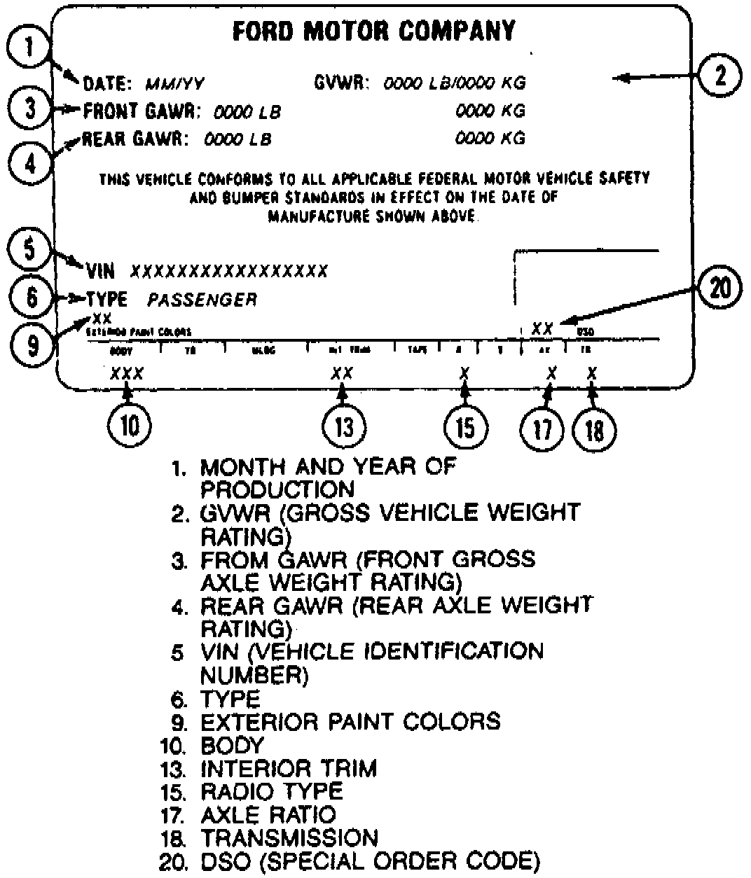

IDENTIFICATIONVehicle Certification Label:
All vehicles are equipped with a vehicle certification label affixed to the lefthand door jamb below the latch striker. Refer to the code below the space marked Trans. For additional information, such as model, service ID level, or build date, refer to the Transaxle Identification Tag. The transaxle identification tag is located on the transaxle case.
