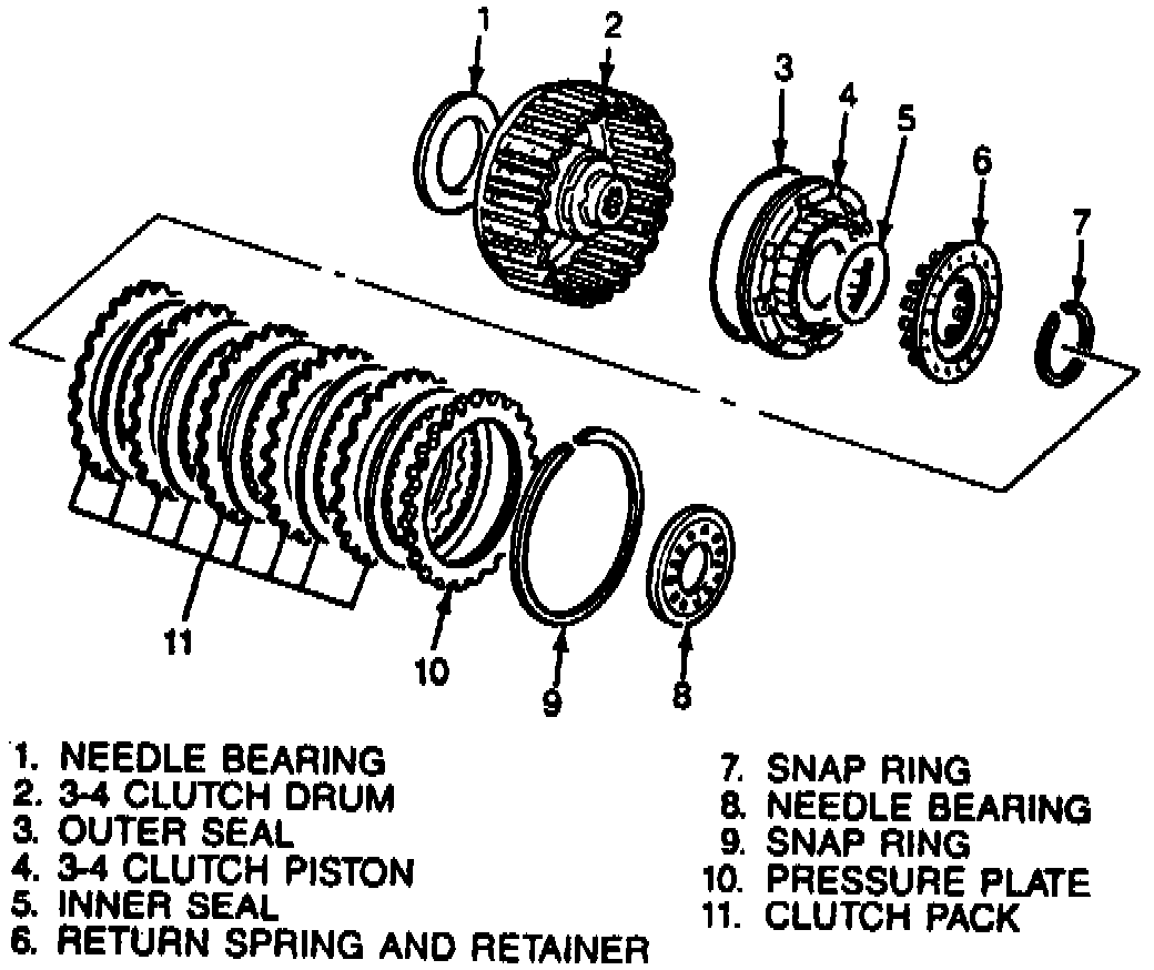

Exploded View Of 3-4 Clutch Assembly:
NOTE: Refer to the Exploded View Of 3-4 Clutch Assembly image for disassembly procedure, noting the following:
1. Using tool No. T65L-77516-A or equivalent, compress spring and retainer.
2. Remove snap ring, then the spring and retainer assembly.

ASSEMBLE
1. Apply a small amount of automatic transmission fluid to inner and outer seals before installation of 3-4 clutch piston.
2. Install piston by pushing evenly around circumference, ensuring not to damage seal rings.
3. Install spring and retainer assembly.
4. Compress spring and retainer using suitable tool No. T65L-77515-A or equivalent.
5. Install snap ring, then the dished plate with dished side upward.
Installing 3-4 Clutch Pack:
6. Install 3-4 clutch pack, then the retaining plate with step facing upward.
3-4 Clutch Pressure Plate Thickness Chart:
7. Measure clearance of snap ring and retaining plate of 3-4 clutch. clearance should be 0.051-0.059 inch. If clearance is not as specified, select a retaining plate, from the 3-4 Clutch Pressure Plate Thickness Chart, which will bring clearance to specification.
