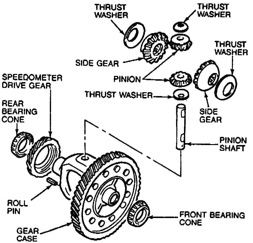

DISASSEMBLEExploded View Of Differential:
1. Disassemble differential as shown in the Exploded View Of Differential image.
