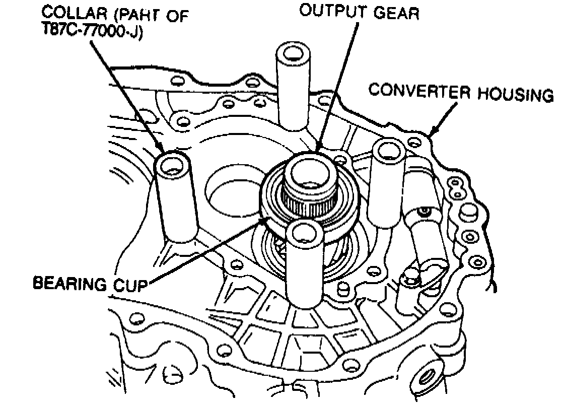

c. Place four collars, part T870-77000-J on converter housing at position shown in the Installing Collars On Converter Housing image.

d. Place shim selector gauge tool No. T88C-77000-C1 or equivalent, on output gear. The two halves of selector must be turned too eliminate any gap between them.
e. Place bearing housing on collars with washers, then install four screws T88C-77000-C with washers. Torque screws to 14-18 ft lbs.
f. Position torque adapter T880-77000-DH on output gear. Using pins provided T87C-77000-J, loosen gauge halves until all free play is removed and bearings are seated.
g. Measure drag on output gear bearing using an (in lb) torque wrench and torque adapter.
h. Turn gauge, using pins provided until a reading of 4.3-7.8 in lbs. is obtained on torque wrench.
Output Gear Shim Thickness Chart:
i. Use a feeler gauge to measure gap in between the two halves of gauge. Measure gap at four spots, 90° intervals. Select appropriate adjustment shim(s), as shown in the Output Gear Shim Thickness Chart. Select a shim that is close to measurement or slightly larger. No more than seven shims may be used.

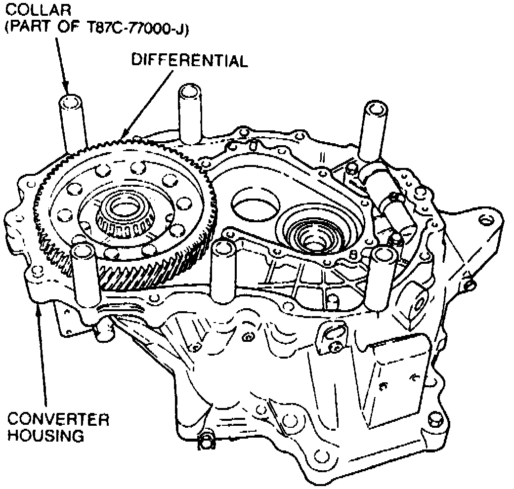

c. Install differential into converter housing.
Installing Collars On Converter Housing:
d. Place six collars, part of T87C-77000-J on converter housing at position shown in the Installing Collars On Converter Housing image.
e. Install rear bearing cup over differential bearing.

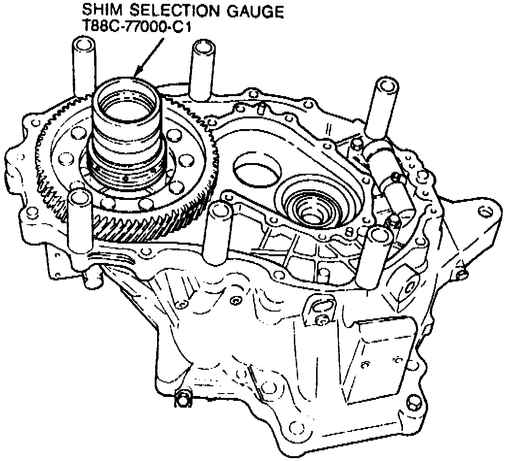

Shim Selection Gauge:
f. Place shim selector gauge T88C-77000-C1 or equivalent on output gear. The two halves of selector must be turned to eliminate any gap between them.
g. Place transaxle case on collars, then install six screws T88C-77000-C with washers. Torque screws to 27-38 ft lbs.
h. Unthread gauge tool, using pins provided, until all free play is removed and bearing cup is seated.
Measuring drag on differential bearing:
i. Engage differential rotator T88C-77000-L, then using an (in lb) torque wrench and adapter measure drag on differential bearing.
j. Turn gauge, using pins provided until a reading of 4.3 in lbs is obtained on torque wrench.
Differential Shim Thickness Chart:
k. Use a feeler gauge to measure gap in between the two halves of gauge. Measure gap at four spots, 90 degree intervals. Add 0.0079 inch to the largest measurement. Select a shim, from the Differential Shim Thickness Chart, that is close to measurement or slightly larger no more than three shims may used.

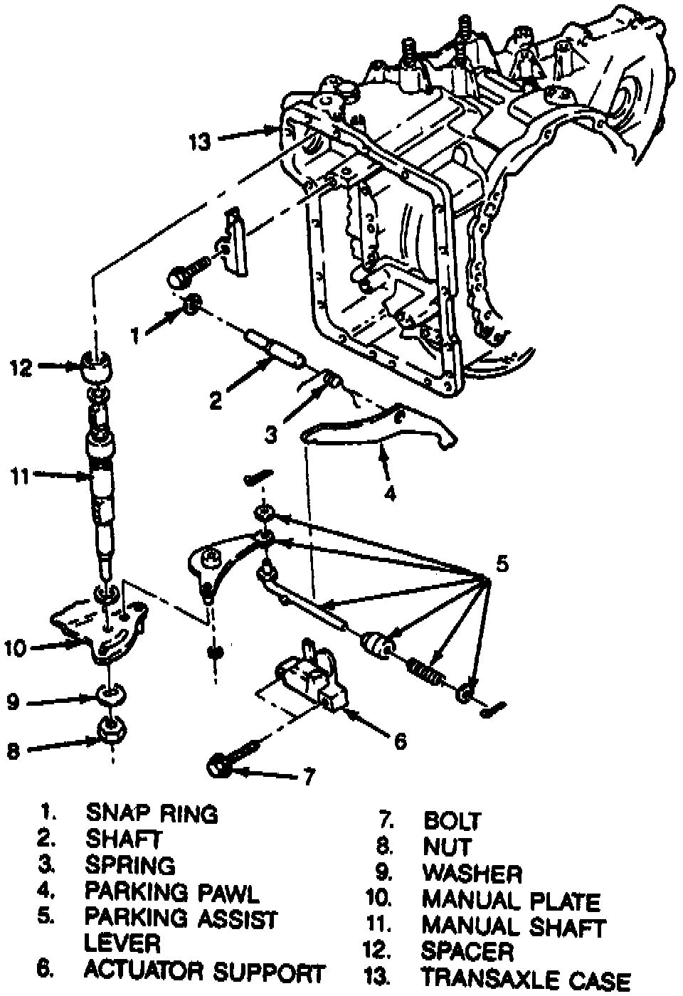

8. Install parking pawl and shaft, then the spring and snap ring.
9. Move manual shaft and check operation of parking pawl.
10. Install parking assist lever and snap ring, then the actuator support. Torque to 8-10 ft lbs.
Installing Manual Shaft Components:
11. Install manual plate, spacer, washer, and nut. Torque nut to 30-41 ft lbs.
12. Install manual shaft bracket. Torque to 7 ft lbs.
13. Install detent ball, spring, washer, and plug. Torque plug to -13 ft lbs.

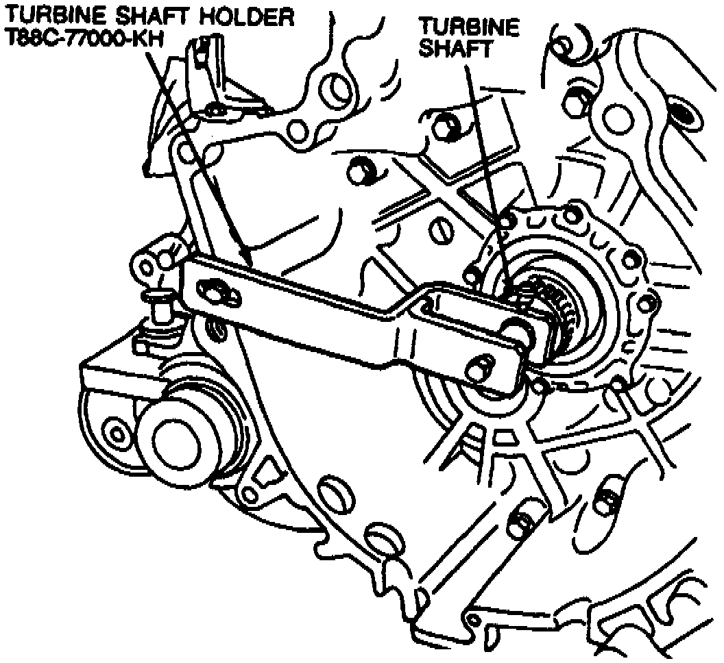

22. Adjust turbine shaft holder T88C-7700-KH or equivalent so it contacts and holds turbine shaft.
23. Install internal gear to 3-4 clutch drum and snap ring.
24. Install carrier hub assembly. Ensure thrust bearing and race are in correct position.
25. Hold turbine shaft with one hand to prevent shaft from rotating, then install carrier hub assembly into 3-4 clutch by rotating drum.

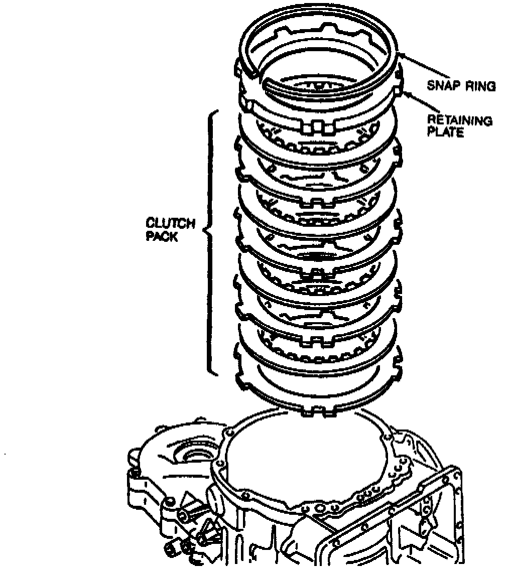

26. Install low and reverse clutch pack.
27. Install retaining plate and snap ring.
28. Check low and reverse brake clearance as follows:
Low And Reverse Clutch Pressure Thickness Chart:
a. Measure clearance of snap ring and low and reverse brake retaining plate. Clearance should be 0.083-0.0947 inch. If clearance is not as specified, select a retaining plate which will bring clearance to specification.
