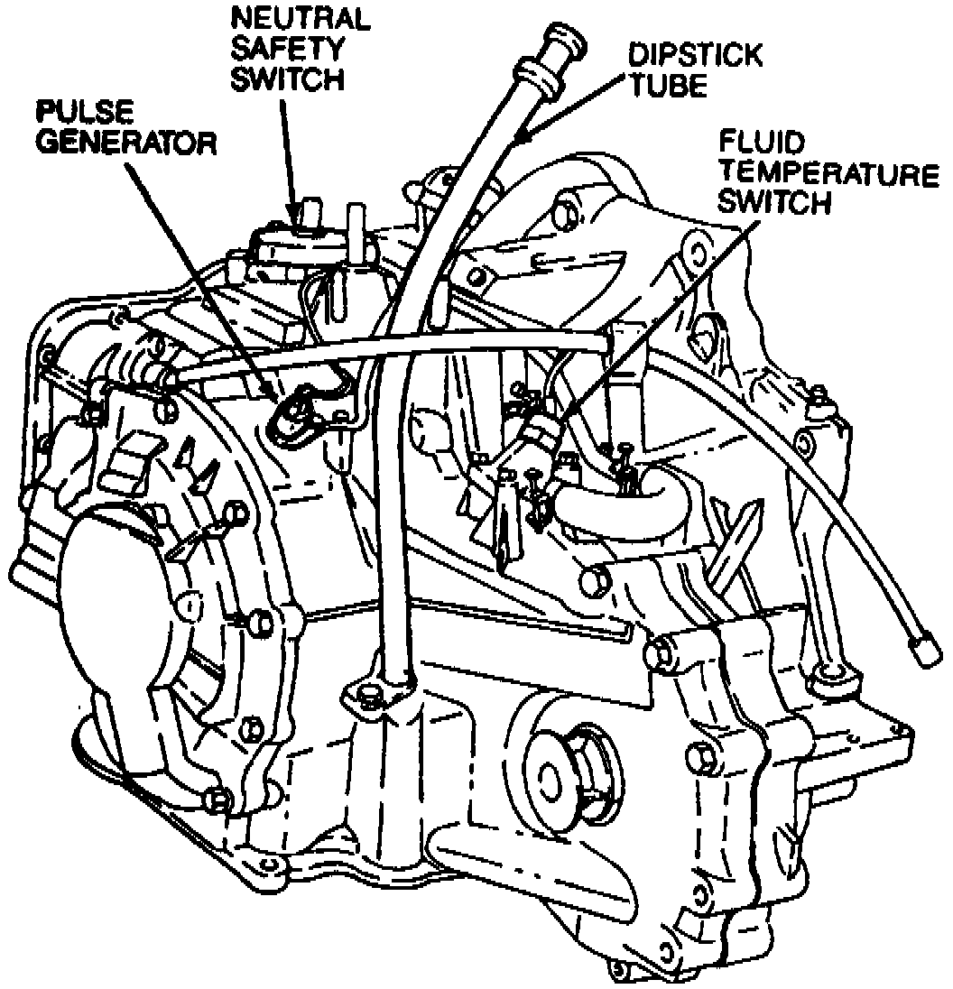

Removing Pulse Generator, Neutral Safety Switch, Dipstick Tube And Fluid Temperature Switch:
5. Remove pulse generator, fluid temperature switch, and neutral safety switch, as shown in the Removing Pulse Generator, Neutral Safety Switch, Dipstick Tube And Fluid Temperature Switch image.

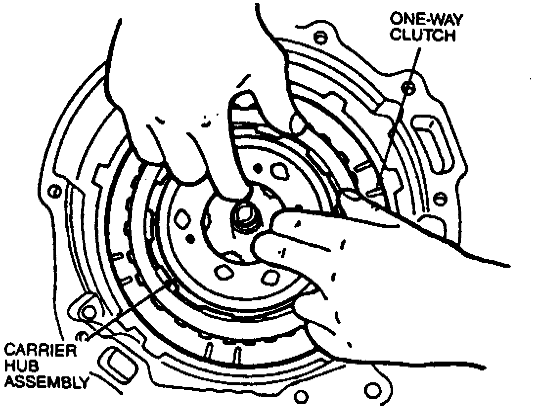

Removing One-way clutch & carrierRemoving One-Way Clutch And Carrier Assembly:
19. Remove snap ring, then the one-way clutch together with carrier hub assembly.
