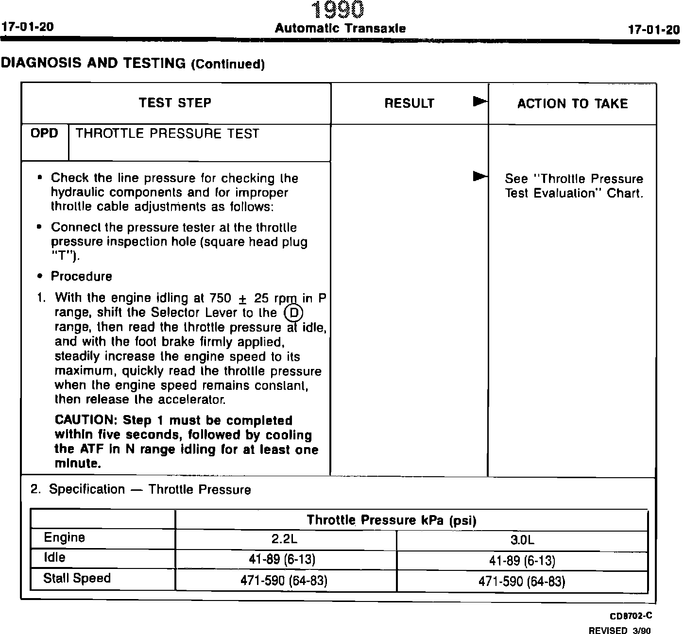

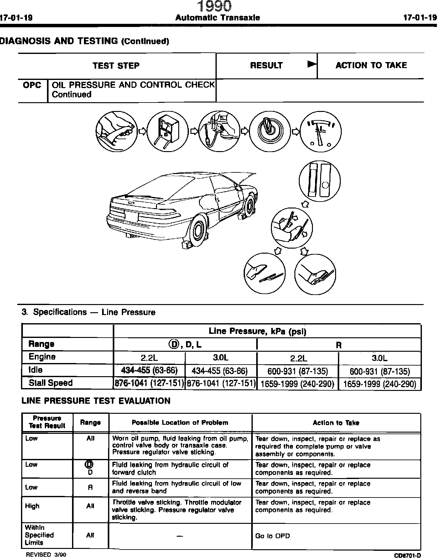

SHOP MANUAL - 1990 - PAGES 17-01-19 AND 17-01-20 - LINE PRESSURE AND THROTTLE PRESSURE
REVISION
Article No. 90-6B-38
FORD: 1990 PROBE
ISSUE: The transaxle line pressure and throttle pressure specifications have been revised. The affected pages are 17-01-19 and 17-01-20 of the 1990 Probe Shop Manual.
ACTION: Refer to the pages following this TSB article for the updated specification charts.
