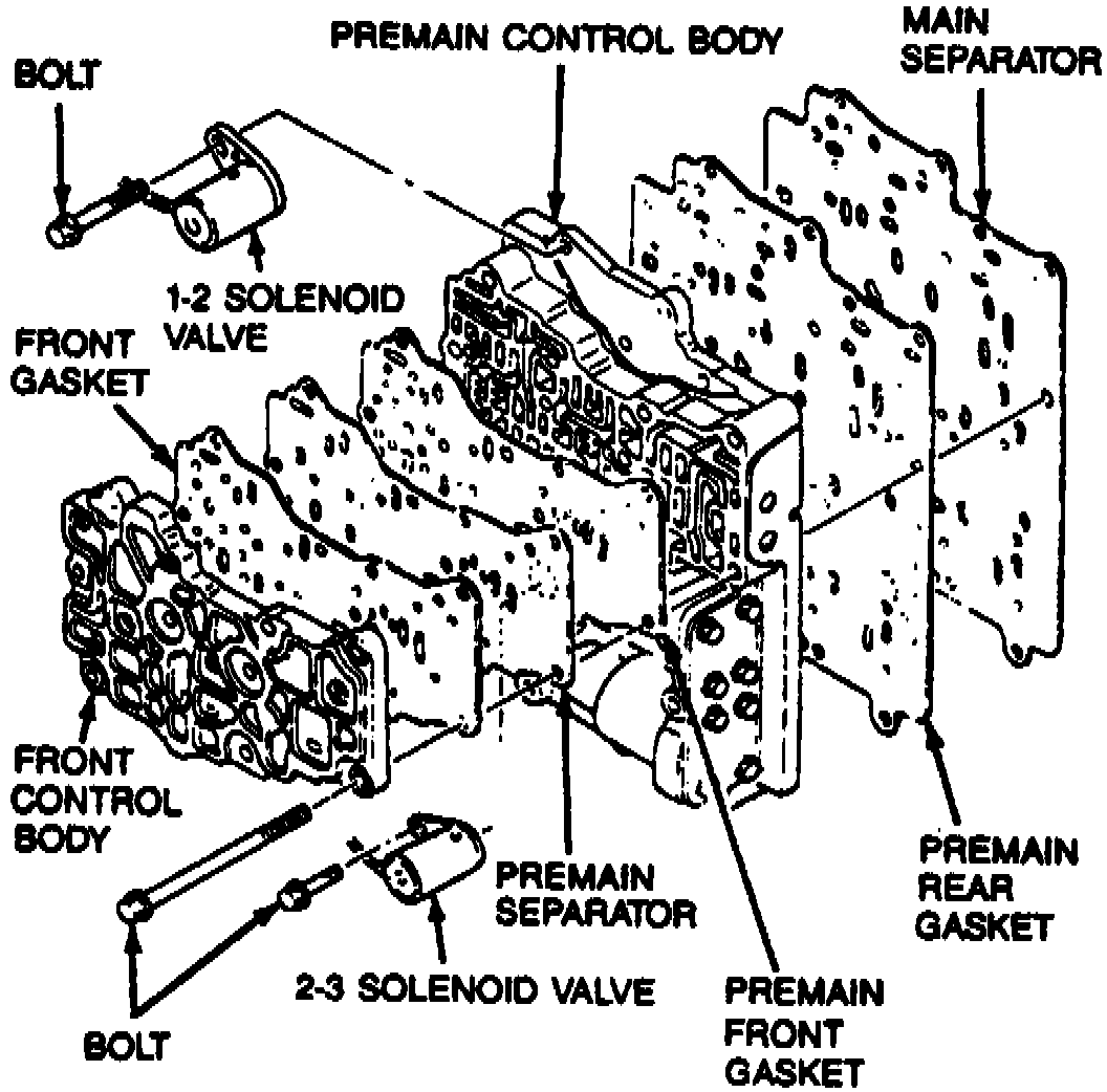

4. Remove front attaching bolts, then pull out front control body and premain separator as a unit.
5. Remove front premain gaskets and separator from control body.

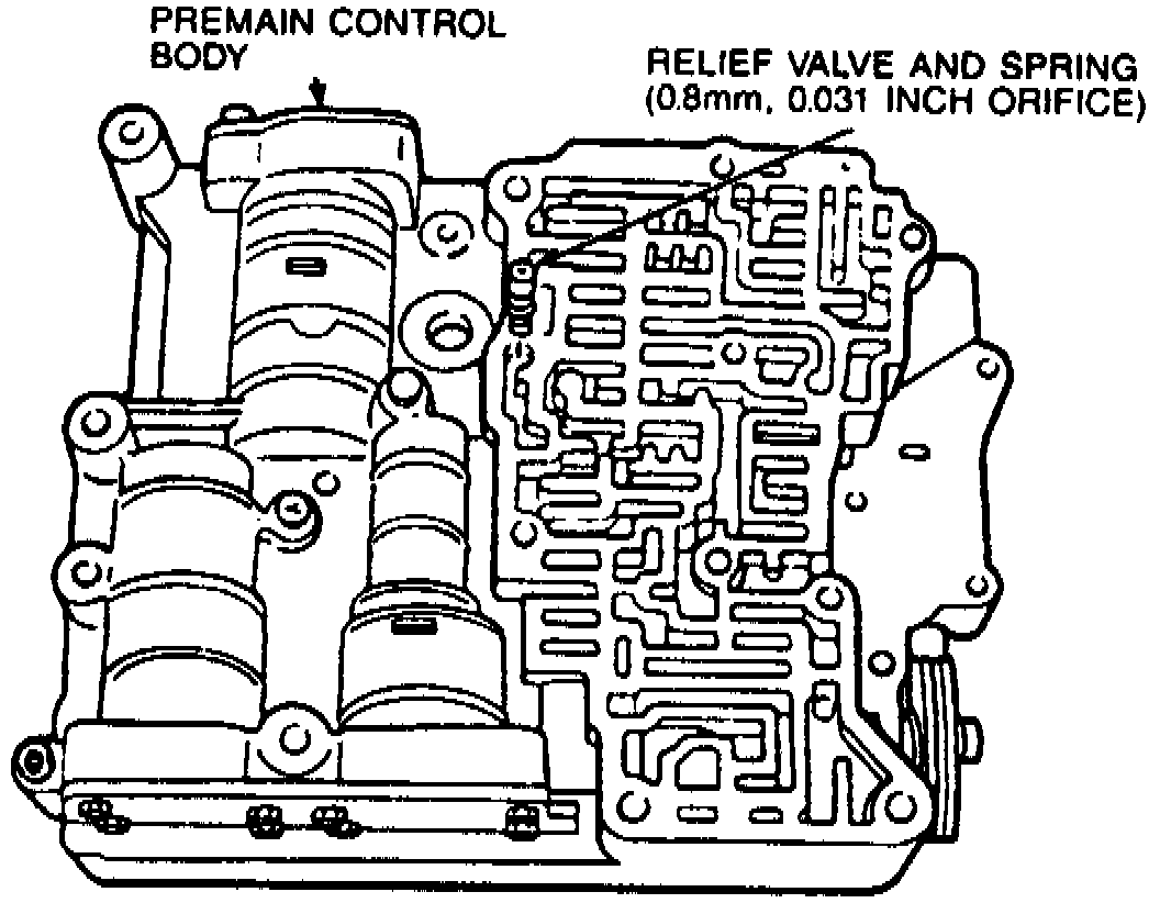

Relief Valves And Spring Location From Premain Control Body:
6. Remove orifice check valve and spring from premain control body.
7. Remove attaching bolts and hexagonal head bolt, then the premain control body and main separator as a unit.
8. Remove premain main gaskets and separator from premain control body.

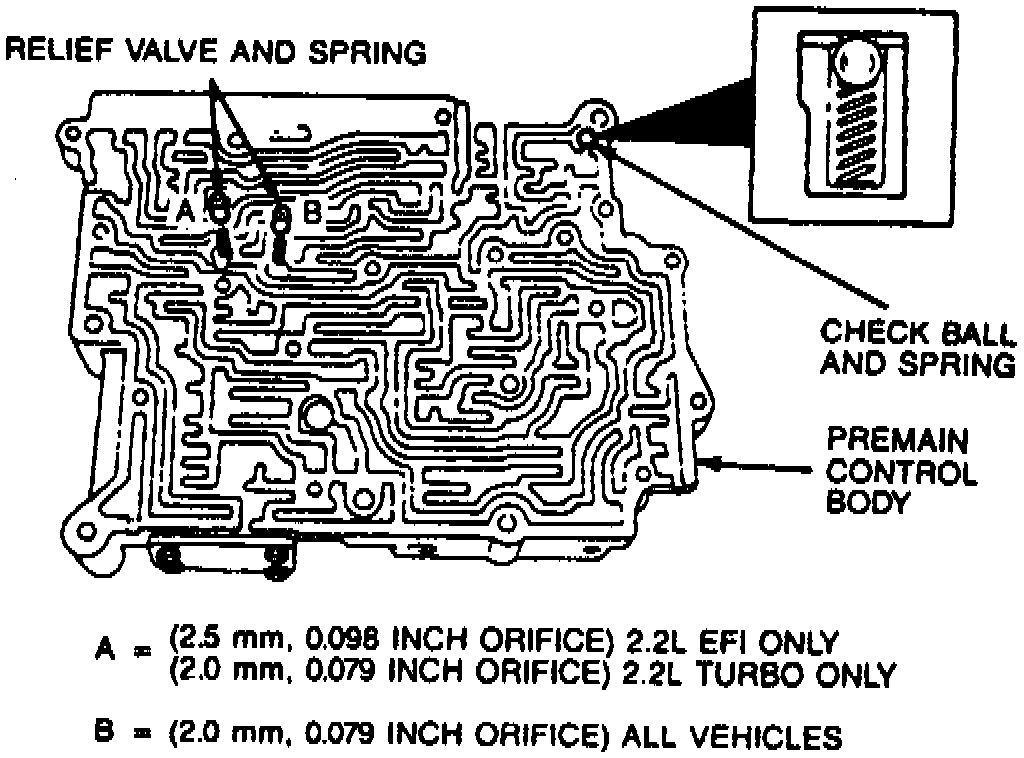

Relief Valve And Check Ball Location From Premain Control Body:
9. Remove orifice check valves, springs, throttle relief ball, and spring from premain control body.

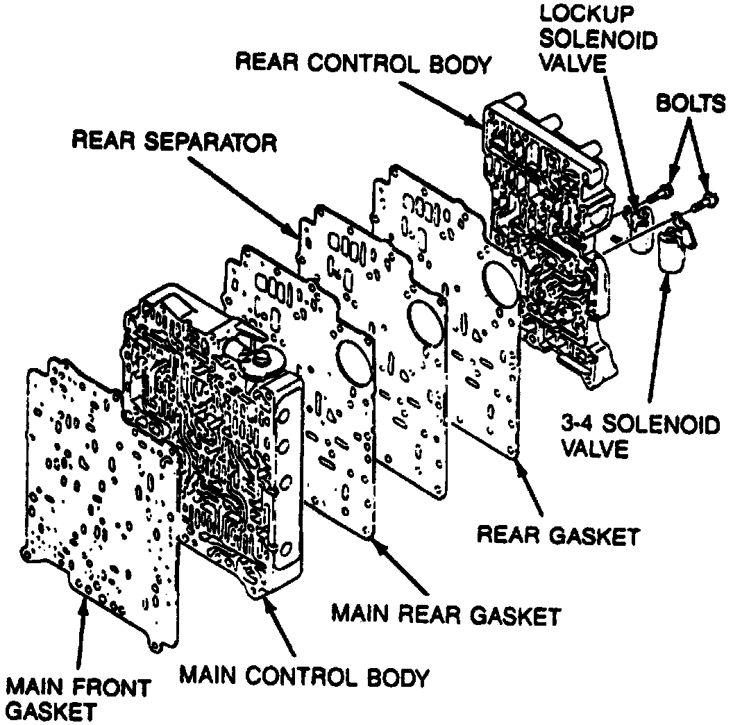

11. Turn assembly over and remove bolts, then the rear separator.
12. Remove main/rear gaskets and separator from rear control body.

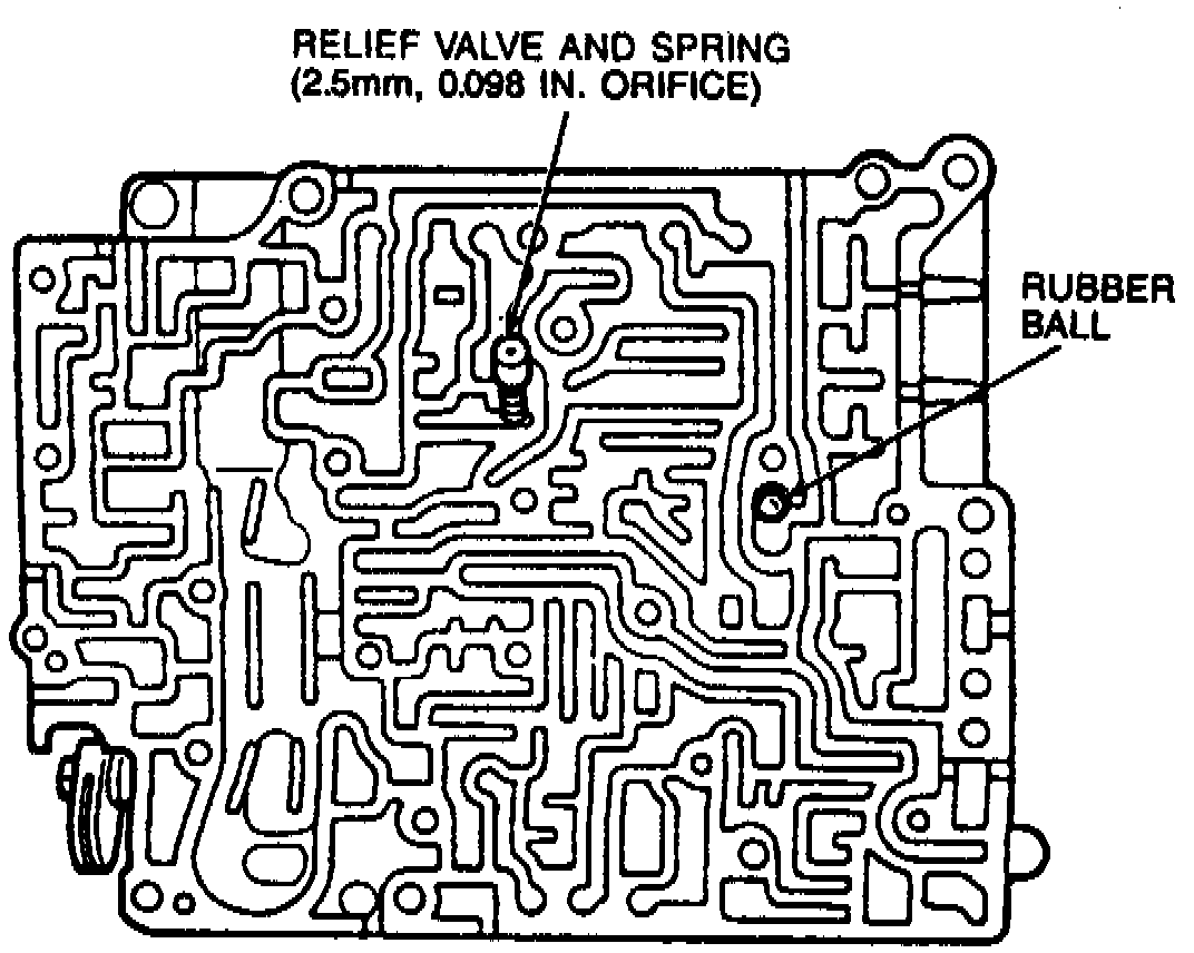

Relief Valve And Rubber Ball Location From Main Control Body:
14. Remove orifice check valves, springs, and rubber ball from main control body.

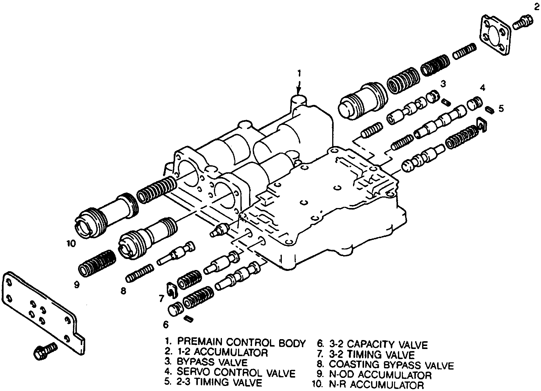

Overhaul Premain Control Body
Exploded View Of Premain Control Body:
1. Disassemble premain control body as shown in the Exploded View Of Premain Control Body image.
2. Inspect all components for excessive wear or damage and replace as necessary.
3. Reverse procedure to assemble, noting the following:
a. Apply clean automatic transaxle fluid to all 0-rings prior to installation.
b. Torque bolts for both accumulator plates to 57-69 in lbs.
