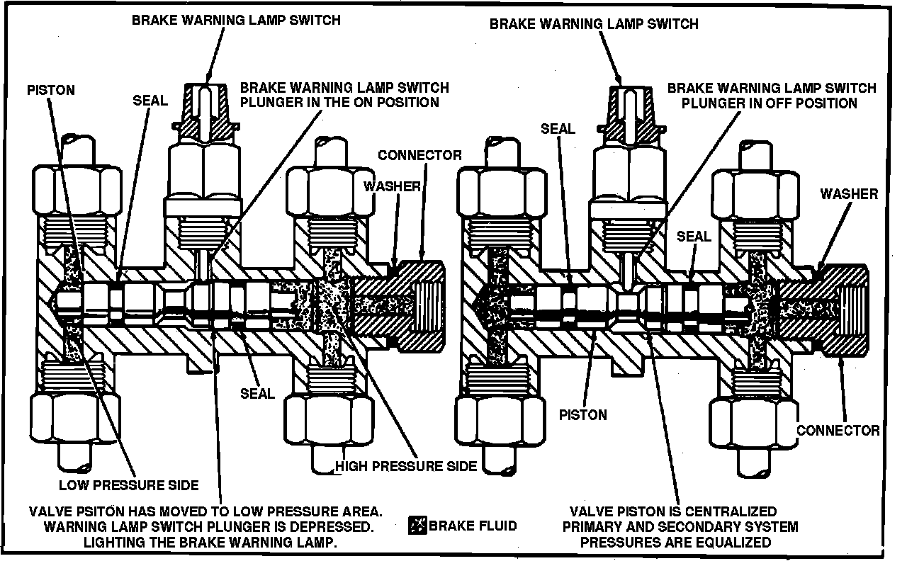

Fig. 5 Pressure Differential Valve & Brake Warning Light Switch:

In Fig. 5, the valve assembly consists of two valves in a common bore that are spring loaded toward the centered position. The spring-loaded switch contact plunger rests on top of the valves in the centered position (right view). When a pressure differential occurs between the front and rear brake systems, the valves will shuttle toward the side with the low pressure. The spring-loaded switch plunger is triggered and the ground circuit for the warning light is completed, lighting the lamp (left view).
