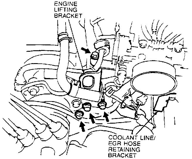

Engine Lifting And Coolant Line/EGR Hose Retaining Brackets:
7. Remove engine lifting bracket mounting bolt from throttle body and engine block.
8. Remove coolant line/EGR hose retaining bracket from throttle body.

9. Install engine lifting bracket mounting bolt and coolant line/EGR hose retaining bracket to throttle body.
