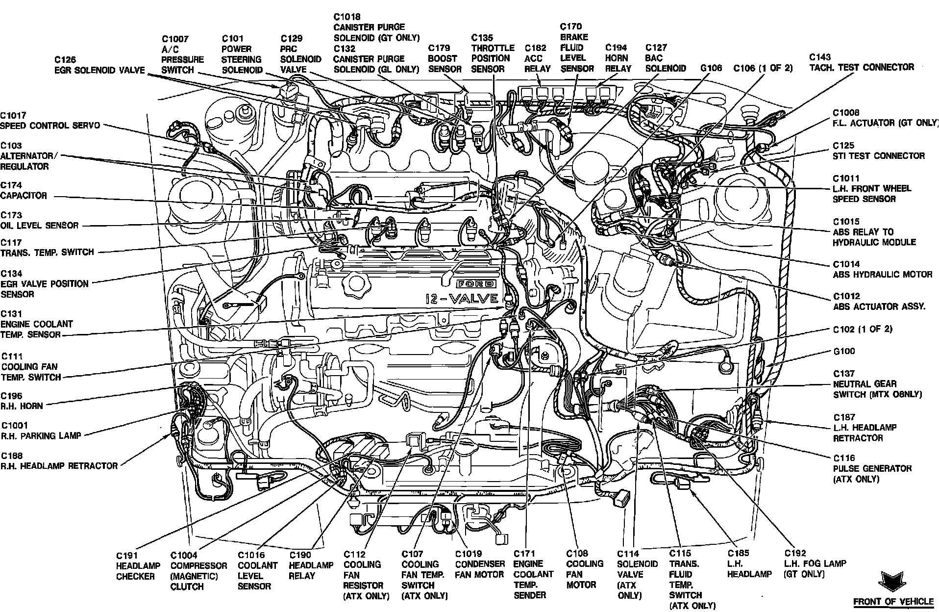

Engine Views
Component Location:
ABS ACTUATOR ASSY
ABS HYDRAULIC MOTOR
ABS RELAY
A/C PRESSURE SWITCH
ACC RELAY
ACTUATOR
ALTERNATOR/REGULATOR
BAC SOLENOID
BOOST SENSOR
BRAKE FLUID LEVEL SENSOR
CANISTER PURGE SOLENOID
CAPACITOR
COMPRESSOR
CONDENSER FAN MOTOR
COOLING FAN RESISTOR
COOLING FAN TEMPERATURE SENDER
COOLING FAN TEMPERATURE SWITCH
COOLANT LEVEL SENSOR
EGR SOLENOID VALVE
EGR VALVE POSITION SENSOR
ENGINE COOLANT TEMPERATURE SWITCH
FOG LAMP (GT ONLY)
FRONT WHEEL SPEED SENSOR
HEADLAMP
HEADLAMP CHECKER
HEADLAMP RELAY
HEADLAMP RETRACTOR
HORN
HORN RELAY
NEUTRAL GEAR SWITCH
OIL LEVEL SENSOR
PARKING LAMP
POWER STEERING SOLENOID
PRC SOLENOID VALVE
PULSE GENERATOR
SOLENOID VALE
SPEED CONTROL SERVO
STI TEST CONNECTOR
TACH. TEST CONNECTOR
THROTTLE POSITION SENSOR
TRANSMISSION FLUID TEMPERATURE SWITCH
TRANSMISSION TEMPERATURE SWITCH
