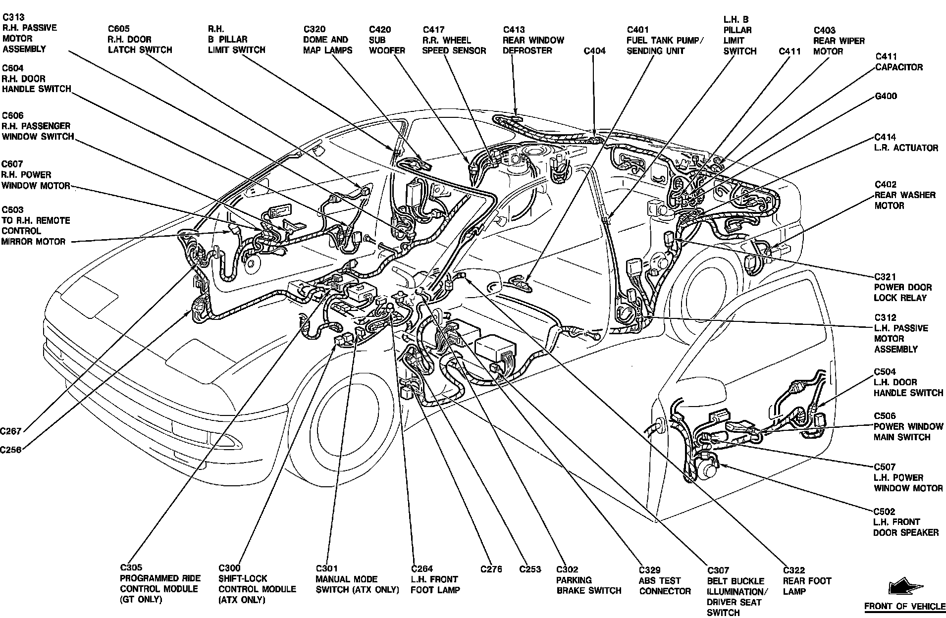

Full Body Views
Component Location:
B PILLAR LIMIT SWITCH
BELT BUCKLE ILLUMINATION/DRIVER SEAT SWITCH
CAPACITOR
DOME AND MAP LAMPS
DOOR HANDLE SWITCH
DOOR LATCH SWITCH
DOOR SPEAKER
FOOT LAMP
FUEL TANK PUMP/SENDING UNIT
MANUAL MODE SWITCH
PASSIVE MOTOR ASSEMBLY
PASSENGER WINDOW SWITCH
POWER DOOR LOCK RELAY
POWER WINDOW MAIN SWITCH
POWER WINDOW MOTOR
PROGRAMMED RIDE CONTROL MODULE
REAR WINDOW DEFROSTER
REMOTE CONTROL MIRROR MOTOR
SHIFT LOCK CONTROL MODULE
SUB WOOFER
WASHER MOTOR
WHEEL SPEED SENSOR
WIPER MOTOR
