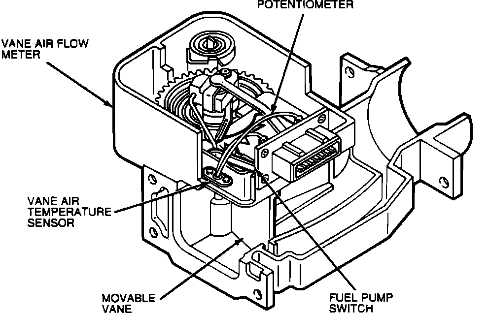

Vane Air Temperature (VAT) Sensor:
PURPOSE
The Vane Air Temperature (VAT) sensor measures inlet air temperature and provides an input signal to the ECA. The signal is used by the ECA in calculations for air/fuel ratio, fuel pressure, boost pressure, and idle speed.
LOCATION
Integral with vane air flow meter assembly.
OPERATION
Sensor is a device whose resistance changes with temperature. The ECA interprets these variations as temperature fluctuations.
