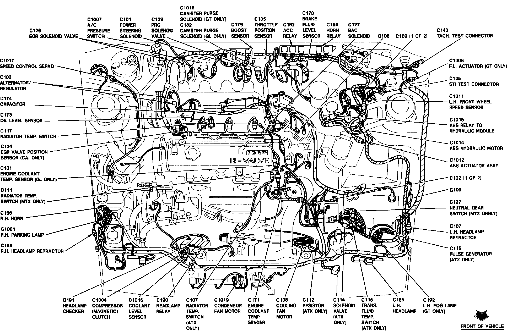

Computers and Control Systems: Locations
Engine Compartment View:
A/C PRESSURE SWITCH
ACC RELAY
BAC SOLENOID
BOOST SENSOR
CANISTER PURGE SOLENOID
COOLANT TEMPERATURE SENSOR
EGR SOLENOID VALVE
NEUTRAL GEAR SWITCH
POWER STEERING PRESURE SOLENOID
PRESSURE REGULATOR CONTROL (PRC) SOLENOID
STI TEST CONNECTOR
THROTTLE POSITION SENSOR
TACH TEST CONNECTOR
