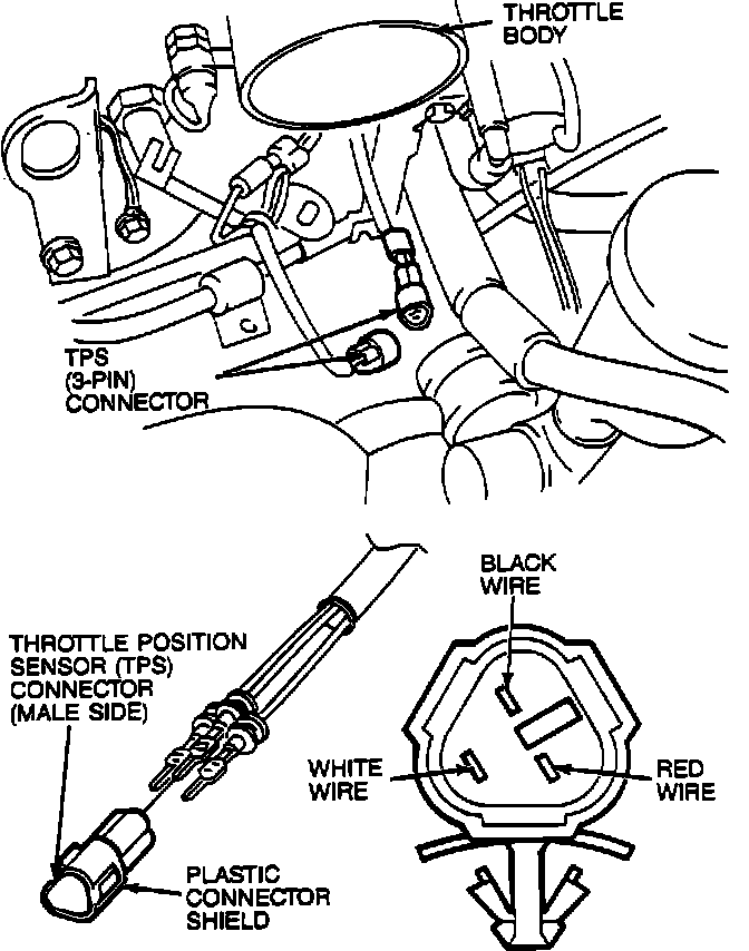

2. Disconnect TPS electrical connector at bottom of throttle body assembly.
Throttle Position Sensor Connector:
3. Remove plastic connector shield from male side of TPS connector.
4. Reconnect unshielded males side TPS connector to female connector. Be sure leads are in their proper locations.
NOTE: Use care not to ground exposed leads.
7. Connect a volt-ohmmeter (Rotunda #007-00001, or equivalent) to red and black wires. Measure red wire voltage. Reading should be 4.5 - 5.5 volts.
