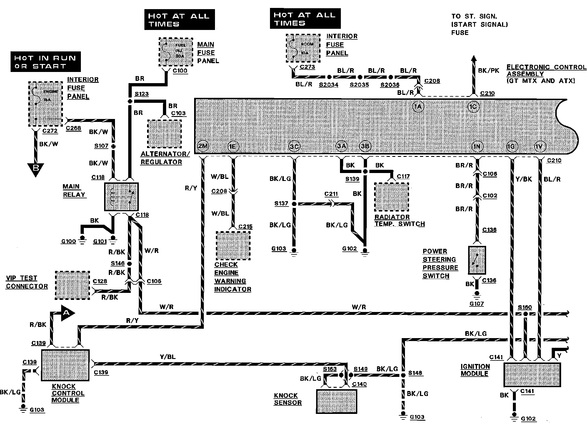

Engine Controls
Engine Controls:
ALTERNATOR/REGULATOR
CHECK ENGINE WARNING INDICATOR
ELECTRONIC CONTROL ASSEMBLY
IGNITION MODULE
INTERIOR FUSE PANEL
KNOCK CONTROL MODULE
KNOCK SENSOR
MAIN FUSE PANEL
MAIN RELAY
POWER STEERING PRESSURE SWITCH
RADIATOR TEMPERATURE SWITCH
VIP TEST CONNECTOR

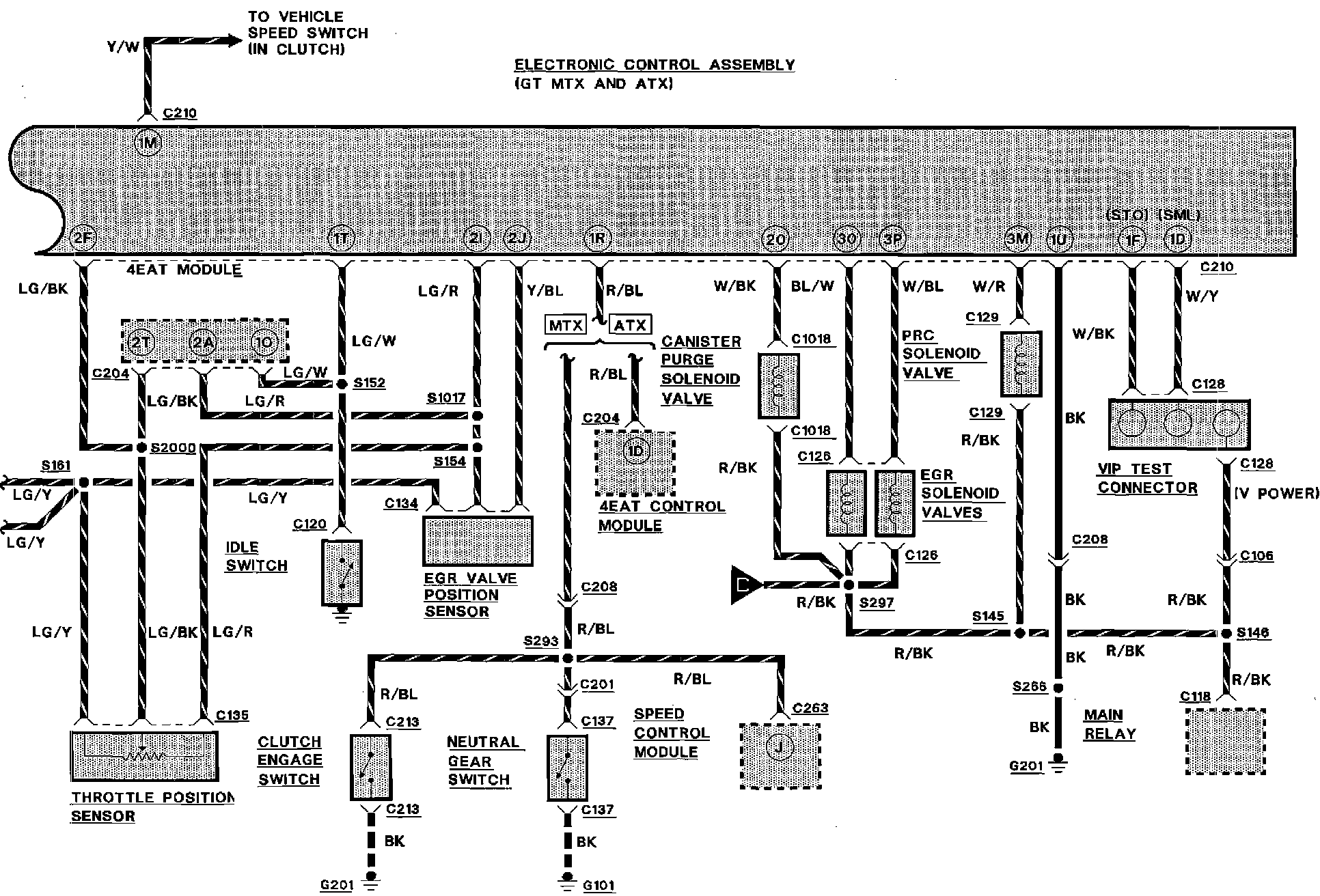

Engine Controls:
CANISTER PURGE SOLENOID VALVE
CLUTCH ENGAGE SWITCH
EGR SOLENOID VALVE
EGR VALVE POSITION SENSOR
IDLE SWITCH
MAIN RELAY
NEUTRAL GEAR SWITCH
PRC SOLENOID VALVE
SPEED CONTROL MODULE
THROTTLE POSITION SENSOR
VIP TEST CONNECTOR
4EAT CONTROL MODULE
