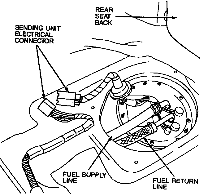

Removal
1. Relieve the fuel pressure as follows:
a. Start the engine.
b. Disconnect the fuel pump relay.
c. After the engine stalls, turn OFF the ignition switch.
d. Reconnect the fuel pump relay, fuel pressure is now relieved.
2. Disconnect the negative battery cable.
3. Remove the rear seat cushion.
4. Disconnect the sending unit electrical connector.
5. Remove the attaching screws from the sending unit access cover and remove the cover.
6. Remove the clamps securing the fuel supply and return line hoses and remove the hoses from the sending unit.
7. Remove all mounting screws and remove the fuel pump assembly and sending unit from the vehicle.
8. Disconnect the sending unit electrical connector.
9. Remove the sending unit attaching nuts and remove the sending unit from the fuel pump assembly.
