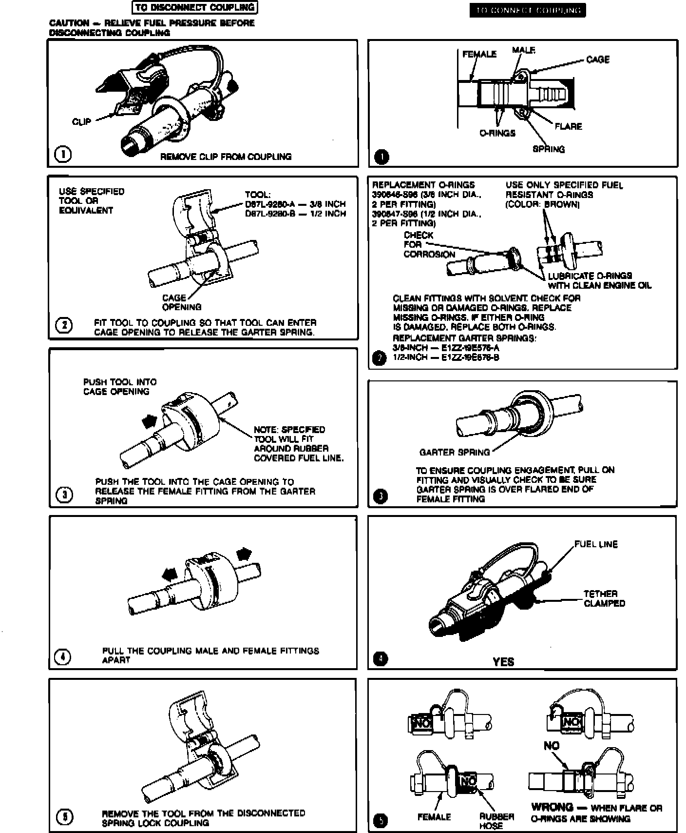

SPRING LOCK COUPLINGFuel Line Couplings:
REMOVAL
1. Relieve fuel system pressure.
2. Disconnect negative battery cable.
3. Remove retaining clip from spring-lock coupling by hand only. DO NOT use sharp tools or screwdriver; it may damage coupling.
4. Twist fitting to free it from any adhesion at O-ring seals.
5. Fit Spring-Lock Coupling Tool D87L-9280-A (3/8 inch) or D87L-9280B (1/2 inch), or equivalent, to coupling.
6. Close tool and push into open side of cage to expand garter spring and release female fitting.
7. After garter spring is expanded, pull fittings apart.
8. Remove tool from disconnected coupling.
INSTALLATION
1. Ensure garter spring is in cage of male fitting. If garter spring is missing, install a new spring by pushing it into cage opening. If spring is damaged, remove it from cage with a small wire hook (do not use a screwdriver) and install a new spring.
2. Clean all dirt or foreign material from both pieces of coupling.
3. Replace missing or damaged O-rings. Lubricate male fitting, O-rings, and inside of female fitting with clean engine oil.
CAUTION: Use only specified O-rings made of a special material. The use of O-rings other than specified may permit intermittent leaks during vehicle operation.
4. Fit female fitting to male fitting and push until garter spring snaps over flared end of female fitting.
5. Ensure coupling engagement by pulling on fitting and visually checking to ensure garter spring is over flared end of female fitting.
6. Position retaining clip over metal portion of spring lock coupling. Firmly push retaining clip onto spring-lock coupling. Ensure horseshoe portion of clip is over the coupling. DO NOT install retaining clip over rubber fuel line.
NOTE: Install large "black" clip to supply side fuel line and smaller "gray" clip to return side fuel line.
