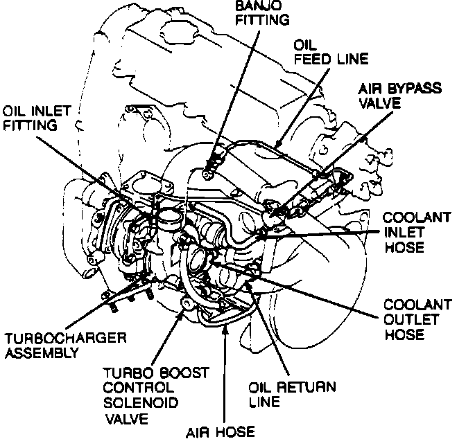

OPERATION
The turbocharger is lubricated by engine oil. Because it operates at speeds up to 180,000 rpm, lubrication of the full-floating type bearings supporting the shaft is necessary for cooling and friction reduction.
Turbocharger oil pressure is fed through a banjo fitting on the rear side of the engine. Oil enters the turbocharger through an inlet fitting in the center housing. Center housing bearings are lubricated through oil passages which direct oil to the bearing housings. These bearings are cooled by engine coolant. Bearings are drilled to improve oil circulation. Lip ring seals are used on both turbine and compressor wheel shaft ends to prevent engine oil leakage into turbine wheel and compressor wheel housing. Oil returns from turbocharger and to engine through a return hole in the center housing.
Accelerating the engine to high rpm immediately after starting can damage the engine and/or turbocharger. Immediately shutting down an engine that has been operating at high rpm for an extended period of time can damage the engine and/or turbocharger.
