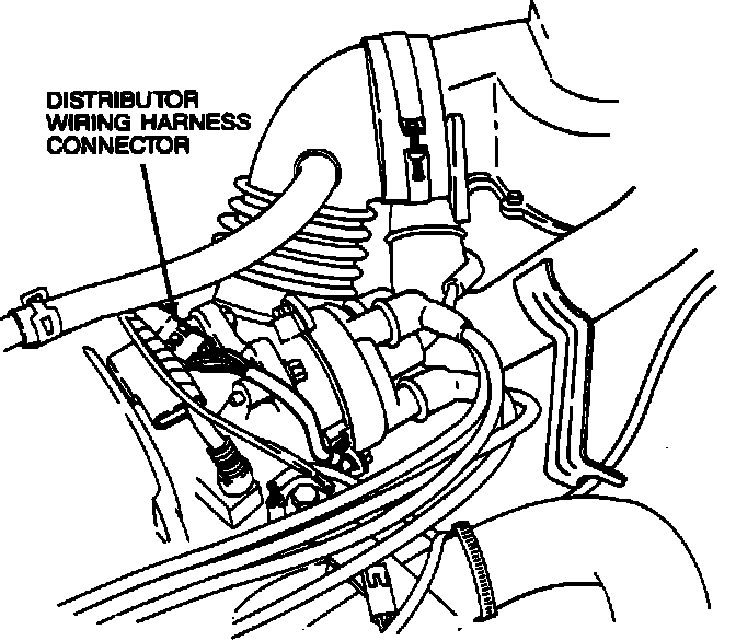

Distributor Wiring Harness Connector.:
2. Disconnect distributor electrical connector near distributor.
