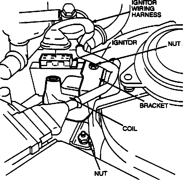

Ignitor Wiring Harness.:
3. Disconnect ignitor wiring harness.
4. Remove the two bracket nuts and lift ignition coil and ignitor assembly.
Ignition Coil And Ignitor Assembly:
5. Slide protective cover back and disconnect ignition coil and noise suppressor wiring harness.
6. Remove the noise suppressor.
Ignitor Module And Ignition Coil Assembly:
7. Remove two screws, the ignitor module, bracket, and ignition coil.
