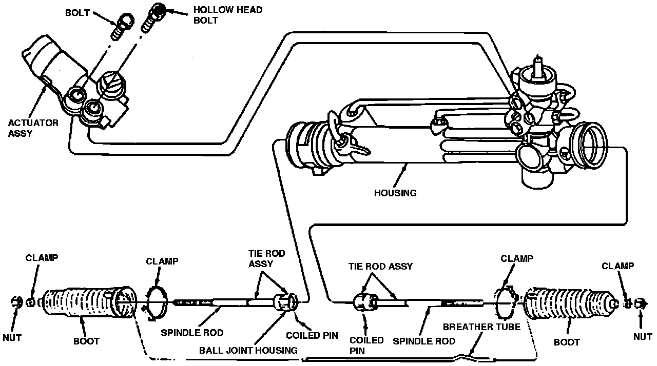

VAPS System:
VAPS Gear Assembly:
The Variable Assist Power Steering (VAPS) system consists of a microprocessor-based control module, a power rack and pinion gear, an actuator valve assembly, interconnecting hose assemblies and a high efficiency power steering pump, Fig. 2.
The VAPS system incorporates a modified rotary valve in the gear with two independent hydraulic circuits called the primary and secondary circuits. During parking and low vehicle speed operation, fluid flow from the pump is routed to the primary circuit by an electrically controlled actuator valve assembly. As vehicle speed increases, the actuator valve gradually opens, diverting the increased fluid volume to the secondary circuit.
The actuator valve assembly, Fig. 3, is a pressure balanced variable orifice valve, controlled by a stepper motor driven linear spool. The VAPS module receives inputs from the vehicle speed sensor and transmits signals to the stepper motor driven spool to adjust orifice opening of the actuator valve.
