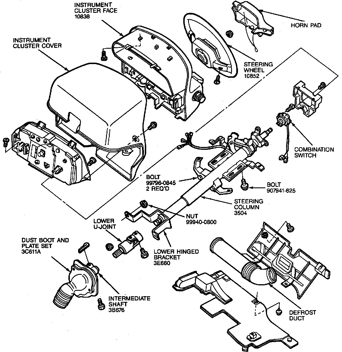

Fig. 6 Steering Column Installation:
Removal
2. Working from back side of steering wheel, remove two horn pad attaching screws. Carefully separate horn pad from steering wheel, disconnect electrical connector, then place pad aside.
3. Remove steering wheel attaching nut.
4. On 1989-90 models, use a suitable puller, separate steering wheel from steering shaft.
5. On 1991-92 models, do not use a steering wheel puller, using a puller will collapse the steering shaft. Paint an aligning stripe on steering wheel and shaft, then pull steering wheel off.
6. On all models, remove two steering column cover attaching screws, then the cover.
7. Remove nine instrument cover attaching screws, then carefully pull instrument cover outward and remove ignition illumination bulb. Disconnect electrical connectors and remove cover.
8. Loosen two instrument cluster cover hinge screws.
9. Remove six instrument cluster cover attaching screws, then the cover.
10. Remove lower panel.
11. Remove lap and defroster ducts.
12. Disconnect four electrical connectors from turn signal switch assembly.
13. Remove U-joint cinch bolt from lower end of steering shaft.
14. Remove hinge bracket mounting nuts.
15. Remove four cluster support nuts.
16. Remove four nuts and two bolts from upper steering column bracket, then the steering shaft assembly.
17. Raise dust boot covering intermediate shaft U-joint at steering rack, then remove cinch bolt from U-joint.
18. Remove four intermediate shaft dust cover assembly attaching nuts, then the intermediate shaft assembly.
