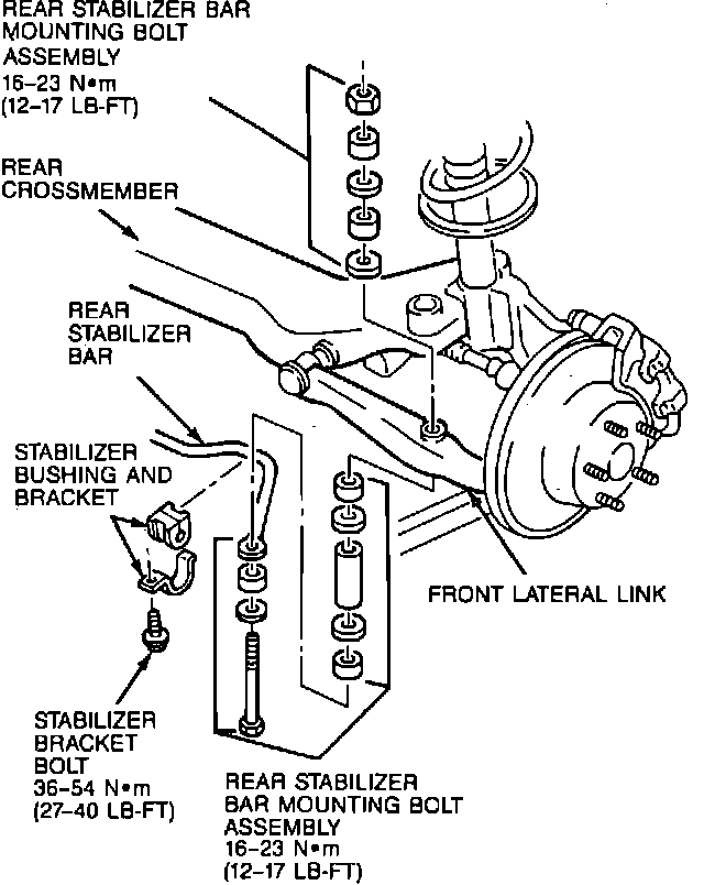

LATERAL LINKFig. 4 Lateral Link & Rear Crossmember:
2. Remove spindle from vehicle.
3. Remove rear stabilizer.
4. Remove nut from lateral link mounting bolt at the rear crossmember. Remove lateral link.
5. Remove parking brake attaching bolts from trailing arm assembly.
6. Remove the trailing arm mounting bolt from the body mounting bracket.
7. Remove trailing arm from the vehicle.
8. Remove exhaust mounting bolts and brake line retaining bracket from rear crossmember.
9. Remove mounting bolts from end of the crossmember.
10. Remove rear crossmember and front lateral link as an assembly.
11. Remove common lateral link mounting bolt from the rear crossmember.
12. Remove front lateral link from rear crossmember, Fig. 4.
13. Reverse procedure to install. Tightening bolts to specifications.
