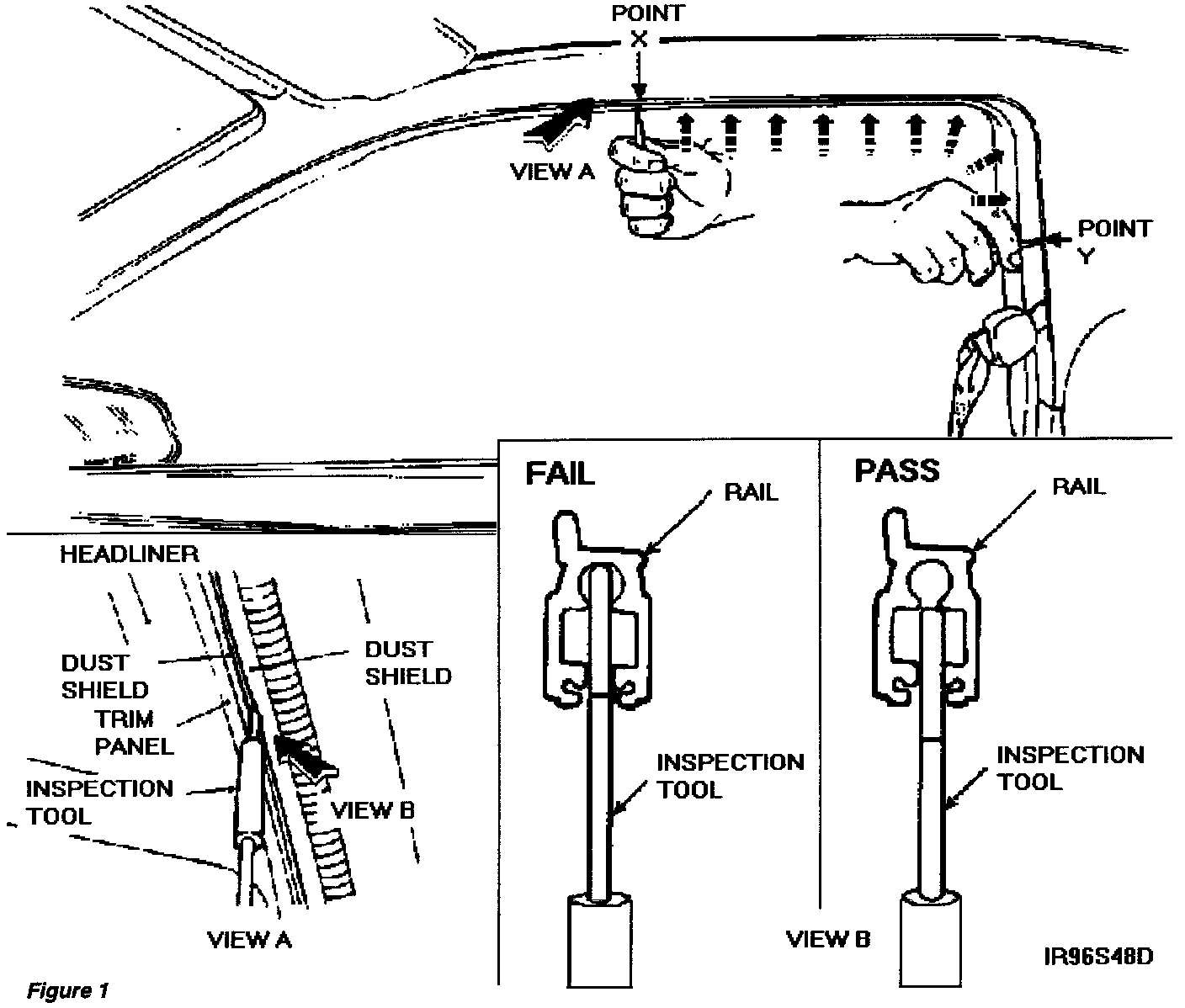

Dust shield wear may cause the position of the scribe line to vary. Insert the inspection tool between dust shields of the rail assembly at point X. Tool must be installed until it bottoms out in the rail assembly. Note the distance between the dust shields and the scribed line on the tool. Insert the inspection tool every 1/2" from point X to point Y of the rail assembly. See Figure 1. DO NOT SLIDE THE INSPECTION TOOL ALONG THE RAIL ASSEMBLY. REMOVE AND REINSERT EVERY 1/2" BETWEEN POINT X AND POINT Y.
3.
a. If installed inspection tools' depth does not increase (scribe line does not move closer to the dust shield) anywhere between points X and Y, no service action is required.
b. If installed inspection tools' depth increases (scribe line moves closer to the dust shield) anywhere between points X and Y, the rail assembly must be replaced, see Rail Replacement.
