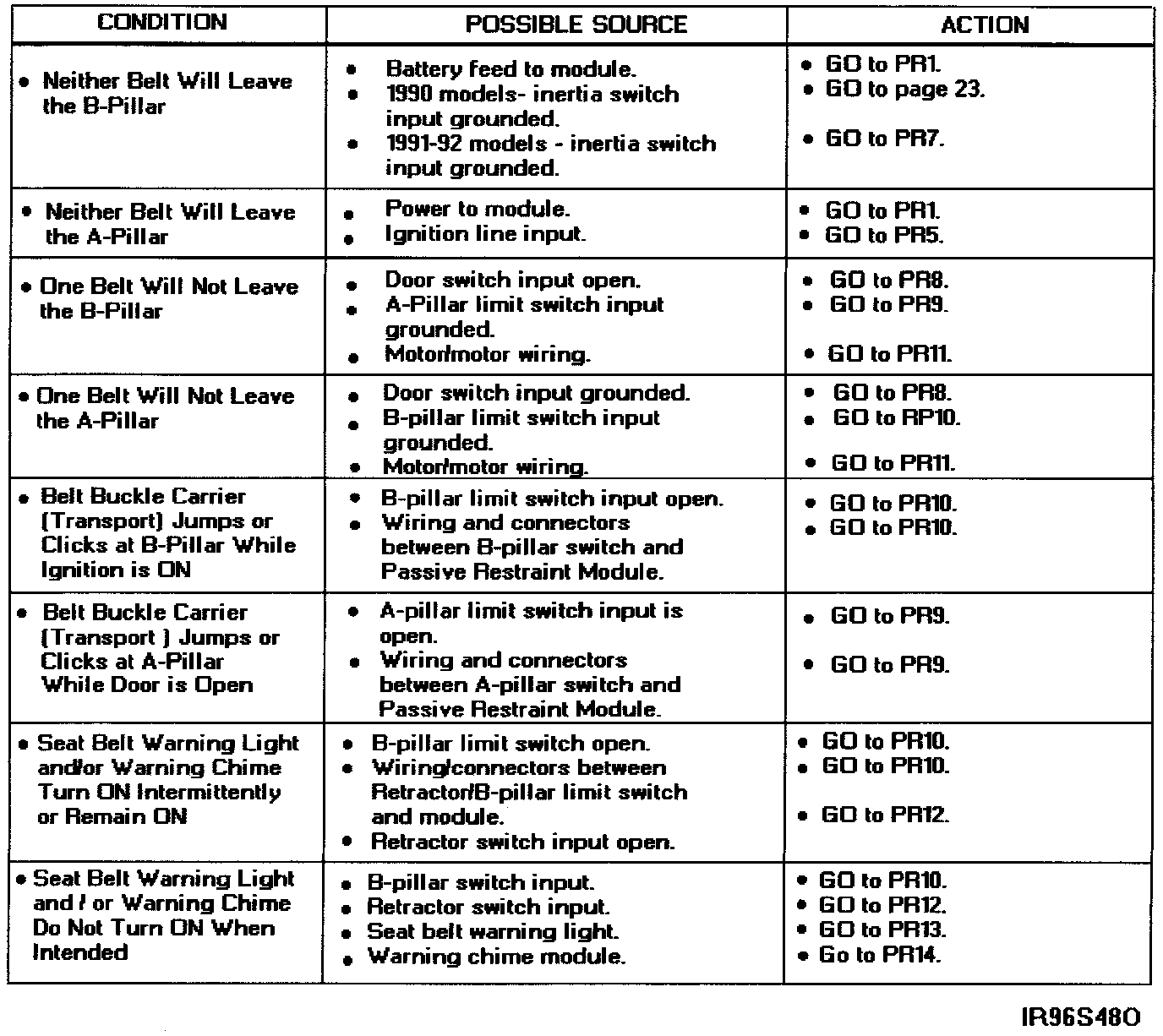

Symptom Chart
Probe Seat Belts

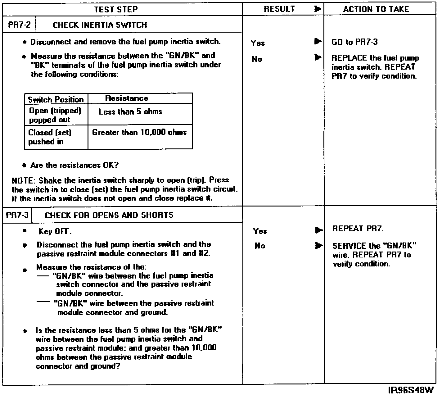

To move the buckle carrier from the B-pillar to the A-pillar when the door is opened (pin 2D grounded), and the inertia switch is set (pin 2F floating), the passive restraint module will check the A-pillar limit switch (pin 1F).
If the A-pillar limit switch is not activated (pin 1F floating), the passive restraint module will apply power to the driver motor. This will send the buckle carrier from the B-pillar to the A-pillar (pins 1J & 1H high, pins 1L & 1K grounded), until the A-pillar limit switch is activated (pin 1F grounded).
If the A-pillar limit switch is activated (pin 1F grounded), or the inertia switch is tripped (pin 2F grounded), no action will occur.

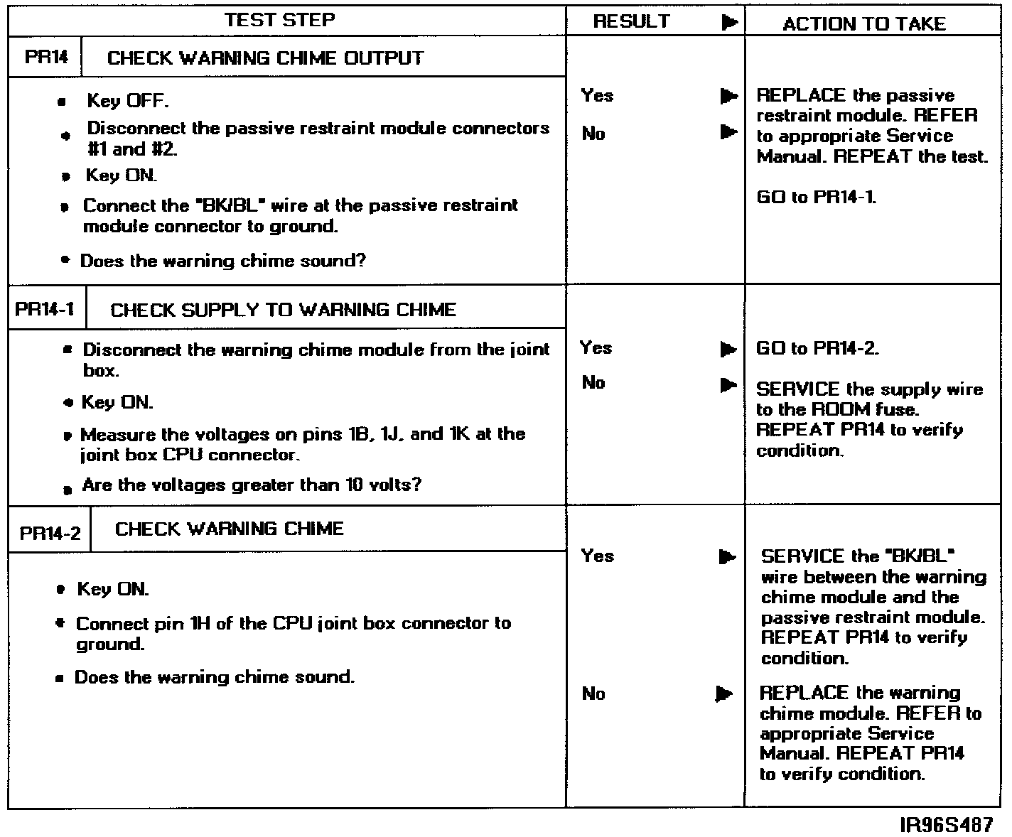

THE WARNING CHIME MODULE INTERFACES WITH THE WARNING LIGHT.
Conditions To Activate The Warning Chime
When the passive restraint module determines that a warning is required, the audible chime output (pin 1N) supplies a ground to the warning chime module.
When the ignition key is in the ON position (pin 2C high), and either shoulder belt is spooled in (pin 2B or 1O floating/not grounded), the chime output is activated (pin 1N grounded) for five seconds. If this output has been triggered and timed out, it can be triggered again by spooling in the other shoulder belt (floating/grounding pin 2B or 1O).

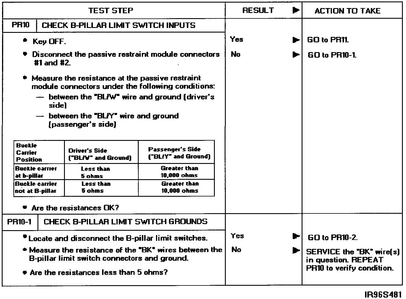

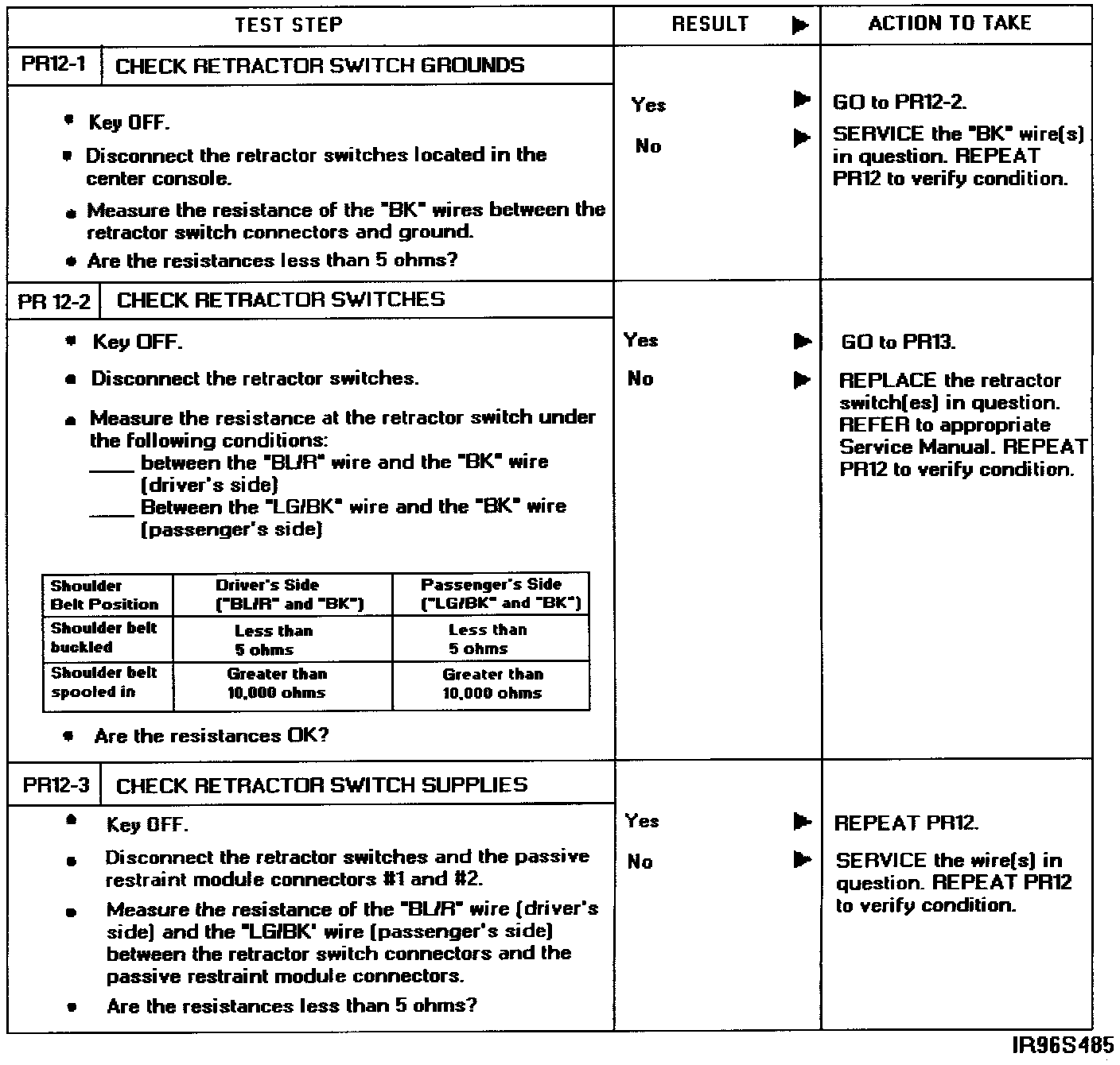

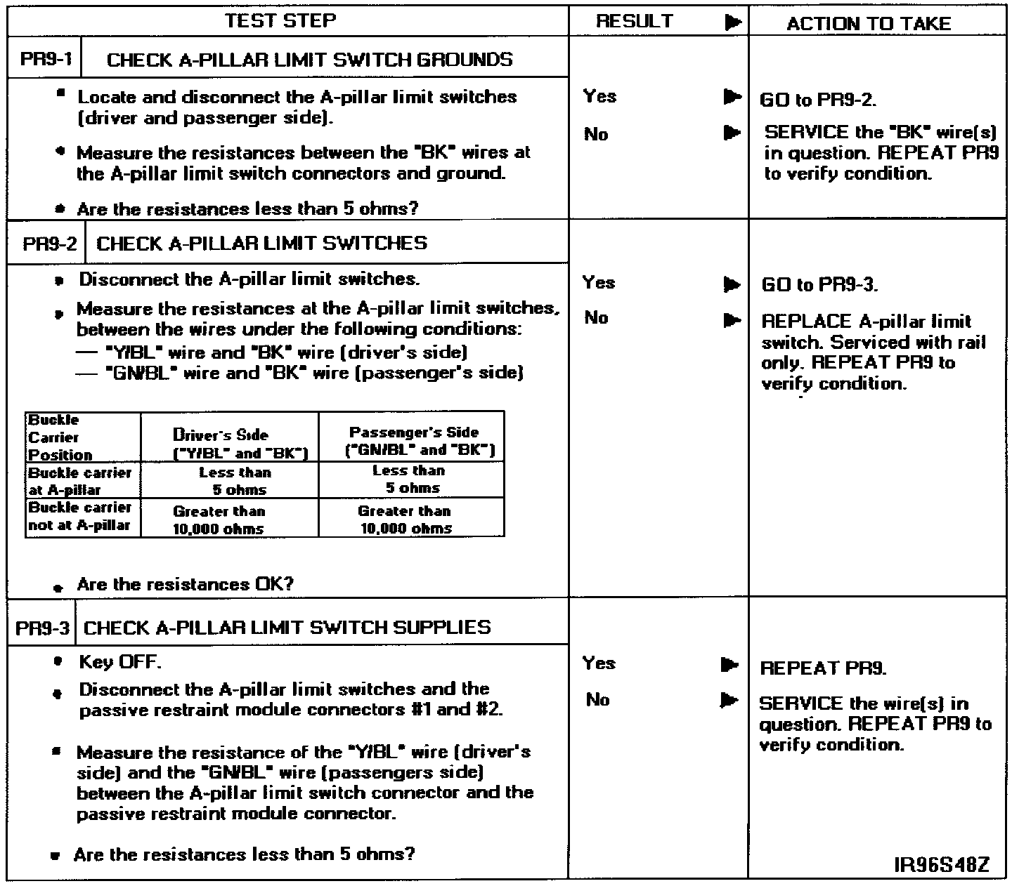

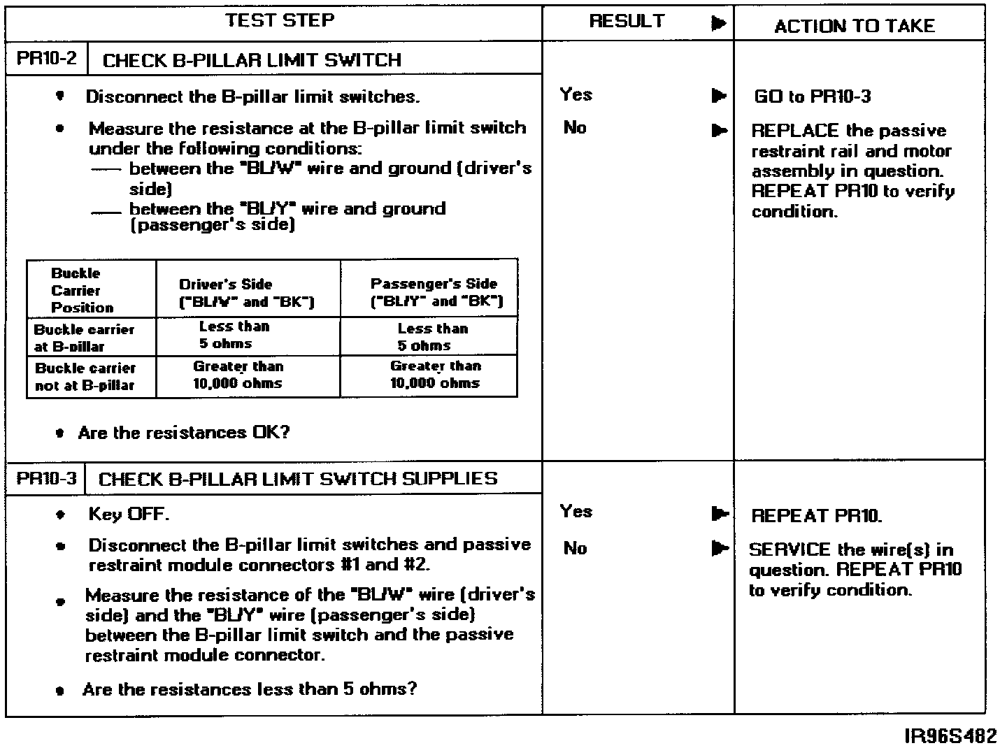

Diagnosis And Testing
