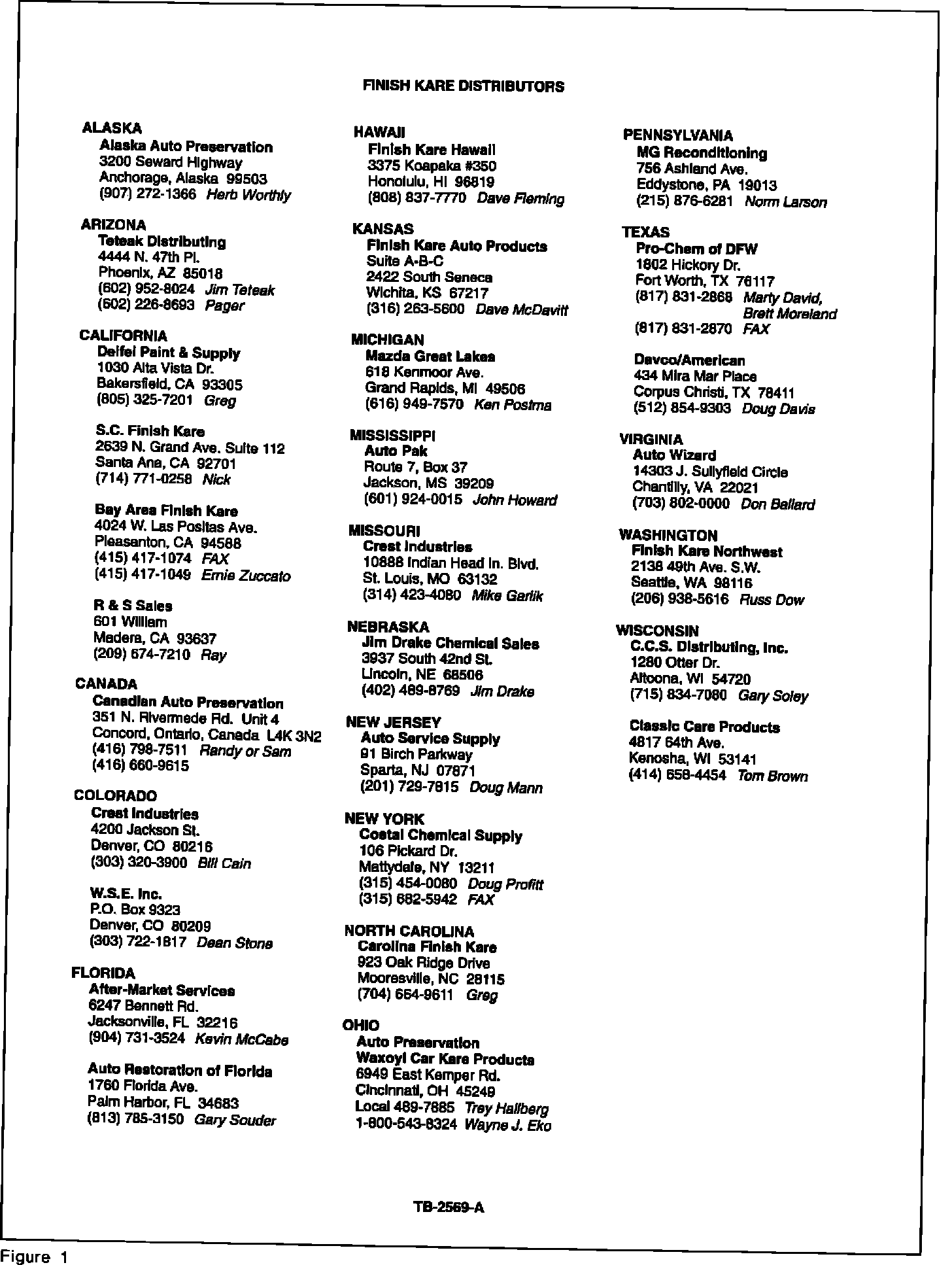

FINISH KARE DISTRIBUTORS
Figure 1:
Refer to Figure 1 for a list of Finish Kare Distributors in the U.S. and Canada.
