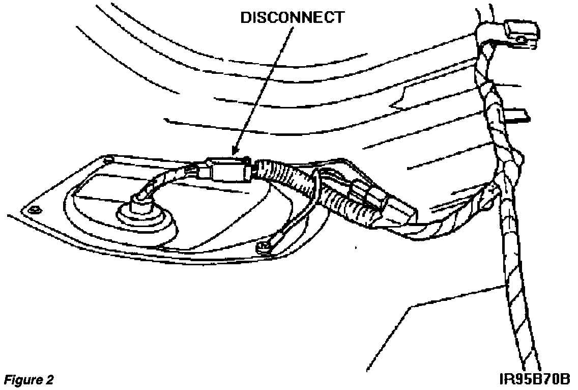

5. Disconnect fuel pump electrical connector. See Figure 2.
6. Connect jumper harness F4CA-14406-A to fuel pump connector and to vehicle wiring harness.
7. Coil and tie-strap the jumper harness to the vehicle wiring harness. See Figure 3.
