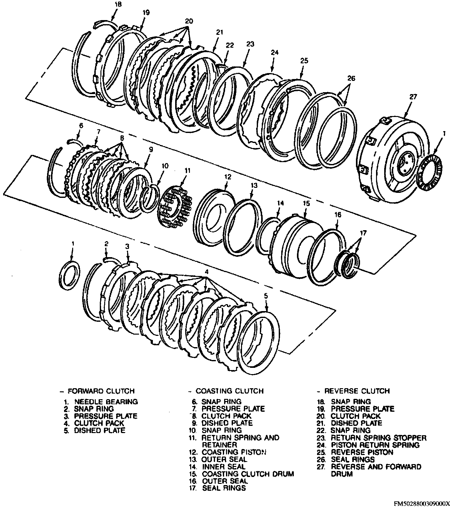

DISASSEMBLEExploded View Of Clutch Assembly:
1. Refer to the Exploded View Of Clutch Assembly image for disassembling procedure.
