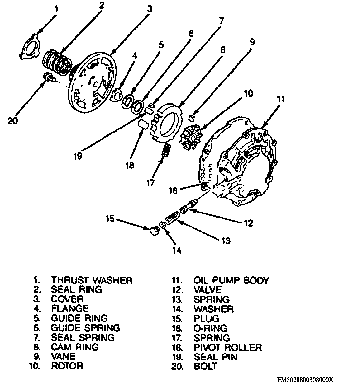

DISASSEMBLEExploded View Of Oil Pump:
NOTE: Refer to the Exploded View Of Oil Pump image when disassembling oil pump.

ASSEMBLE
1. Install spool valve and spring into oil pump body with new washer and plug.
NOTE: Ensure spool valve moves smoothly before tightening plug. Torque plug to 17-26 ft lbs.
2. Install cam ring, pivot roller, and rotor onto oil pump body.
3. Install vanes into rotor.
4. Install guides spring and guide ring while expanding vanes toward cam ring.
5. Install pump flange on rotor, then the spring between cam ring and oil pump body.
6. Install seal pin and spring with seal pin facing toward oil pump body.
NOTE: Ensure round pins are installed first.
7. Install oil pump cover and 0-rings to oil pump body. Torque bolts in sequence to 70-97 in lbs.
8. Install seal rings and oil pump shaft. Ensure shaft turns smoothly.
9. Lubricate bearing race, then install oil pump cover.
