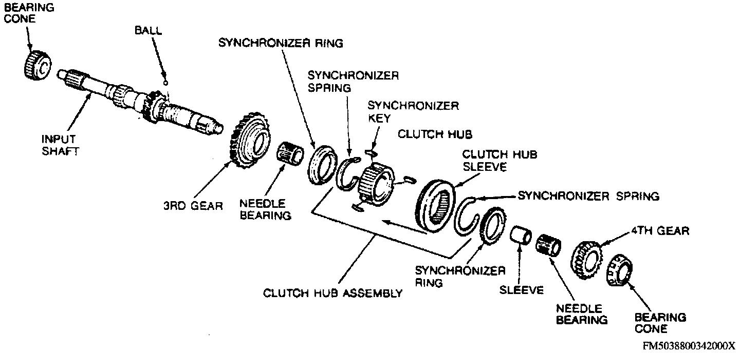

DISASSEMBLEExploded View Of Input Shaft Gear:
NOTE: Refer to the Exploded View Of Input Shaft Gear image when performing the following procedure.

Synchronizer Ring Groove And Key Alignment:
NOTE: When installing synchronizer ring and clutch hub assembly, align synchronizer ring groove and synchronizer key.
