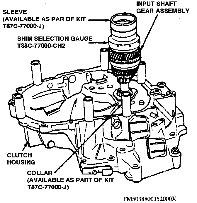

e. Position shim selection gauge tool No. T88C-77000-CH2, or equivalent, on top of input shaft gear assembly.
Transaxle Case Collar Locations:
f. Place six collars from gauge tool on clutch housing at positions shown in the Transaxle Case Collar Locations image.
g. Place transaxle case on collars, then install washers and bolts.

o. Repeat this procedure for main shaft. Ensure removal of sleeve from shim selection gauge tool No. T88C-77000-CH2, or equivalent. There should not be any gap between gauge halves.
