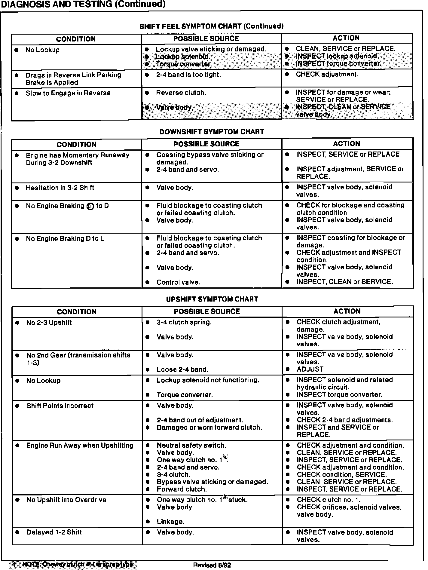

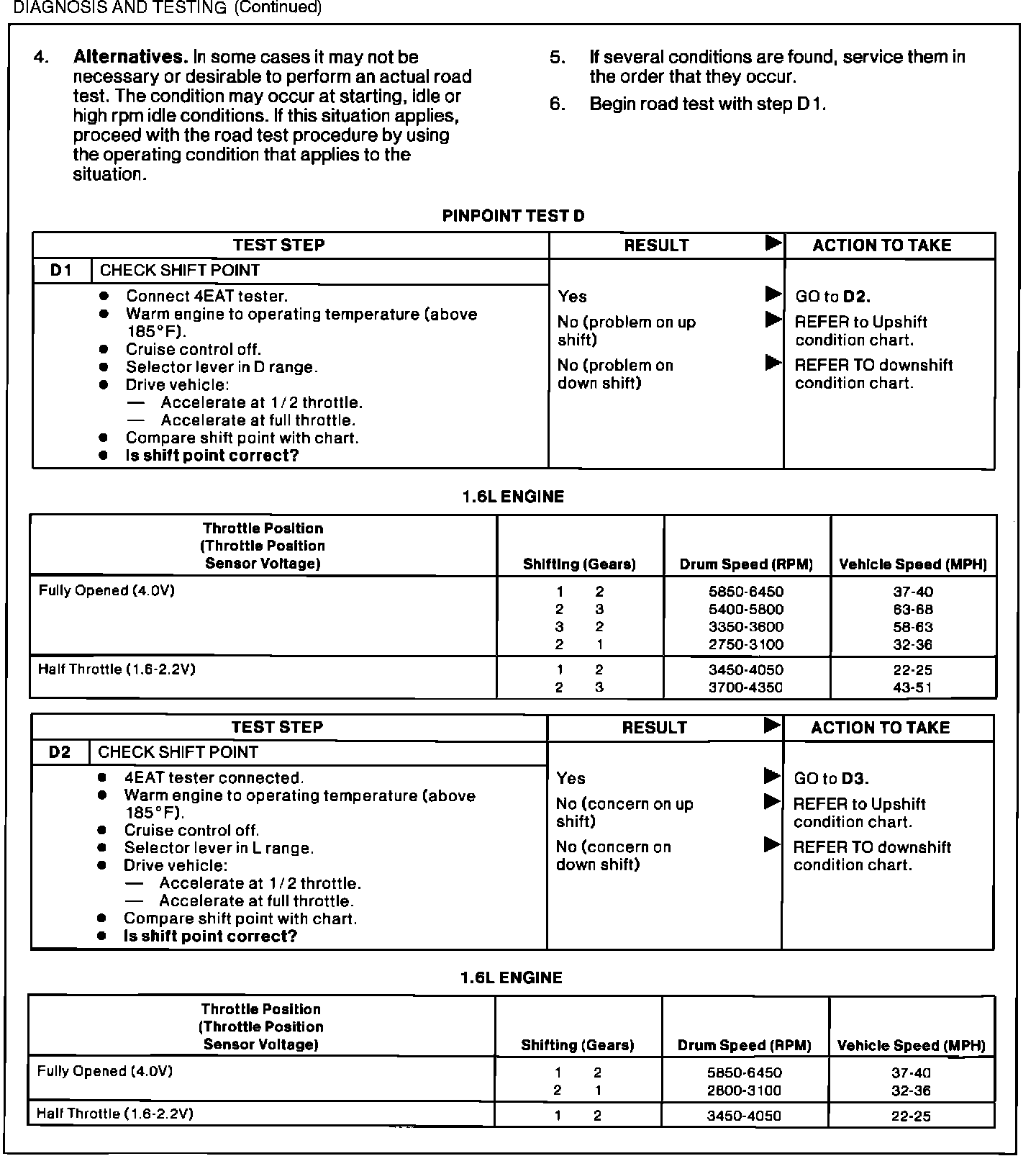

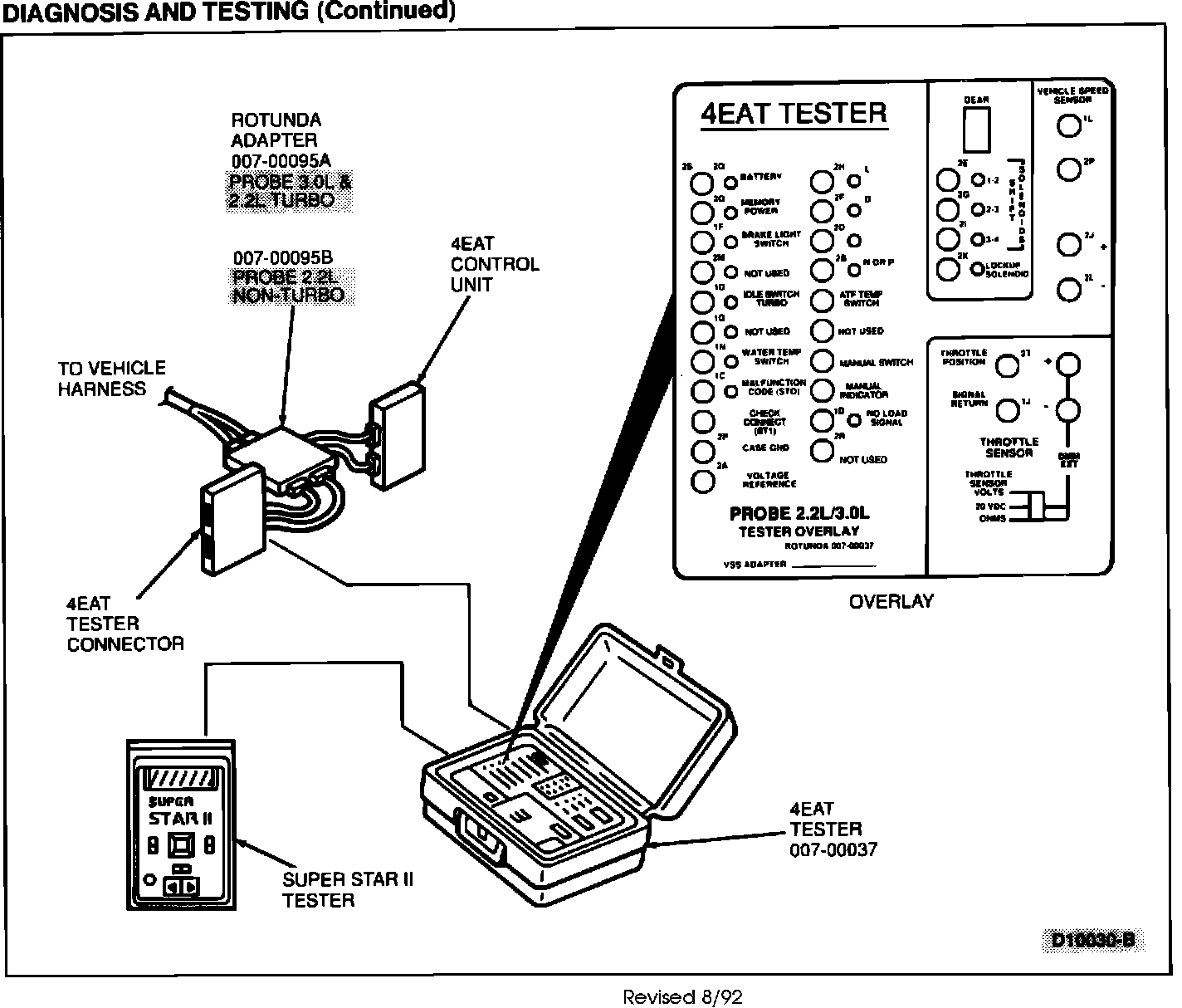

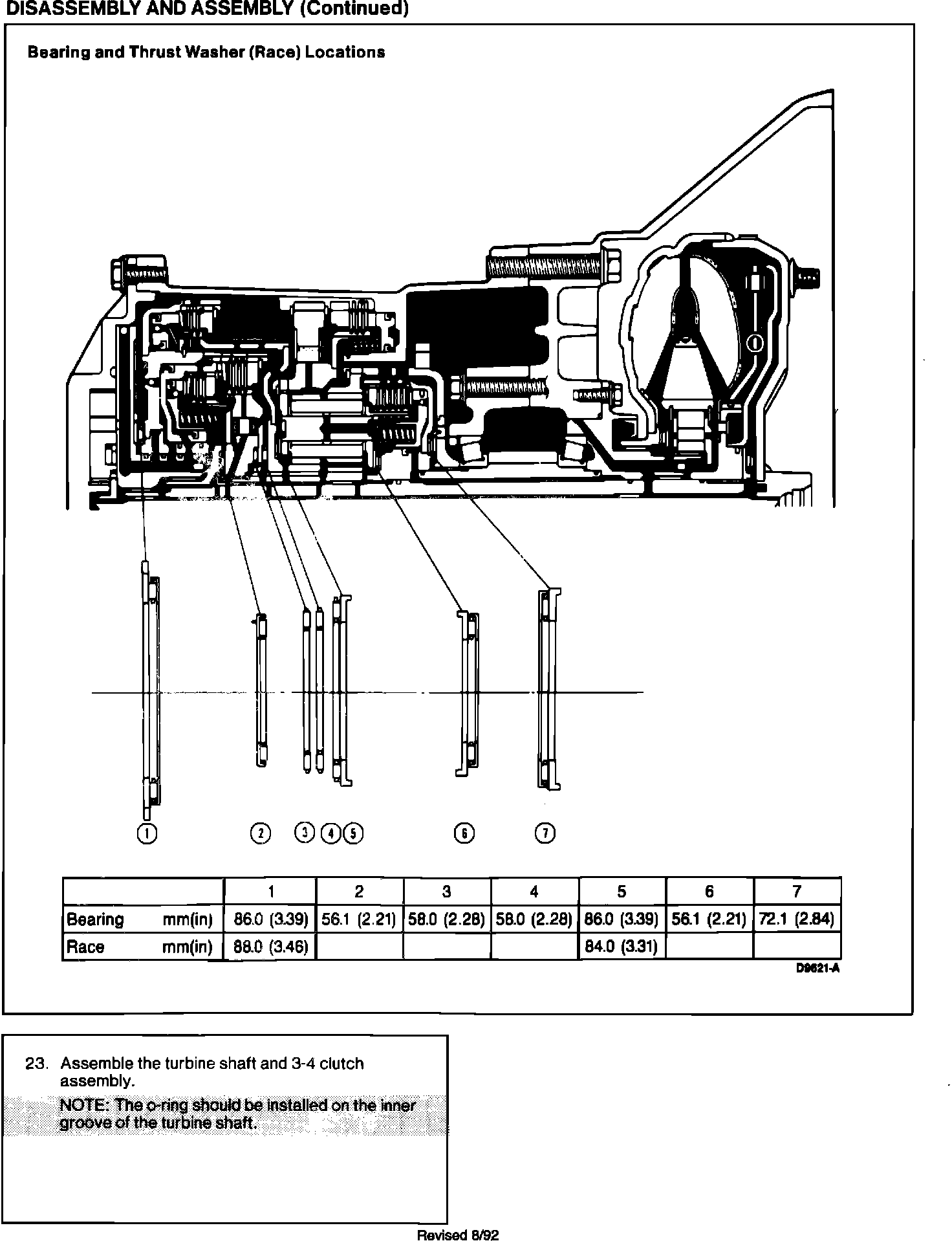

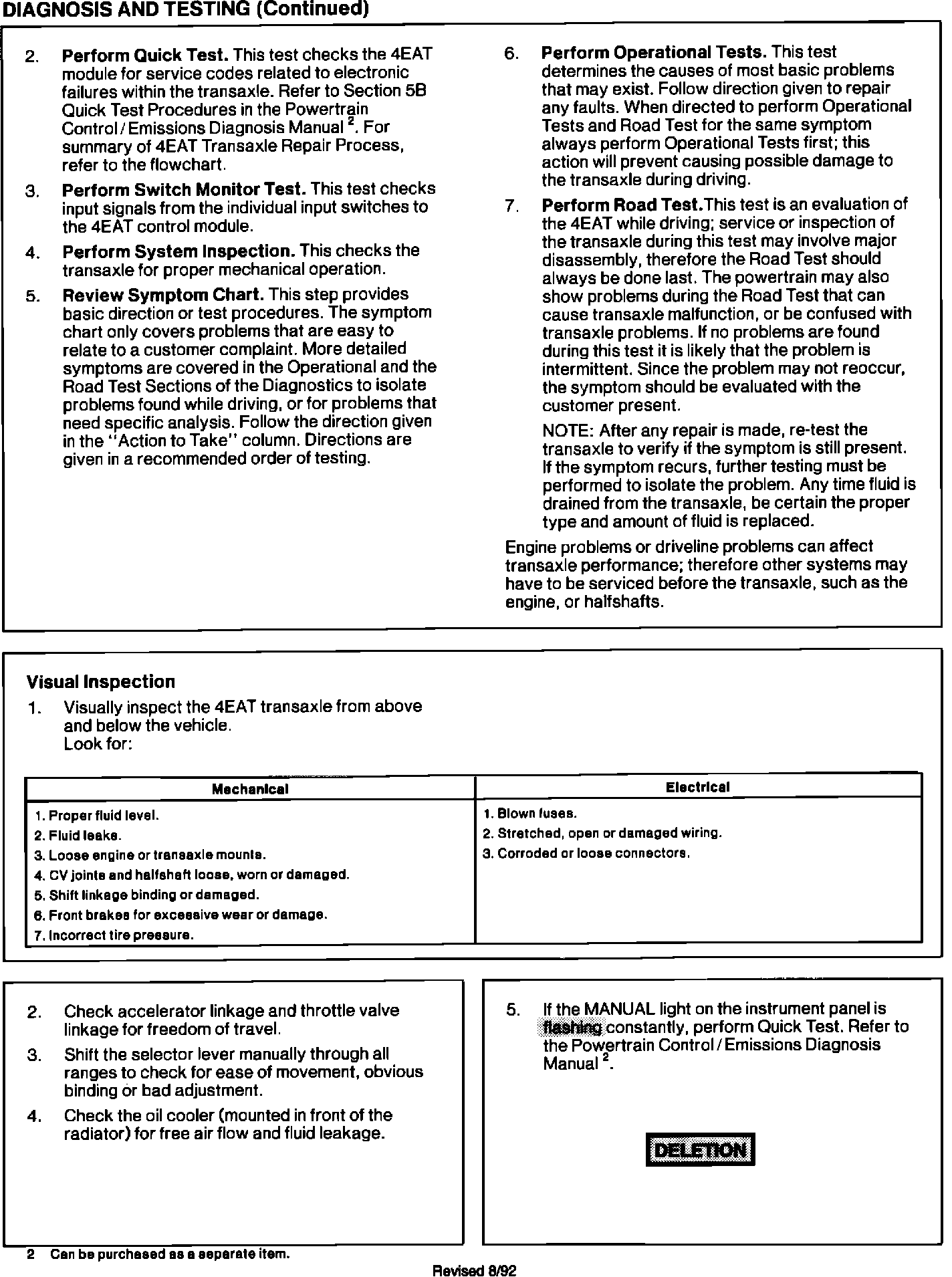

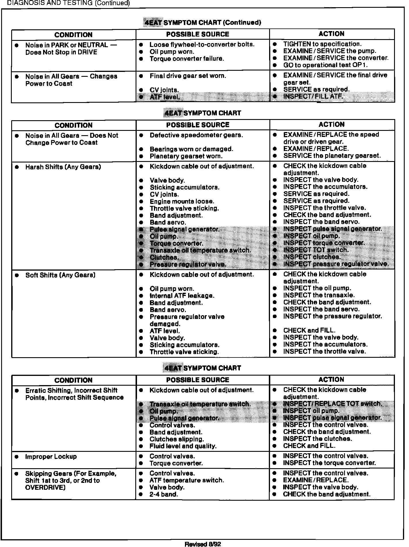

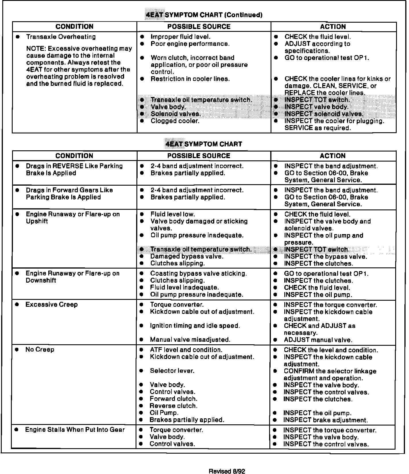

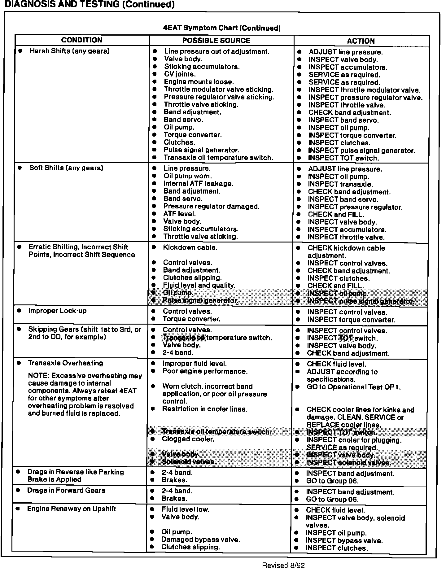

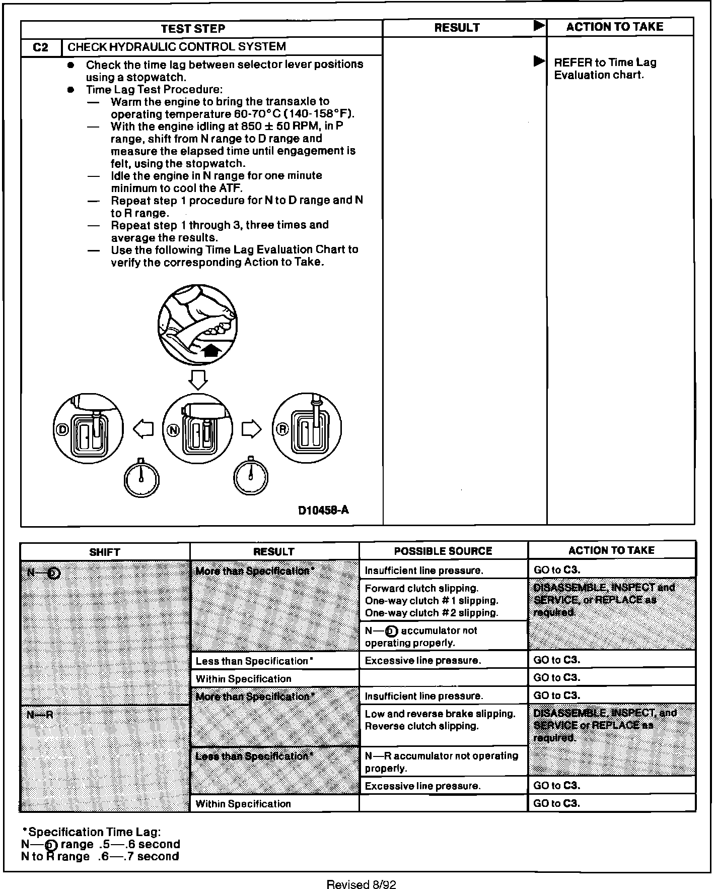

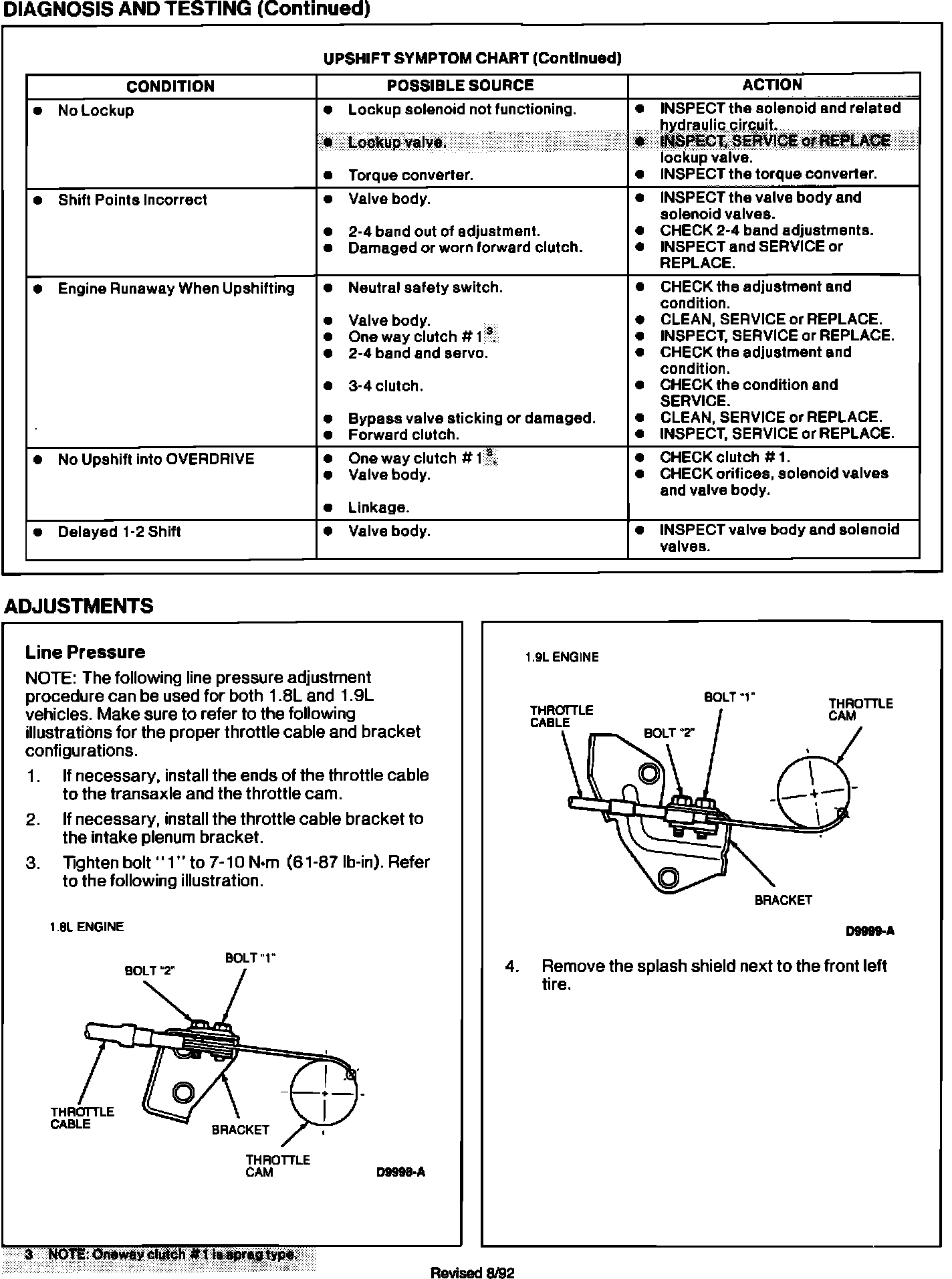

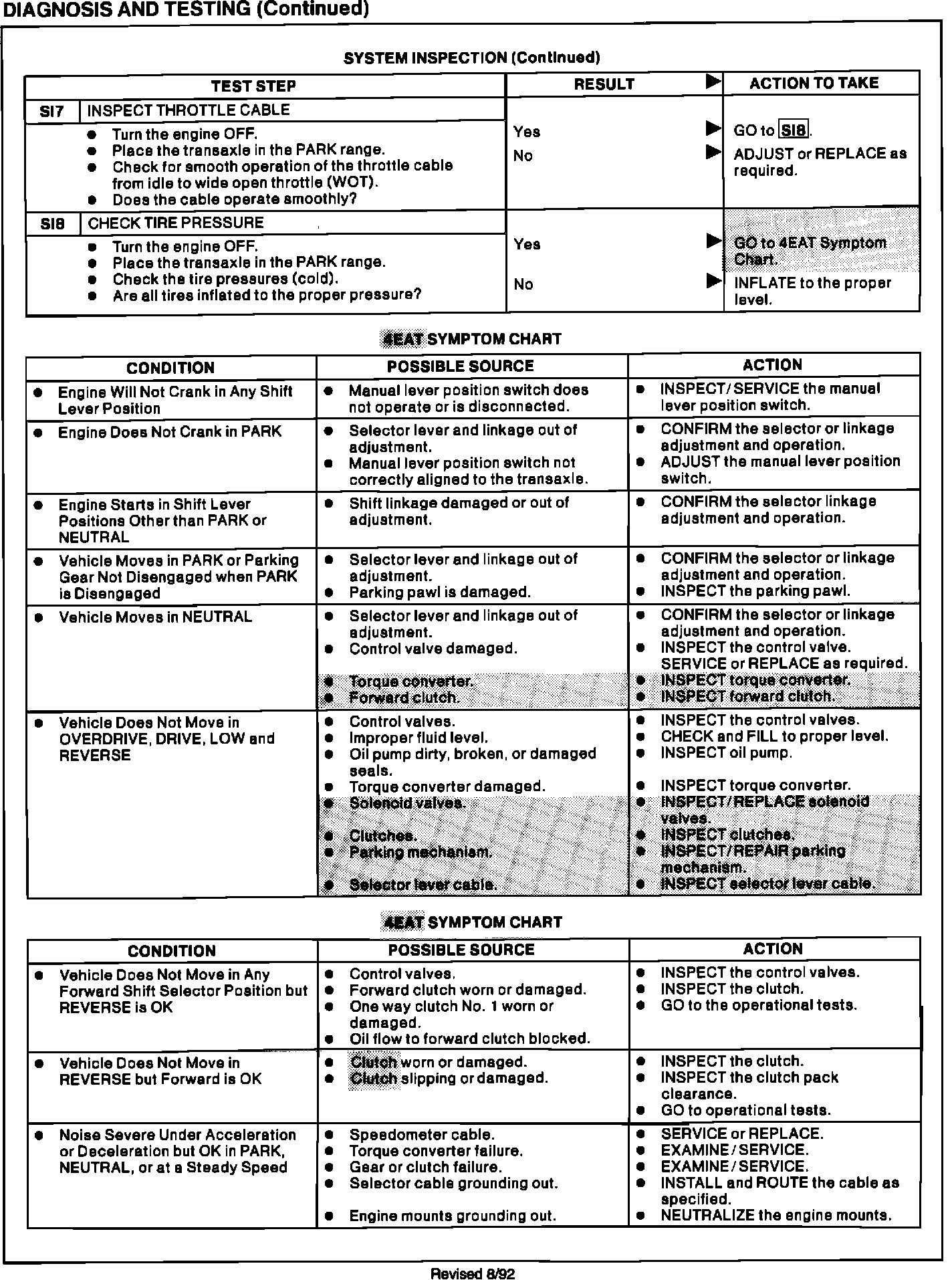

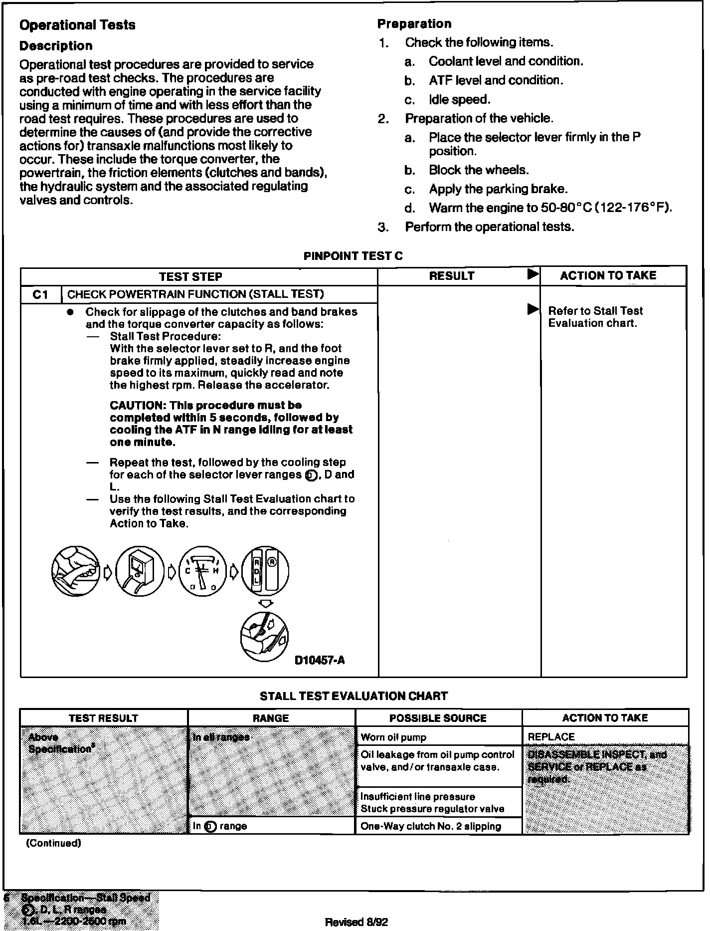

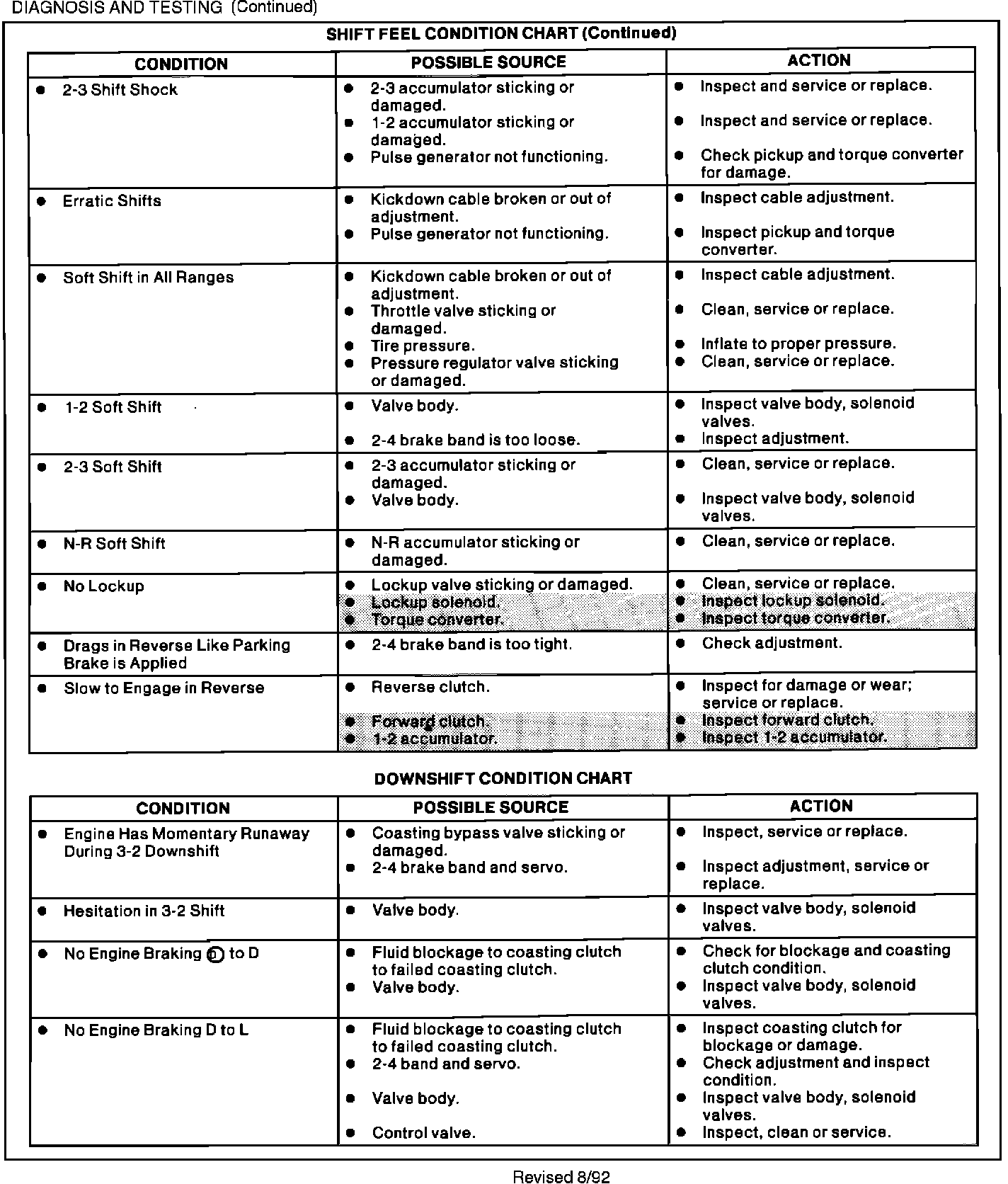

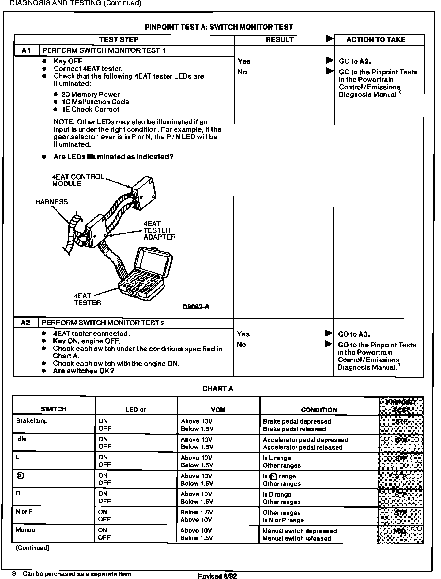

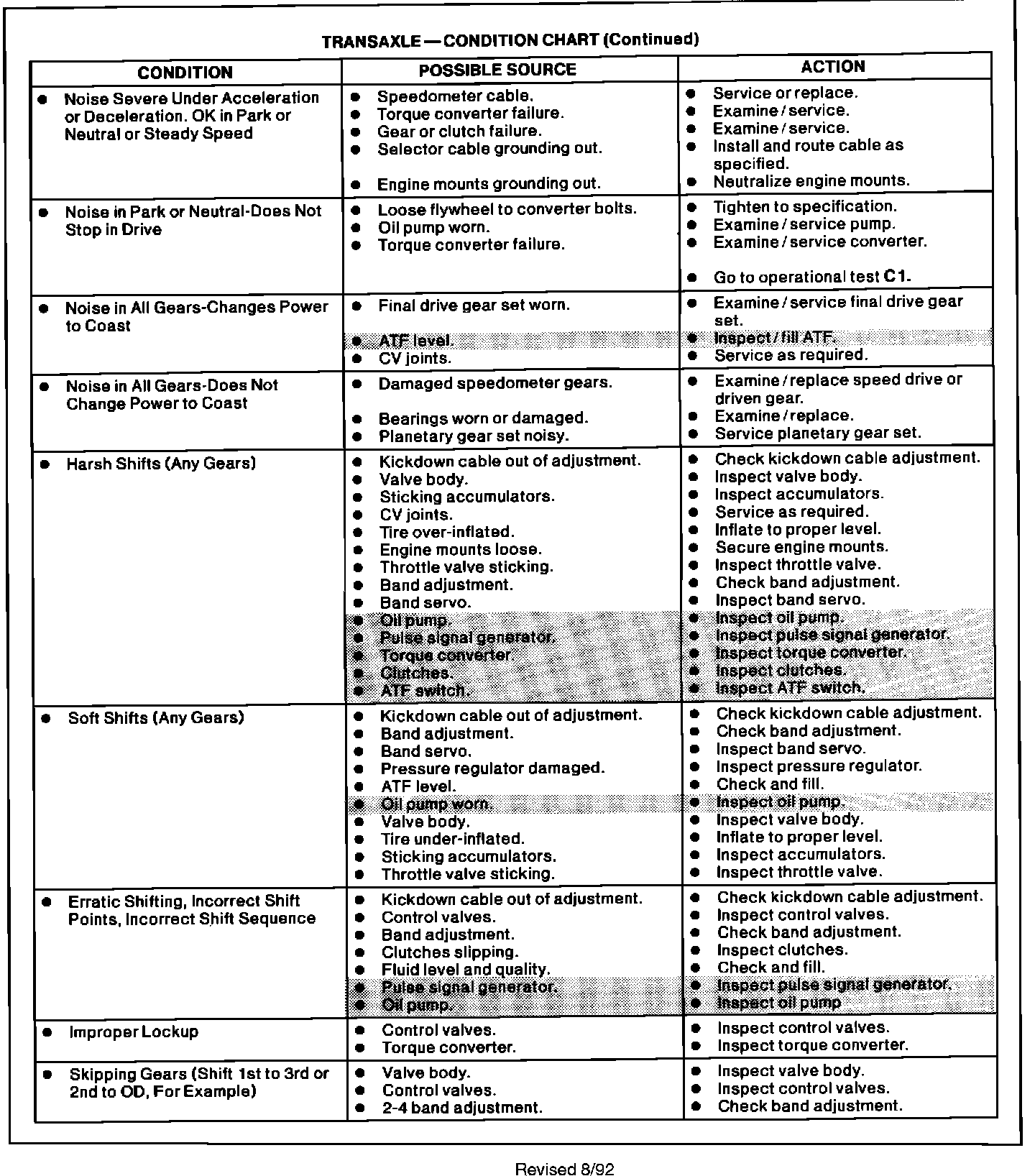

ISSUE:

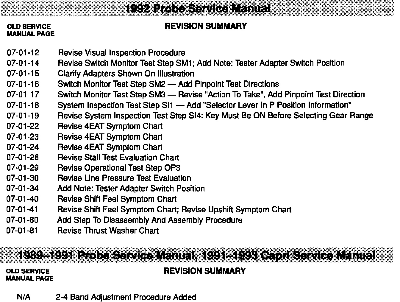

The 1992 Capri, 1992 and 1993 Escort/Tracer, and 1992 Probe Service Manuals contain 4EAT diagnostic information which requires revision. The following pages are affected:
^ 1992 Capri Service Manual: Pages 07-01-9 through 11, 14, 15, 17 and 18, 20, 21, 25 and 26
^ 1992 Escort/Tracer Service Manual:
Pages 07-01-2 through 4, 9, 11, 13 through 15, 17 through 20, 22 and 23, 31, 36 and 37, 41, 44, 46, 47 and 63
^ 1993 Escort/Tracer Service Manual:
Pages 07-01-107 and 108
^ 1992 Probe Service Manual: 07-01-12, 14 through 19, 22 through 24, 26, 29 and 30, 34, 40, 41, 80 and 81

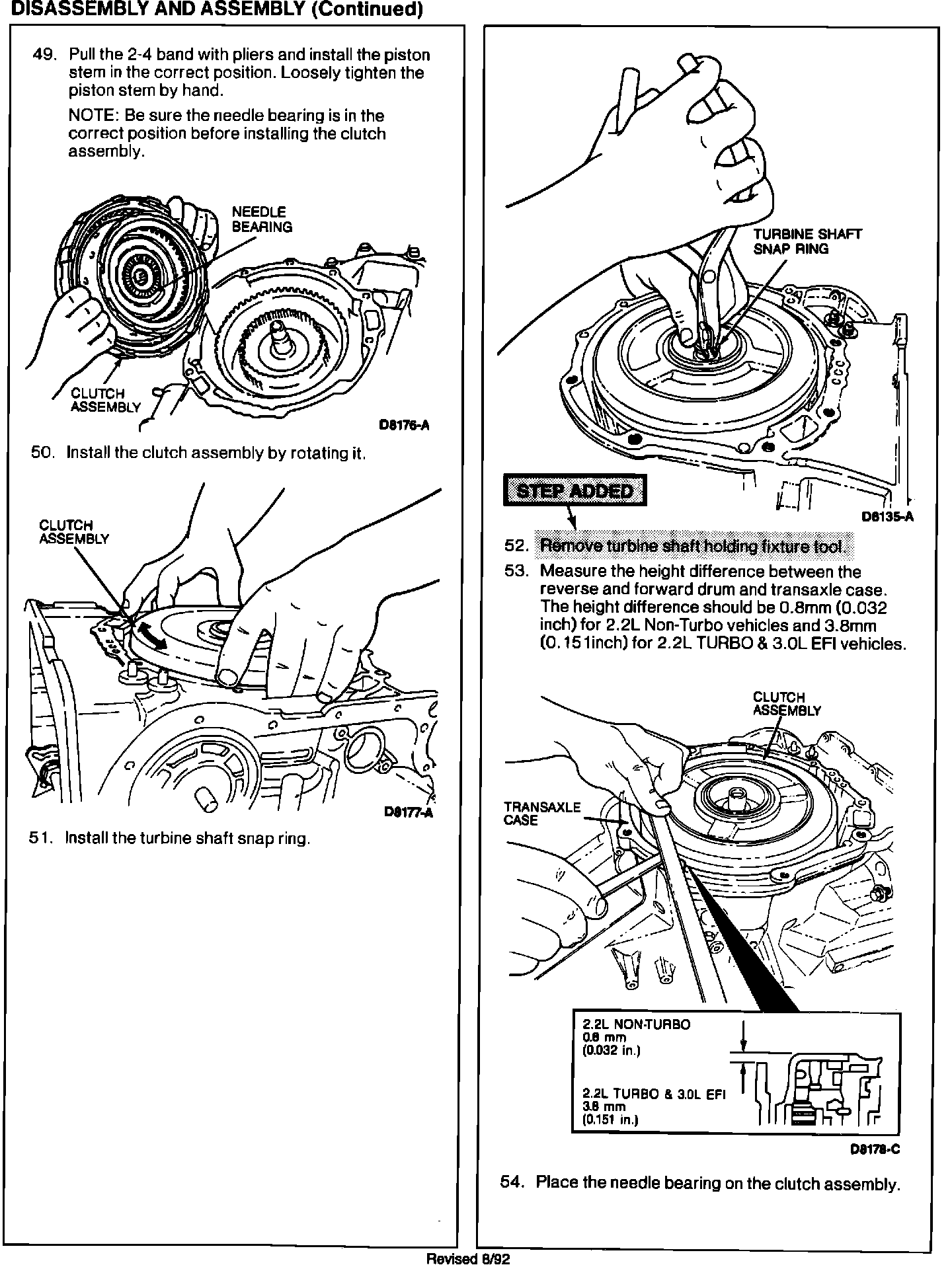

Also, the 1989-1991 Probe and 1991-1993 Capri Service Manuals are missing the 2-4 Band Adjustment Procedure. This procedure should be added to Automatic Transaxle, Adjustments.
ACTION:
Refer to the pages for the revised and additional information.
NOTE:
THE FOLLOWING CURRENT AND UPDATED INFORMATION MAY NOT NECESSARILY APPEAR ON THE CORRESPONDING SERVICE MANUAL PAGES. REFER TO THE ISSUE OF THIS TSB ARTICLE FOR THE LIST OF SERVICE MANUAL PAGES ACTUALLY AFFECTED.

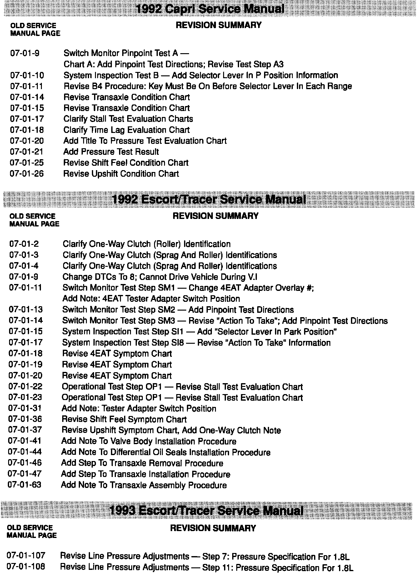

92-18A-16 Revision Summary
Page 07-01-8
Page 07-01-9 1992 Capri
Page 07-01-10
Page 07-01-12
Page 07-01-13 1992 Capri
Page 07-01-14 1992 Capri
Page 07-01-15
Page 07-01-16
Page 07-01-17 1992 Capri
Page 07-01-18 1992 Capri
Page 07-01-19 1992 Capri
Page 07-01-20
Page 07-01-22 1992 Capri
Page 07-01-23
Page 07-01-24
Page 07-01-2
Page 07-01-3
Page 07-01-4
Page 07-01-9 1992 Escort/Tracer
Page 07-01-11
Page 07-01-13 1992 Escort/Tracer
Page 07-01-14 1992 Escort/Tracer
Page 07-01-17 1992 Escort/Tracer
Page 07-01-18 1992 Escort/Tracer
Page 07-01-19 1992 Escort/Tracer
Page 07-01-21
Page 07-01-22 1992 Escort/Tracer
Page 07-01-30
Page 07-01-34
Page 07-01-35
Page 07-01-36
Page 07-01-40
Page 07-01-43
Page 07-01-45
Page 07-01-46
Page 07-01-62
Page 07-01-106
Page 07-01-107
Page 07-01-12 1992 Probe
Page 07-01-14 1992 Probe
Page 07-01-15 1992 Probe
Page 07-01-16 1992 Probe
Page 07-01-17 1992 Probe
Page 07-01-19 1992 Probe
Page 07-01-22 1992 Probe
Page 07-01-23 1992 Probe
Page 07-01-24 1992 Probe
Page 07-01-26
Page 07-01-29
Page 07-01-30 1992 Probe
Page 07-01-34 1992 Probe
Page 07-01-39
Page 07-01-40 1992 Probe
Page 07-01-78
Page 07-01-79
Page 07-01-43 1989-1991 Probe, 1991-1993 Capri
