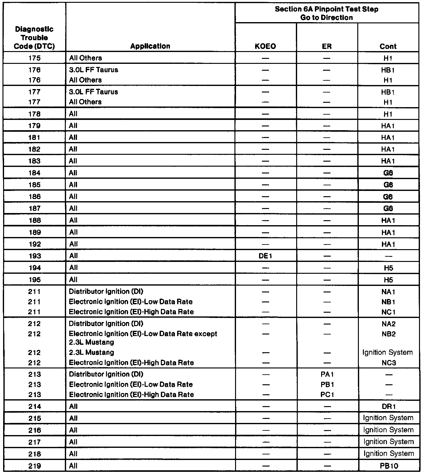

175-219 Updated By TSB:

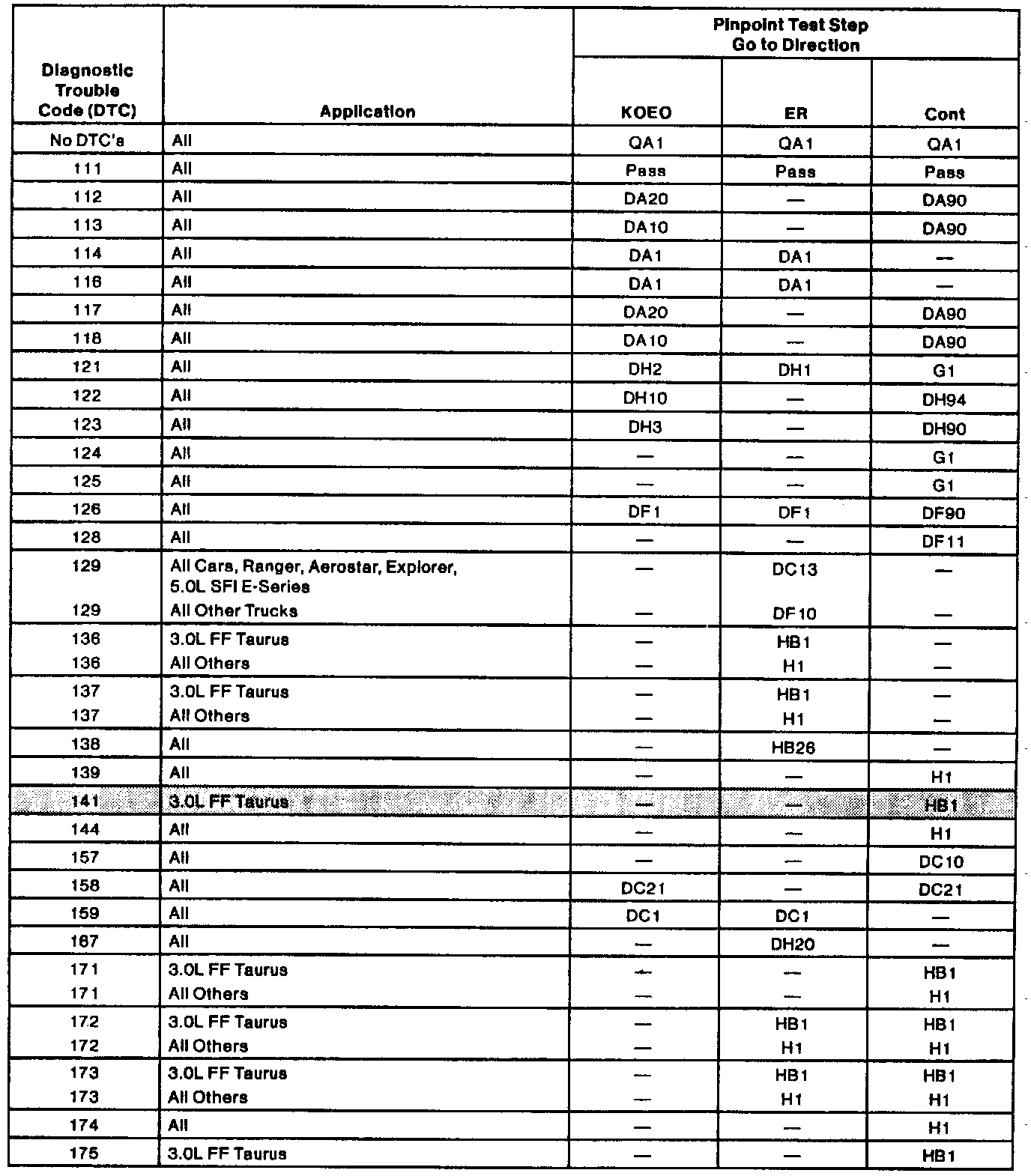

111-175 Updated By TSB:

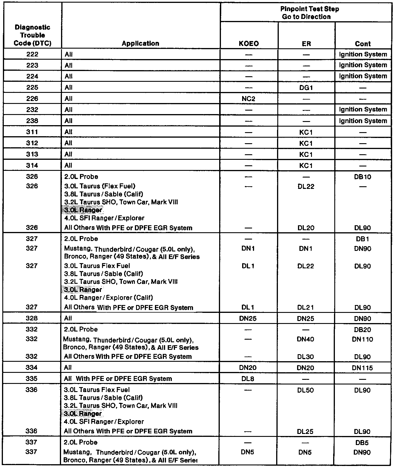

222-337 Updated By TSB:

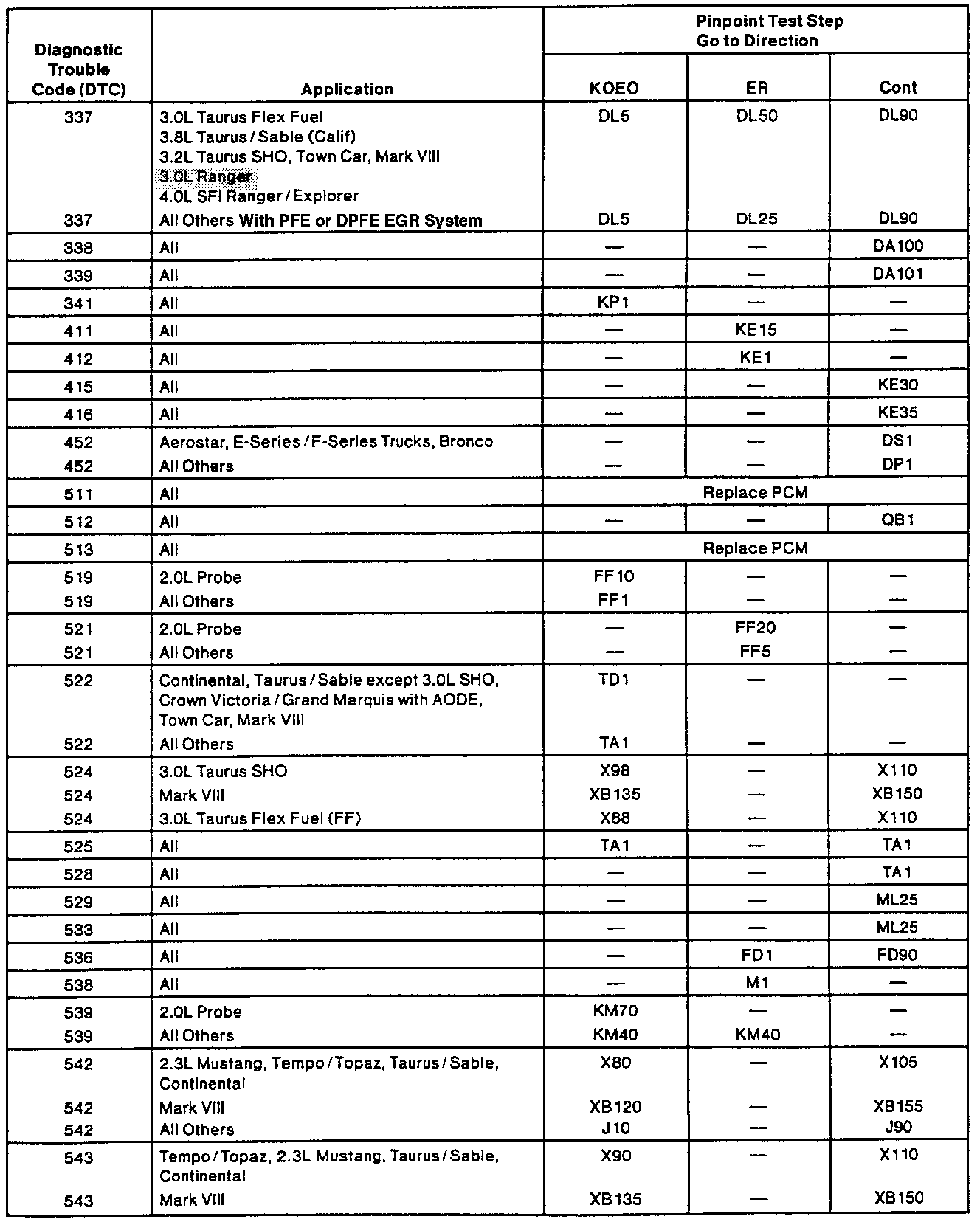

337-543 Updated By TSB:

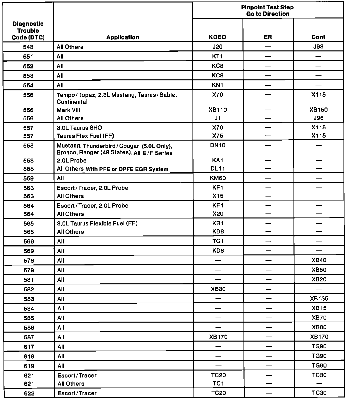

543-622 Updated By TSB:

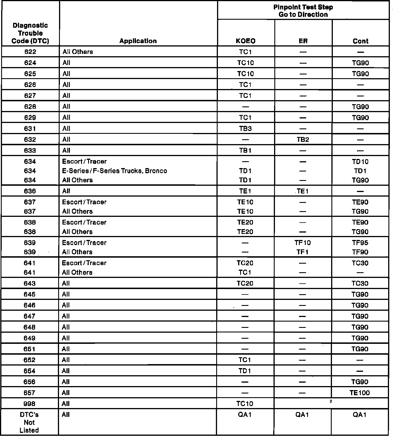

622-998 Updated By TSB:
