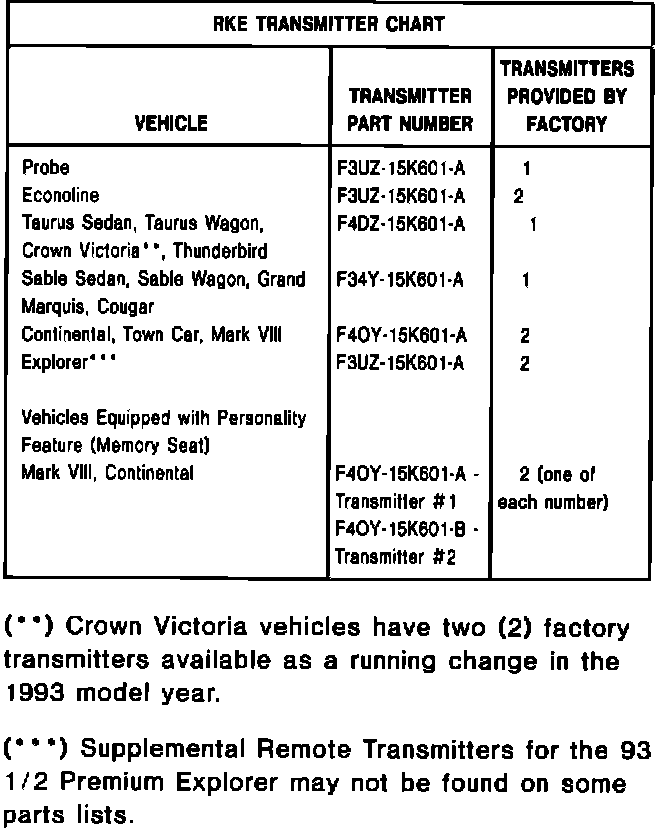

ORDERING ADDITIONAL RKE TRANSMITTERS
When any additional transmitter(s) are purchased for a vehicle, the cost of the transmitter(s) and any costs associated with programming the transmitters to the vehicle are not warranty chargeable.

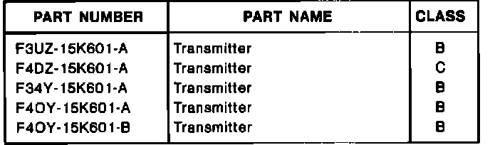

The RKE Transmitter Chart lists the part numbers of all factory-installed RKE transmitters and the number of transmitters. Refer to this chart for the correct part number. Please note that transmitters are handled through normal stock orders, not via special order programs.

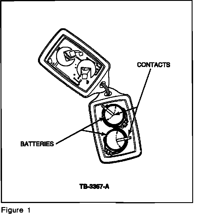

RKE TRANSMITTER BATTERY REPLACEMENT

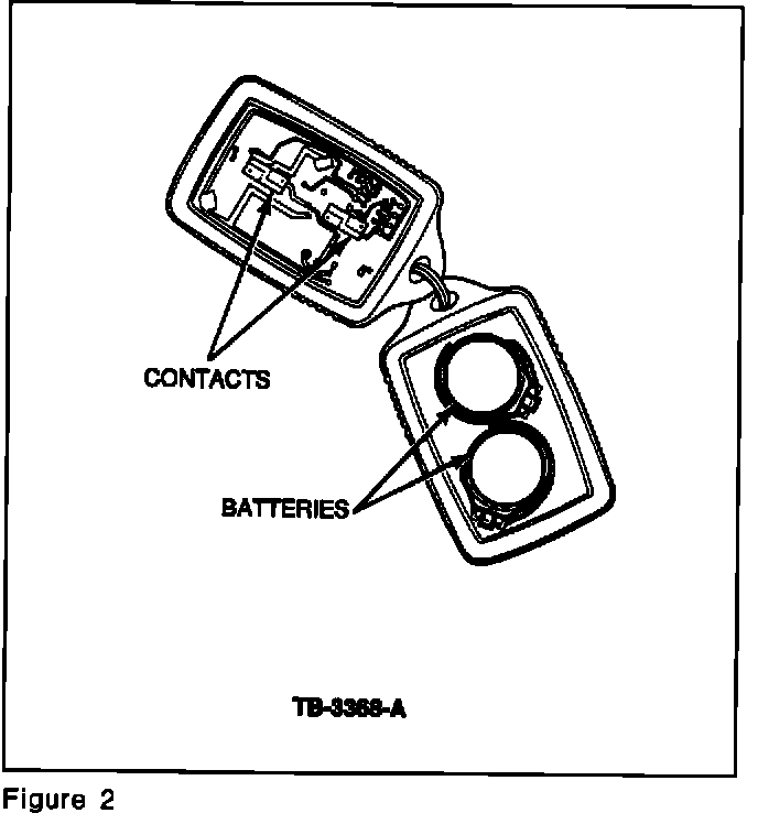

In 1993 a change was made to the Remote Transmitter for the RKE system. The battery contacts have been reengineered. It is important that you are able to identify the differences for battery removal and replacement. The following outlines the procedure for both types of transmitters and how to identify them.
The differences in the two (2) are shown in Figures 1 and 2. To remove the battery, determine what type of transmitter you have and refer to the following appropriate procedure.
"SWING ARM" CONTACTS - (Figure 1)
1. Snap apart the transmitter case by twisting a coin between the edges of the front and rear halves.
2. Carefully swing the contacts off the batteries and remove the discharged batteries.
3. Install the new batteries.
NOTE:
BATTERIES MUST BE INSTALLED WITH THE POSITIVE SIDE TOWARD THE BOTTOM OF THE TRANSMITTER CASE.
4. Swing the contacts over the top of the batteries.
5. Snap the two halves of the transmitter case back together.
"CIRCUIT BOARD" CONTACTS - (Figure 2)
2. Remove the discharged batteries.
NOTE:
4. Snap the two halves of the transmitter case back together.
Replacement batteries for the Remote Transmitters are not available through FCSD, but can be obtained at most local stores that sell photo, calculator and/or watch batteries. The transmitters use a battery industry standard No. 2016 - 3 volt. The alternative battery manufactured sources are Duracell # CR2016; Radio Shack # CR2016H or # BR2016H; and Sony # CR2016.

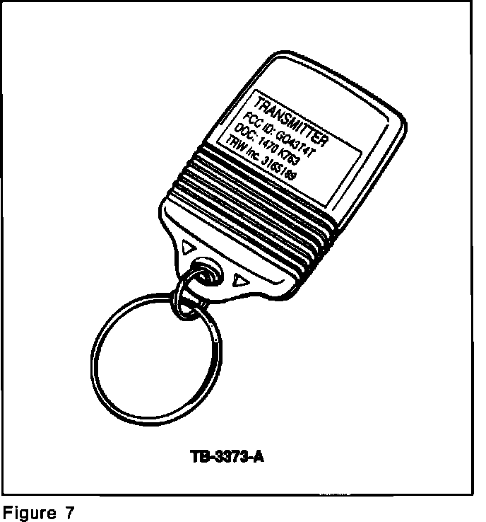

^ The two factory supplied transmitters are numbered on the back to identify the transmitters ("Transmitter 1" and "Transmitter 2"), Figure 7. The transmitter number corresponds to the memory seat position (i.e. transmitter 1 is for seat position 1, transmitter 2 is for seat position 2, and a third transmitter can be used for seat position 3).
^ When setting the seat position, be sure that the memory seat position number is programmed to the corresponding transmitter number.
NOTE:
IF TRANSMITTERS MUST BE REPROGRAMMED, THE FIRST TRANSMITTERS REPROGRAMMED WILL BECOME # 1, THE SECOND PROGRAMMED WILL BECOME # 2, ETC., REGARDLESS OF THE NUMBER ON THE BACK OF THE TRANSMITTER.

OBTAINING FACTORY INSTALLED REPLACEMENT TRANSMITTERS (WITH PERSONALITY FEATURE)
Replacement transmitters (also used as additional transmitters) with personality features come with the # 1 and # 2 identified on the back (F40Y-15K601-A and F40Y-15K601-B, respectively). Transmitters with personality feature cannot be ordered with # 3 and # 4 on the back of the transmitter (or as a generic "no number" unit).

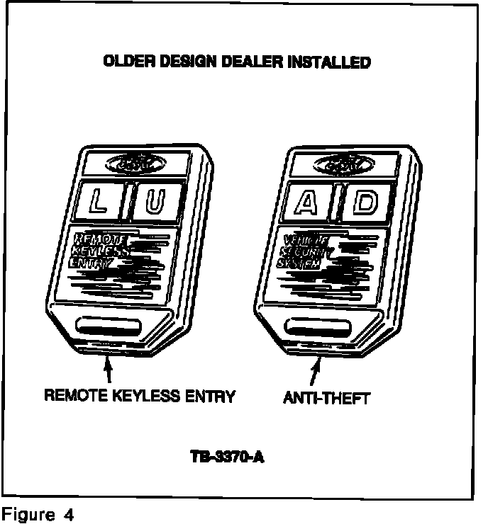

FACTORY VERSUS DEALER INSTALLED RKE SYSTEMS

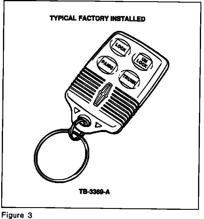

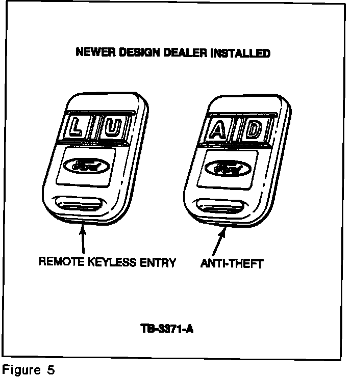

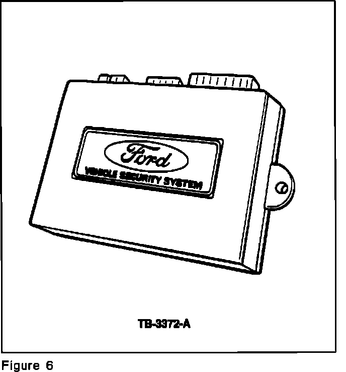

Ford factory installed systems are designed specifically for the vehicle that they are installed into, Figure 3. FCSD supplies a dealer installed RKE system that can be installed on all Ford and Lincoln/Mercury vehicles, Figures 4, 5, 6. This system is maintained by FCSD. Warranty data and material should be directed to the proper area when repairs warrant replacement.
