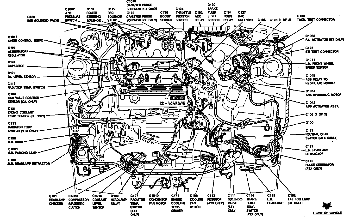

Engine Compartment Component Location.:
LH Rear Of Engine Compartment, Below Relay Box
Applicable to: 2.2L/4-133

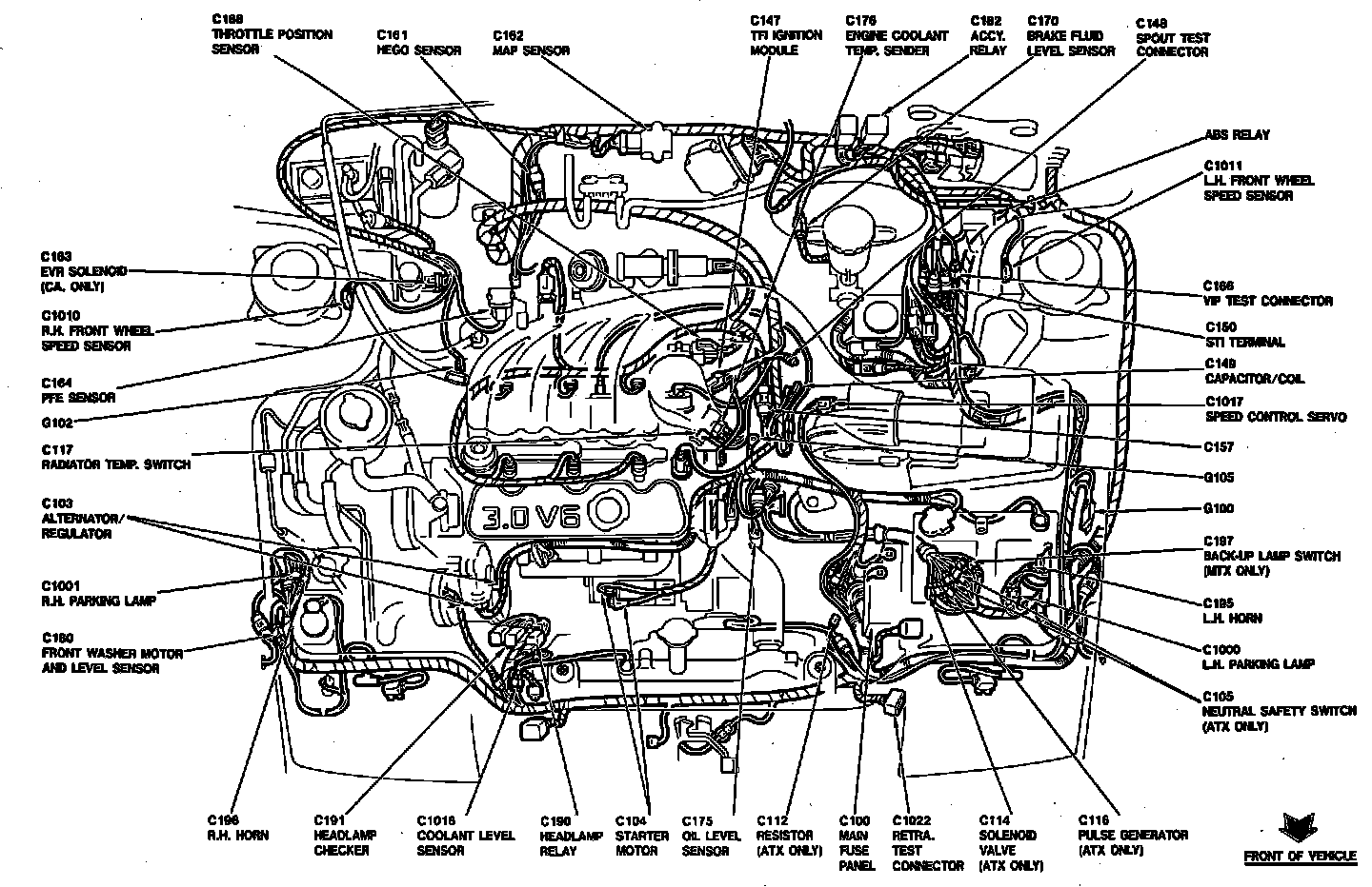

Engine Compartment Component Locations.:
Applicable to: 3.0L/V6-182
