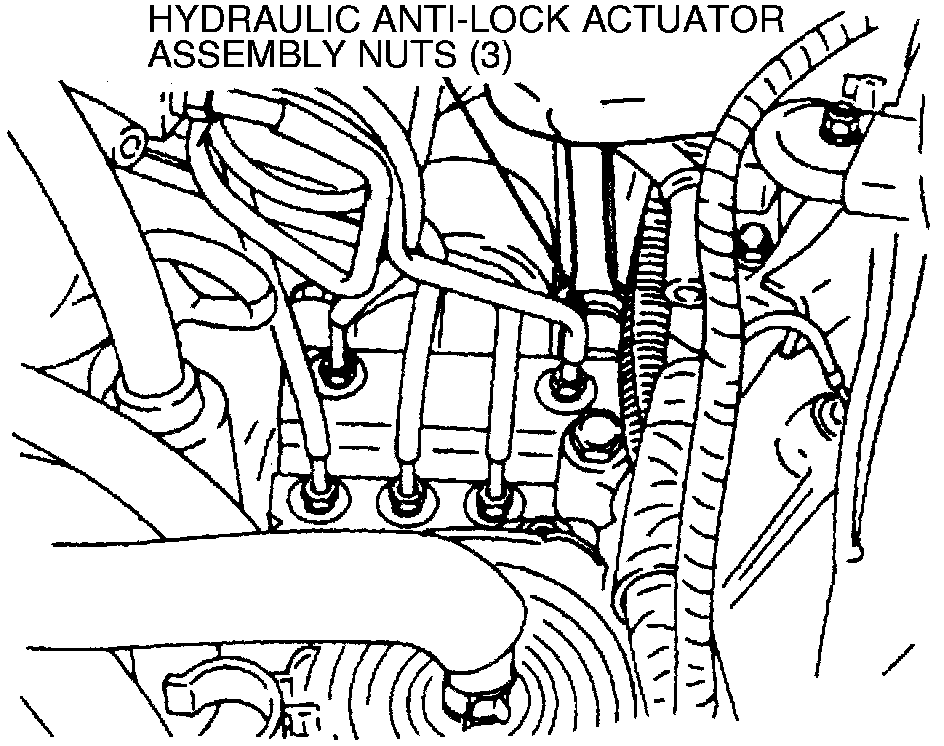

Fig. 24 Hydraulic Anti-Lock Actuator Assembly Nut Loosening:
4. Disconnect hydraulic anti-lock actuator assembly electrical connectors, then loosen three nuts.
5. Remove front left brake line bolt, then use tubing wrench to remove brake line fittings from actuator assembly. Note brake line routings to ensure proper installation.
6. Remove actuator assembly nuts and washers, then the actuator assembly.
