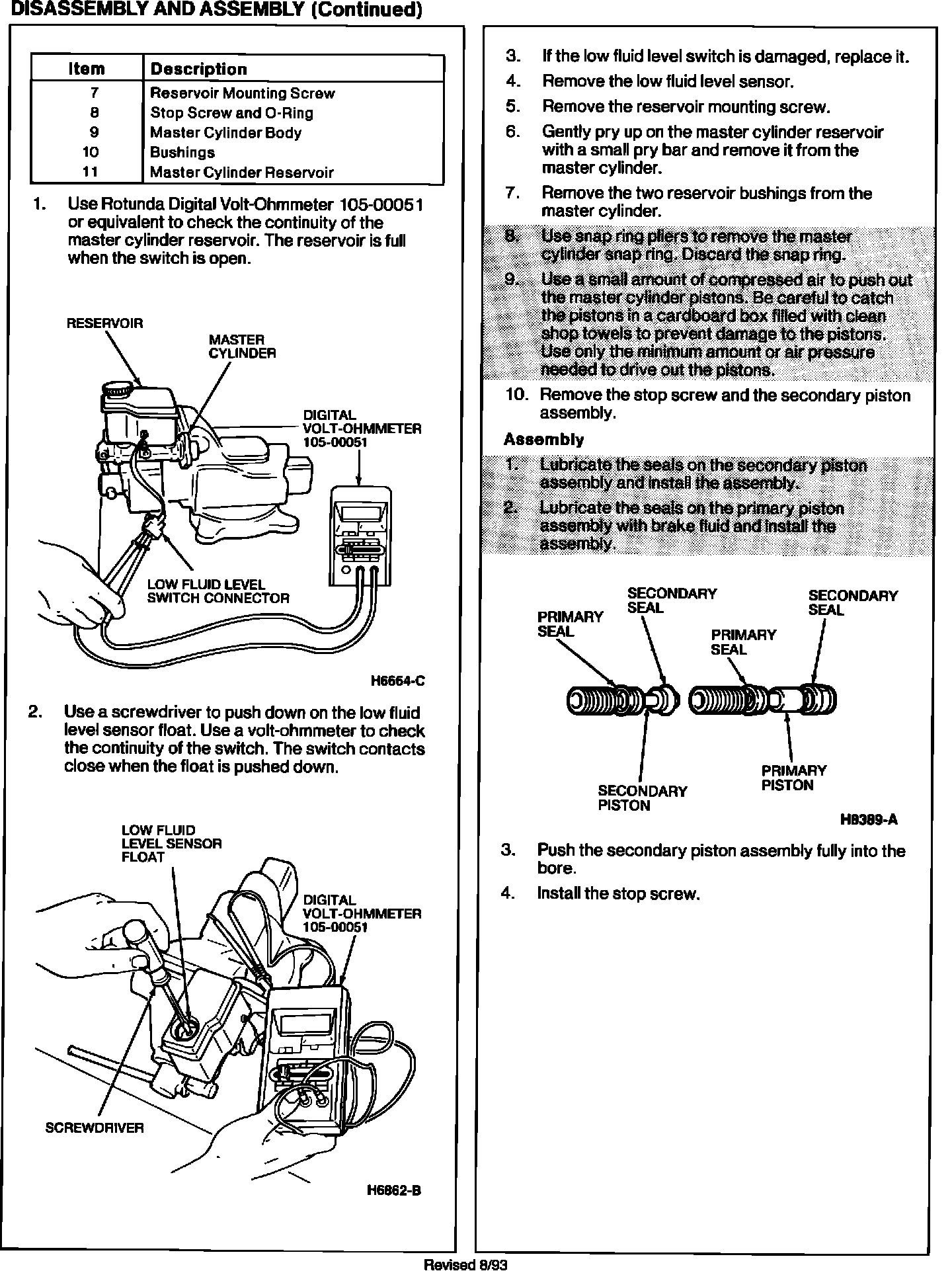

SERVICE MANUAL - 1993 - PAGE 06-06-16 - MASTER CYLINDER DISASSEMBLY/ASSEMBLY PROCEDURES REVISED
FORD:
1993 PROBE
ISSUE:
Master Cylinder disassembly and assembly procedures require revision. Page 06-06-16 of the 1993 Probe Service Manual is affected.
ACTION:
Refer to the page in this TSB article for the revised information.
