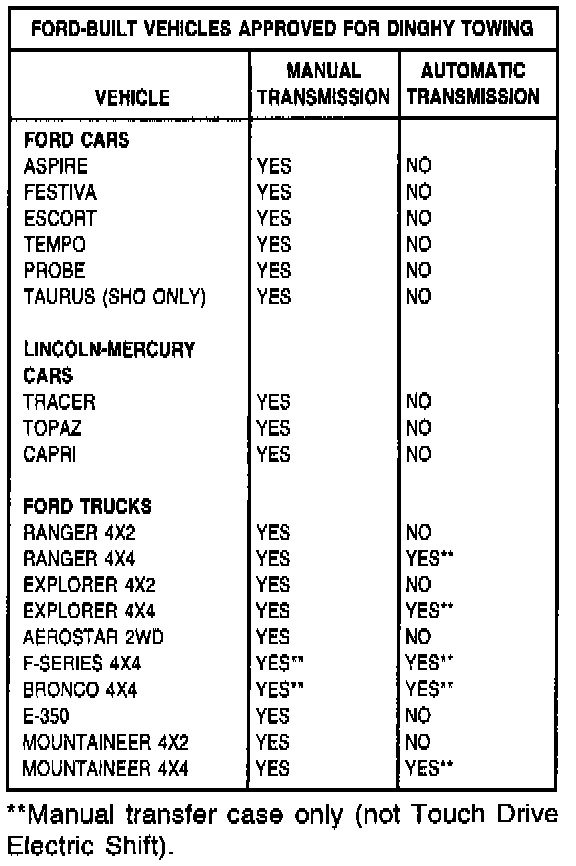

3. Tow Bar-towed - Vehicles which can be successfully towed with a tow bar are listed in the following chart. Additional vehicle-specific information follows the chart.

MTX-EQUIPPED VEHICLES
Towing a manual transaxle (MTX)-equipped vehicle with the drive wheels on the ground is acceptable only if the vehicle is towed in a forward direction. The parking brake must be released and the gear shift lever must be in Neutral.
^ For Aspire, Festiva, Escort and Tracer, the ignition key must be in the ACO position, the battery must be disconnected to eliminate battery drain, and the steering wheel must be unlocked
^ For Capri, the ignition key must be in the OFF position and the steering wheel unlocked
^ Refer to the specific vehicle Owner Guide for complete details

TRUCKS
^ The steering wheel must be unlocked by placing the ignition key in the OFF position
^ Manual transmission shift lever must be in Neutral
^ On 4X4 manual shift transfer cases, the shift lever must be in Neutral
^ 4X4 locking hubs (both manual and automatic) must be unlocked
