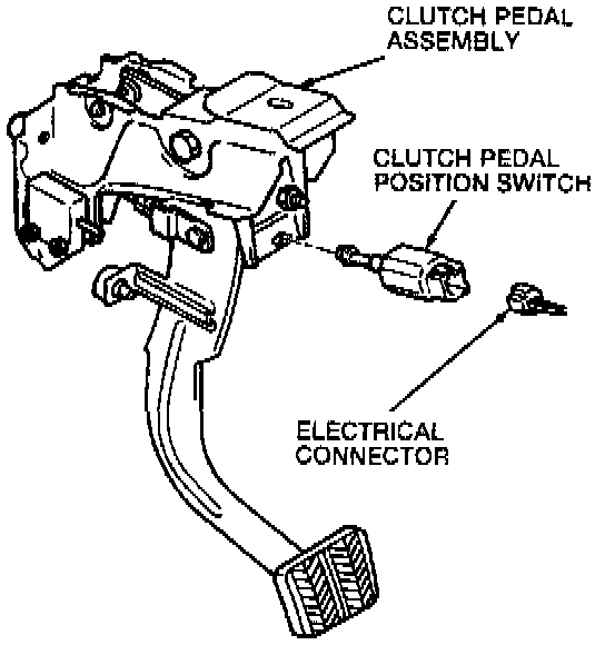

Fig. 109 Clutch Pedal Position Switch Replacement:
2. Disconnect electrical connector from back of switch, Fig. 109.
3. Rotate switch 90 degrees in either direction and remove it from mounting bracket.
4. Reverse procedure to install.
