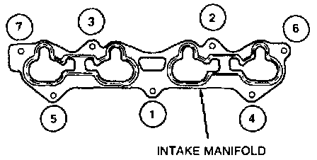

Intake Manifold Tightening Sequence:
17. Reverse procedure to install. Torque bolts and nuts in sequence to 14-19 ft lb.
