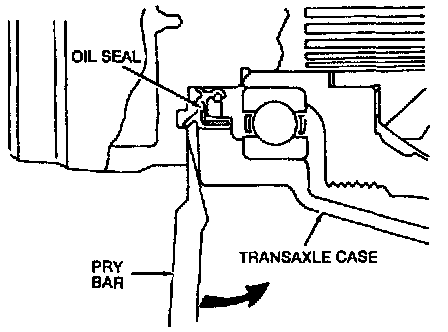

f. Using an angled pry bar or equivalent, remove lefthand halfshaft by prying between the constant velocity joint outer race and transaxle housing. Carefully tap pry bar end to unseat circlip on side gear end of halfshaft.
