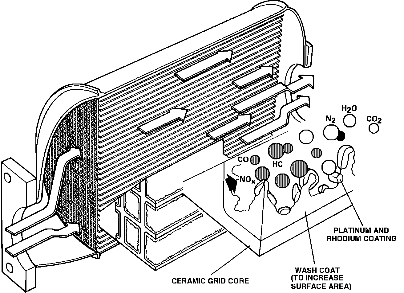

CONSTRUCTION
Catalytic converters consist of a metal housing, a ceramic grid substrate, and a catalytic coating of platinum and rhodium. Active metal content is about 2 grams of platinum/rhodium.
OPERATION
As exhaust gas containing HC and CO passes through the converter, the platinum catalyst starts an oxidation (burning) process. HC and CO then unite with oxygen to form water vapor and carbon dioxide. This oxidation process has no effect on NOx emissions.
To reduce NOx, a separate reduction reaction is necessary. A reduction reaction is the removal of oxygen from a material. In three-way converters, rhodium is used as a catalyst to break down NOx into nitrogen and oxygen. The effective conversion of pollutants begins at about 250°C (480°F).
